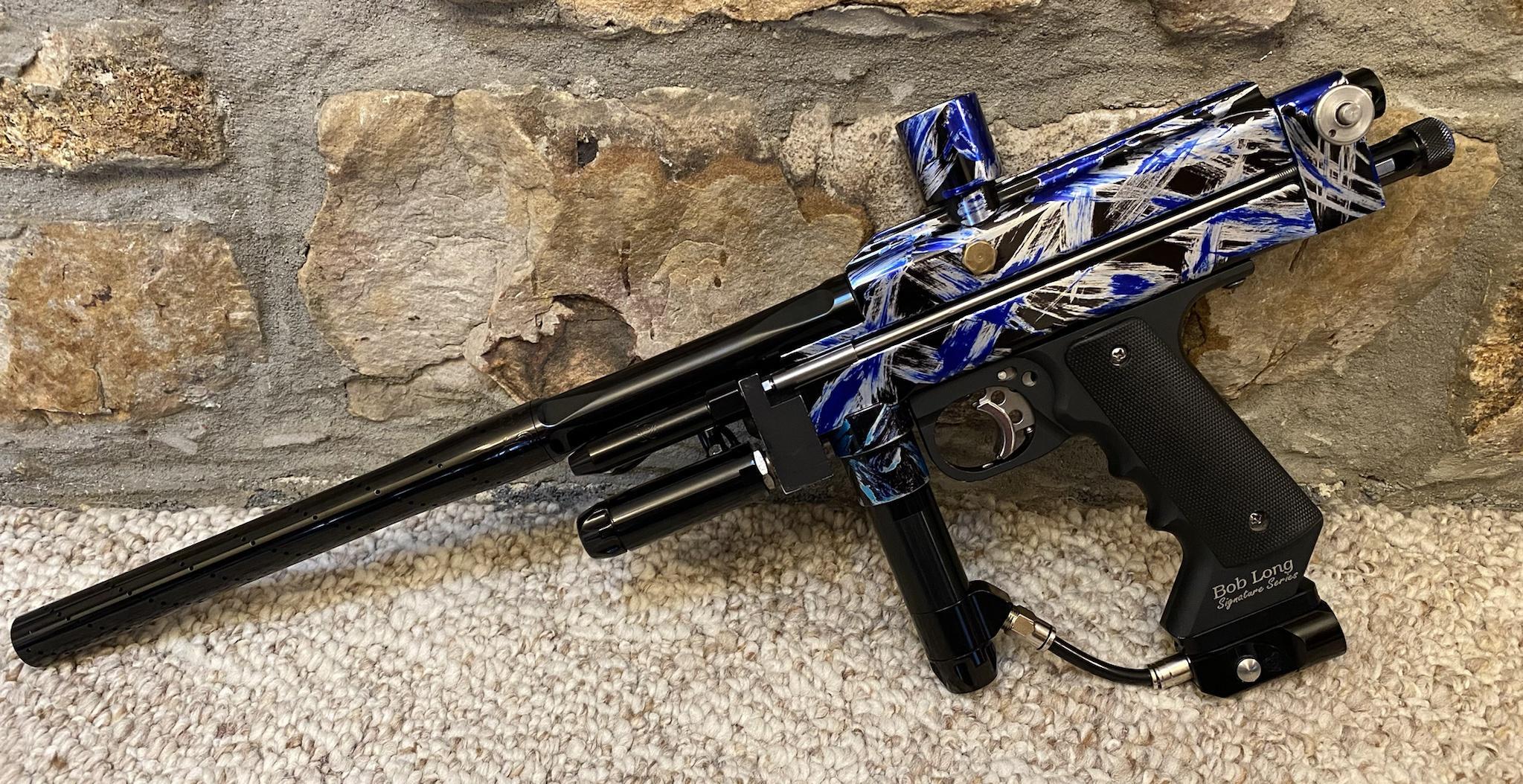

                    The AKA plate arrived today. I'm still waiting for the roller sear to arrive. However, I was able to get the plate polished and installed this afternoon. When the plate arrived, it was a bit sticky with some residue on it. Based on the discoloration of the plastic bag it came in, I assume it must have been a grease or oil to prevent corrosion. I was able to remove this sticky film with a little rubbing alcohol. Once that was done, I didn't see or feel any mill marks on any of the friction surfaces, so I skipped the sanding and went right into polishing on the wheel with some red compound followed by some light hand polishing with a cloth. Even without the roller sear installed yet, I can tell already that the trigger pull is greatly improved with no side to side slop and a nice crisp pull. The only sacrifice I had to make with this plate was that I had to remove the safety I just recently installed since there isn't any way to insert one with this design. No big loss though. Since you can't see the roller sear anyway, I figured I'd post a final photo of this build. I'm loving how this thing turned out.

                      Looks amazing. I'm glad it turned out well for you! I sent a message to Jared at AKA about the thickness of these plates and his response was "trigger plates are measuring .163 wide."
