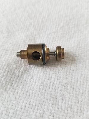

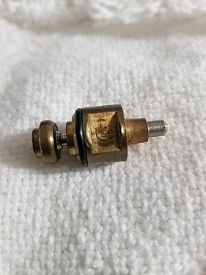

                I have an old valve and some internals.

                  • 3514
                  Got a picture of the bottom of the valve? Looks like a Rat valve from here, I think they're better used with a reg.

                    • 550
                    The orifice is smaller than a stock valve. I believe it to be a Palmer's HP valve.

                      • 3514
                      That's an original BBT Rat valve... I've got one in my parts box. PPS actually made the valve stems for BBT (which later became Shocktech from my understanding).
                      I'm not sure how well they do, unregged.
                      I don't know if you've seen an early valve but the orifice is tiny in them, much smaller than that Rat you have there.

                        • 6380
                        I run a palmers HP valve in my Scout it works well. Needed a heavy hammer spring and light valve spring to counter unregulated pressure on the valve.
                        Stock Class CCM gets more shots then my unregulated Scout. I can get exactly 30 shots as long as it’s warm on the CCM (25) with the Scout but it needs more tuning and a stiffer hammer spring I think. I got the stiffest mad man Hammer spring in it and it’s not enough.
