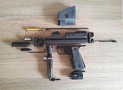

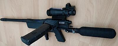

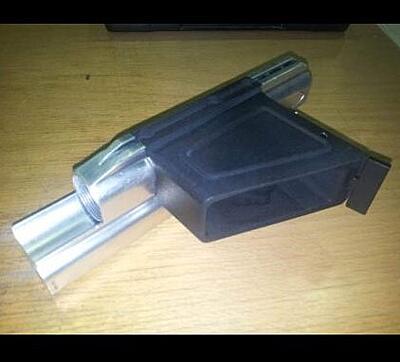

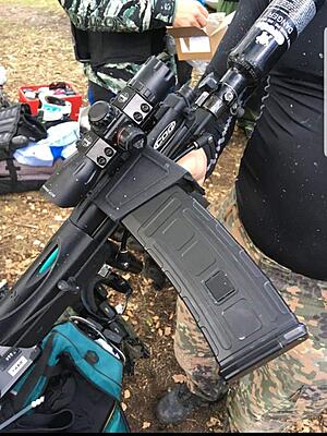

              Maybe this is interesting for you...
              This gallery has 4 photos.
              • stealthfox1
                • 16
                • Germany
                Yes FS can be used

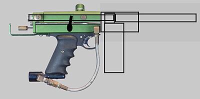

                  what do you think about a mini body... instead of attaching a front block, make a “mag well/pup piece” that fits up front. Move the barrel forward.... feed the air directly into the bottom tube.... longer bolt...
                  I don’t do much cad but I’ll try and do a quick hand sketch

                    I warned you about my art skills...

                      Originally posted by stealthfox1
                      Yes FS can be used
                      I like it, just don't have the resources to do something like this, as I basically only have hand tools and a drill press.
                      For a bolt, I was thinking just using an oversized bolt pin to grab. Check out the video in the OP to see the system I'm looking to use.
                      My main concern right not is finding a body that will let me plug it most easily, while still getting the features I'm looking for.

                        Yeah so I kinda blew past the video and missed the mention of ADN.... would be pretty simple to do what’s in the vid but would have to take a serious look at the mag part. With the basic tools, it’s hard to do the more complicated stuff.....for a guy with some cnc skills this could probably be something.
                        I built an air gun a few years ago which kinda resembles the one in the video but never thought to look at paintball guns. The autococker bottom tube is exactly how I need to finish it.

                          the bolt will not clear the breach. you also have to put the feed forward if this should work

                            I get what you’re saying.... kinda. Can you not change the length of the cocking rod to accommodate? still learning. If there’s a will, there’s a way. Always comes down to how much time and money a guy wants to throw at it. And if it’s a one of a kind or some kind of kit
