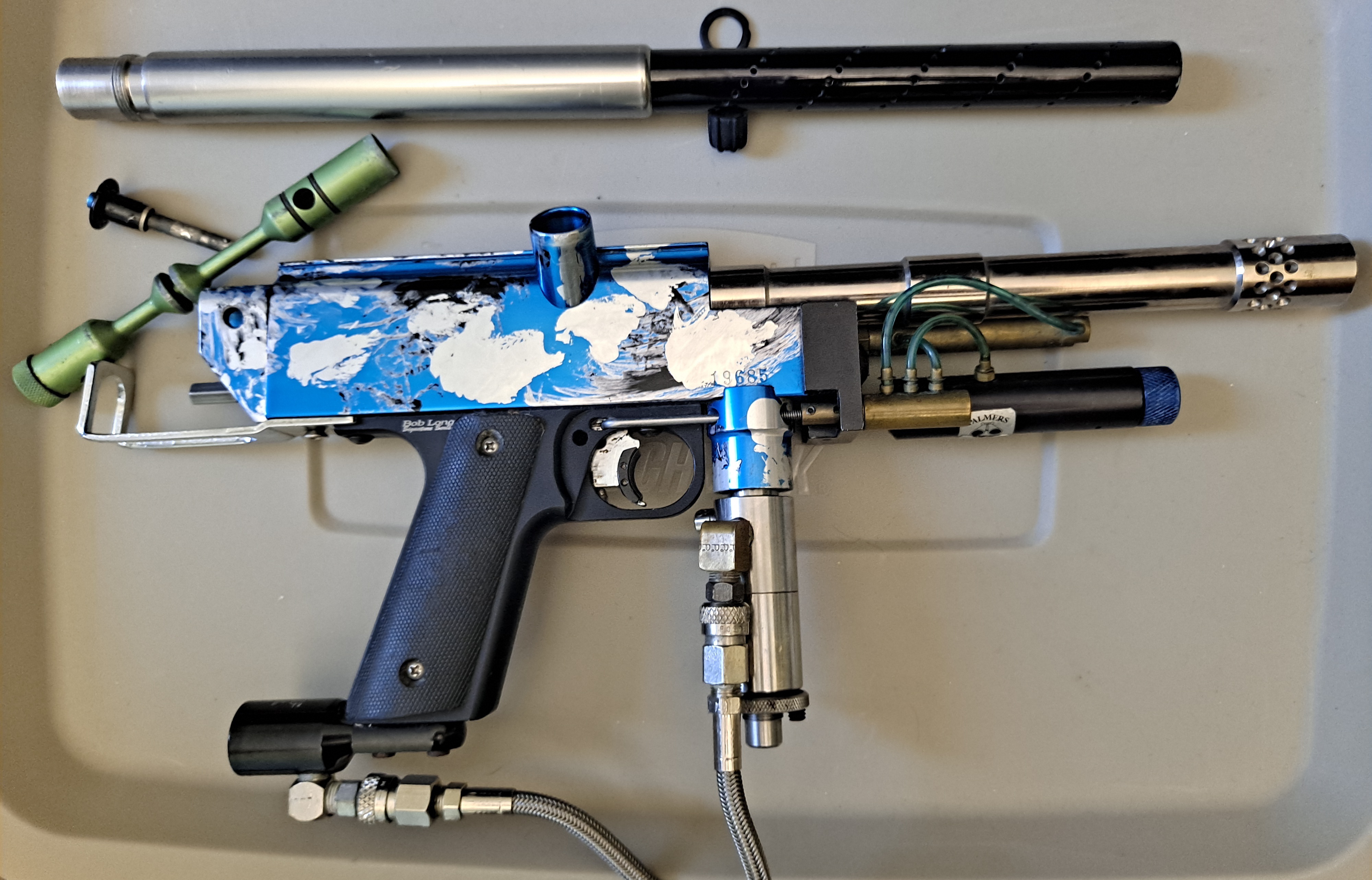

    Just scooped this beaut up. 19NNN serial number, clean.
    Question for the experts - what on here clearly ISNT original & which barrel is original if either one?
    I believe brass/palmers is legit, frame obviously, and they surely didn't change block if they didn't change pneus.... thinking about bolt, barrel, reg in particular. I'm guessing the AA barrel may be the orig.
    Also anyone recognize the barrel currently mounted? It's not SS, kind of has a lapco/PMI vibe to it

    All of the parts are within the period for sure. Usually the Bob Long Signature cockers came with a Bob Long Long Shot barrel. The pneumatics were always stock, so the Rock is an upgrade. Also seems to be missing the matching shroud, which was standard for these.
    Freak bore the AA and run it as is. Nice piece.
    EDIT: Wanted to add, that the bolt is not original, they had Bob Long Cyclone bolts. Also I don't think they came with a reg, but that early Unireg is perfect.
    Velcor will save us...
      • 4331
      For that era......
      You're missing the match annoed shroud, there should be an expansion chamber not a reg.....and technically the bolt is wrong.
      The taso power barrel isn't stock, but also not wrong because bob did use those
