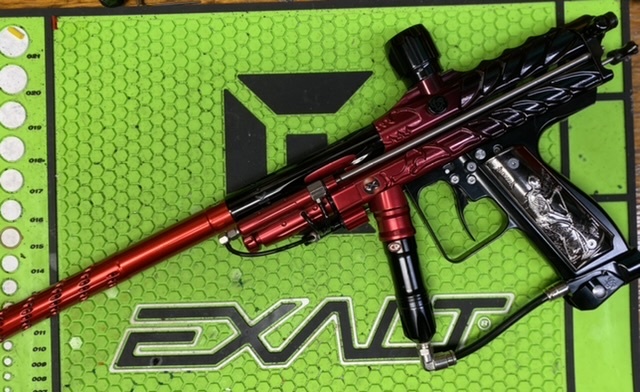

      I've built dozens of guns, including my dream gun, and I've used just about every part along the way. To me, what parts I use really comes down to the design objective.
      I usually prioritize brand continuity for a build. I'll try to stick to 2, maybe 3, brands of parts across the whole gun. Belsales and AKA, for example. Or Hybrid and Macdev. The only time I've ever really done a mix and match was with my Trilogy, and only because there's really limited options. I really like the Alien Morph valve, and I really like the Niche 86* slider. But I can't really do a build with full brand continuity around those two parts because, simply put, they don't exist.
      If I'm doing a really high-end build, I'd do all Belsales or 2k+ WGP stuff. STO 3way and ram, Outkast LPR. They're the most foolproof and frankly they hang with everything else performance wise. The real truth is that 99% of people wouldn't notice the difference when shooting. But anyway, Shocktech stuff has always been underwhelming in my experience, same with Palmers and CCM.
      For frames, I really like the Niche frame as mentioned, follwoed by the KAPP groovy frame or the later DYE frames.
      But the reality is, a full ID build will beat out literally anything else. They're a little blase to me, though. A full belsales gun has more prestige, if that makes sense. If I'm building a dream gun, it has to have the wow factor, a sort of gun version of "I'm better than you." And ID doesn't have that.

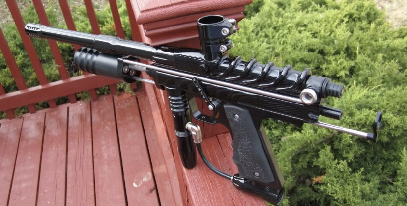

        My dream build:

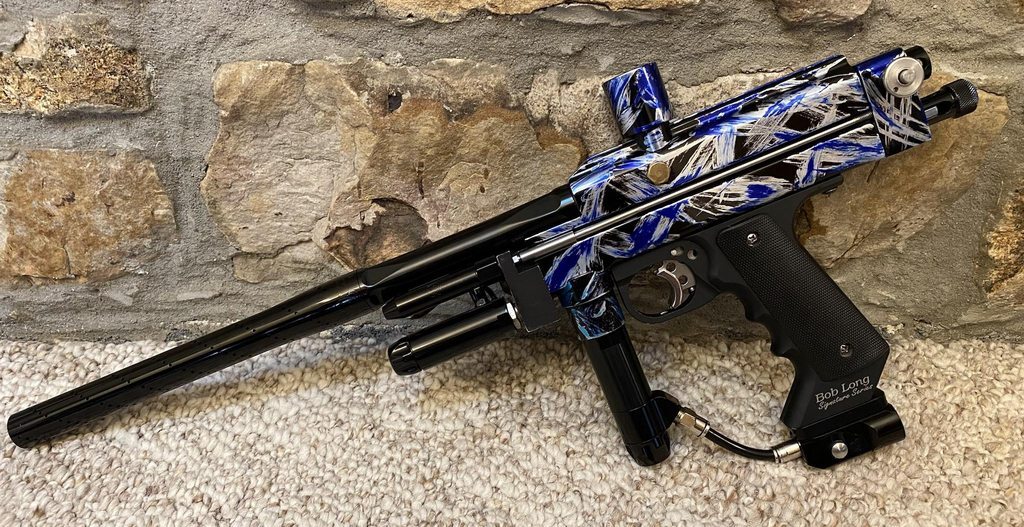

            My thoughts exactly. If you're going for a more cohesive look, sticking with parts from a single manufacturer are more likely to have matching anodizing, milling, and overall style than mixing & matching would. For example, I went down this road when I rebuilt my old Bob Long Autococker using primarily ID components. Then again, some people like a piecemeal aesthetic on their Autocockers.

                Drop Top Center feed BPS Ripper. Shock tech pneumatics Gunfighter frame, AKA 2L+ reg, Bob Long cam drive ASA. All color matched in a Caustic high gloss finish.
                But honestly I rather have it as a pump. All CCM’d out 86* with the aluminum finger grove panels and an EZ grip out the front.
                Basically this with my own preferences.
