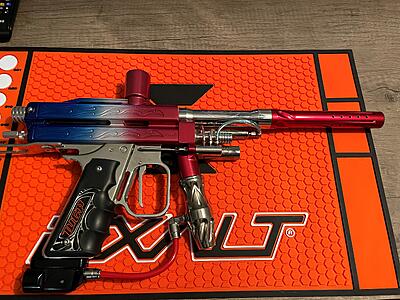

    When I was a teenager in the early 2000's, the Black Magic was my ultimate dream gun. I was never able to save up enough for one, then took a 10+ year break. I got back in to it early this year, and had been searching endlessly to find one in decent shape, undrilled, in a color I liked.
    Finally, I was the lucky bidder on E-bay. Shes in pretty good shape, but definitely has signs of aging.

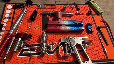

    I've disassembled, and plan to do a deep clean. I picked up some new parts - Shocktech pneumatics, Superfly bolt, lower tube parts, and the Gunfighter frame. I will post progress here, with an aim to get this old girl running like a dream by the spring!
    Let me know if you have any advice for rebuilds, or post your own here!

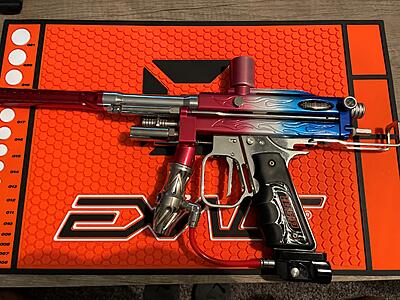

                I have been working on it in short spurts daily. So far, here is my feedback:
                The Shocktech front end LPR does NOT fit into the front block on the mini Black Magic (Maybe it would on a full size?). Seems to be a commonish problem.
                The new Bomb2 3-way is not adjustible from the front. It is the old school style where you adjust from the coupling on the actuator rod. I read on some forums that it was in fact adjustable from the front, but I suppose this is my error in research.
                Common problem I read is being able to screw/unscrew the damn pump arm on and off of the ram shaft. Well, I learned that if you unscrew the casing off of the ram, the front end of the Shocktech ram shaft itself has a fitting for an allan wrench to sit in. Using an allan key on both sides makes it SO much easier to appropriately adjust!
                Overall, the project is coming along very nicely! I will eventually return with the full, finished product in the coming weeks. Will follow with a shooting video in the spring!

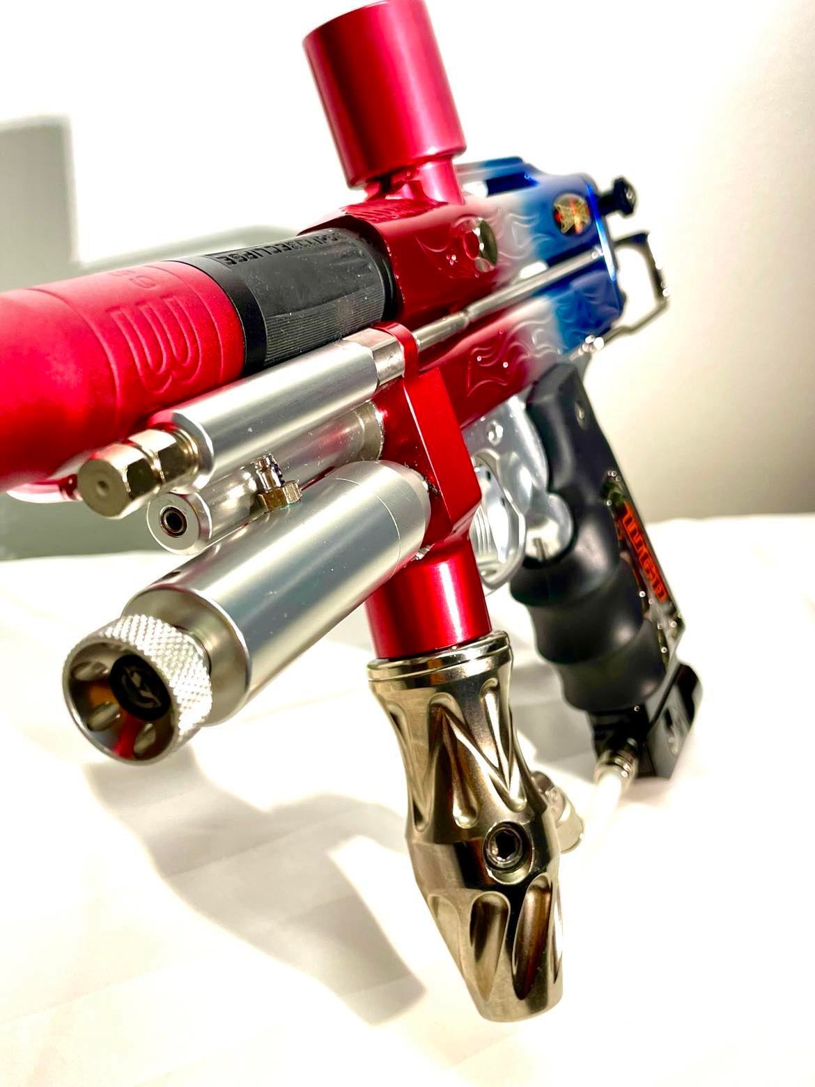

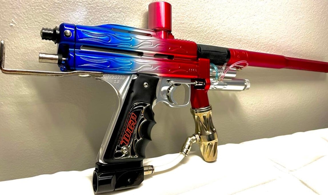

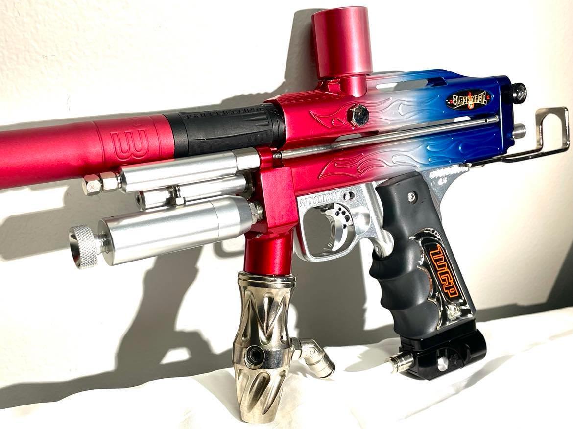

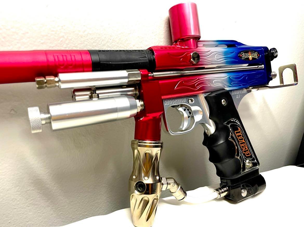

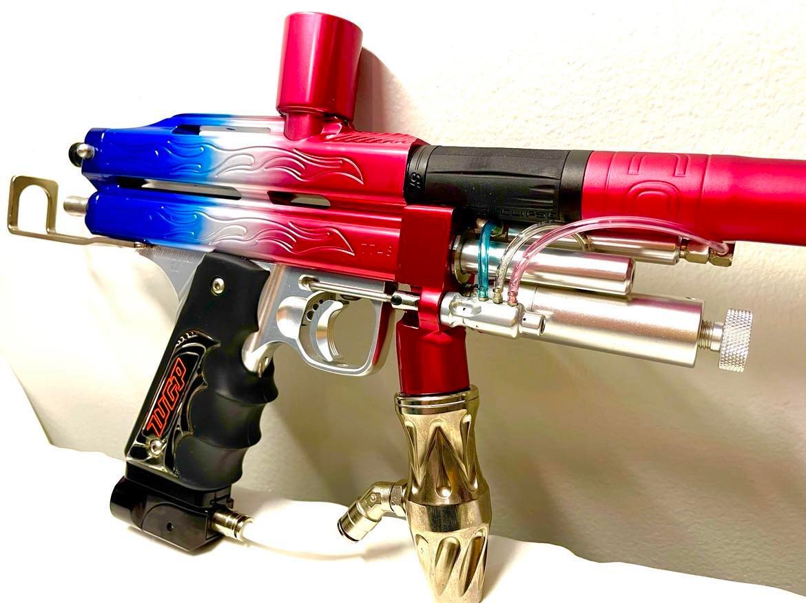

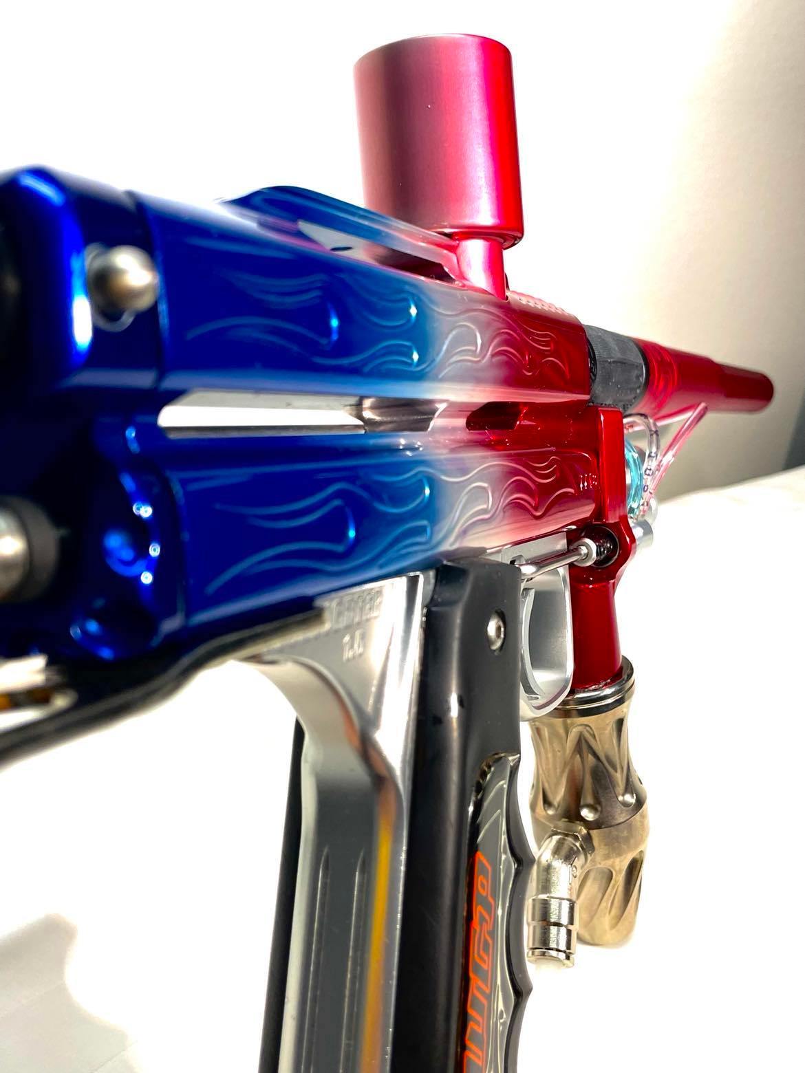

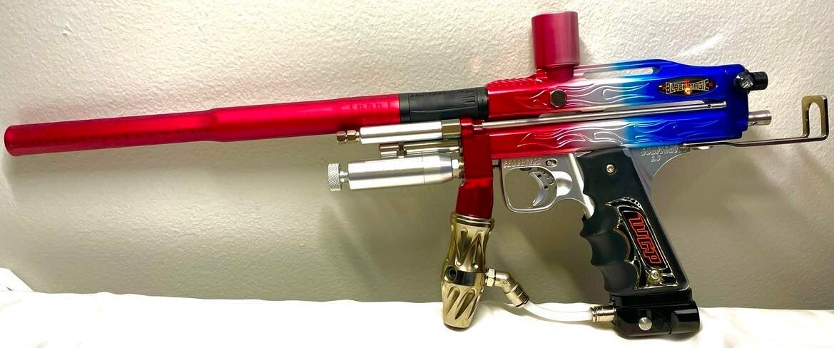

                    Here she is! All done! Can't wait for the spring!
                    • WORR13
                      • 374
                      looks good, nice work. how do u like the gunfighter?
                        MCB member
                        • 3511
                        • Montreal, Qc, Canada
                        Great work! I like the small detail like matching the color of the pneumatic hose with the body and the 45 degree macro on the HPR.
                          • 6380
                          That looks cool that frame looks great on there. I love my gunfighter frames.
                          • lew
                            Devious Dirtbag
                            • 1035
                            • WY
                            Looks fantastic overall, though the grips clash with the rest. I'd throw on a nice set of color-matching G10 grips. Changing out the ASA for a silver one would go a long way, too.
