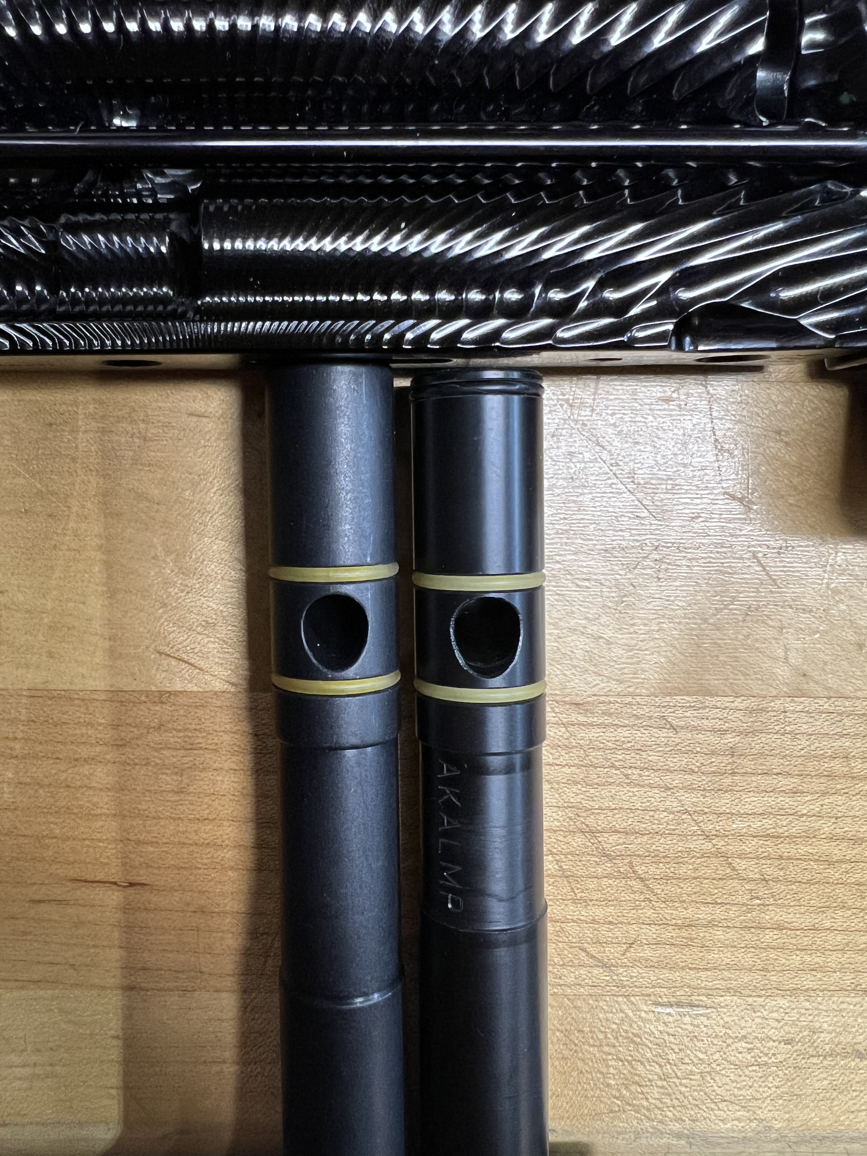

    I just wanted to bring some clarity to the many years of discussion about Evo bolts being the same as STO bolts and visa versa. They are NOT the same!
    I recently visited with Jarrod of AKA Paintball and I brought up the subject of needing a Evo bolt for my STO Autococker. He told me to hold off on that request as there is a difference between a proper STO bolt and the EVO. I snapped a picture of his Evo Bolt on the left and STO Bolt on the right.
    He might have some STO Lightening Bolts in the works so stay tuned .

    Yesss. I also learned that Shocktech SFL length bolt will work great for STO

      They do indeed.
    • 4469
    This thread made me look at my bolts and I found an EVO bolt, I don't have an EVO-bolt-length gun... hmm

      I think my point was though they obv work” , it wasn’t that they are great. It will be good if we can get something at some point that is actually meant for it and is spec though. That will be great!

        I remember hearing this years ago, and maintained it as truth. I was later "proven" wrong here on MCB a couple years ago. And now it looks like I'm proven wrong again lol.
        • maggot
          • 497
          Meh, they're the same. Put either one of those bolts in and the marker will shoot the exact same. The hole in the bolt, and especially the o-rings, are significantly larger than the hole in the body that the air is coming from. A 1mm difference in breech position doesn't matter.
          Prove me wrong.

            Any word on those STO Lightning Bolts from AKA? I want to get one for my F series Twister too

              Use a Shocktech SFL length bolt for the win on the twister bodies...

                The lengths are where the bolt pin is placed not the valve opening length
                • minimag03
                  minimag03 commented
                  I was under this impression as well. An proper STO bolt wouldn't fit into a Evo due to the pull pin hole not lining up, right? But that would still cause an Evo length bolt to sit farther back in an STO, causing a slight misalignment between the bolt and valve.
