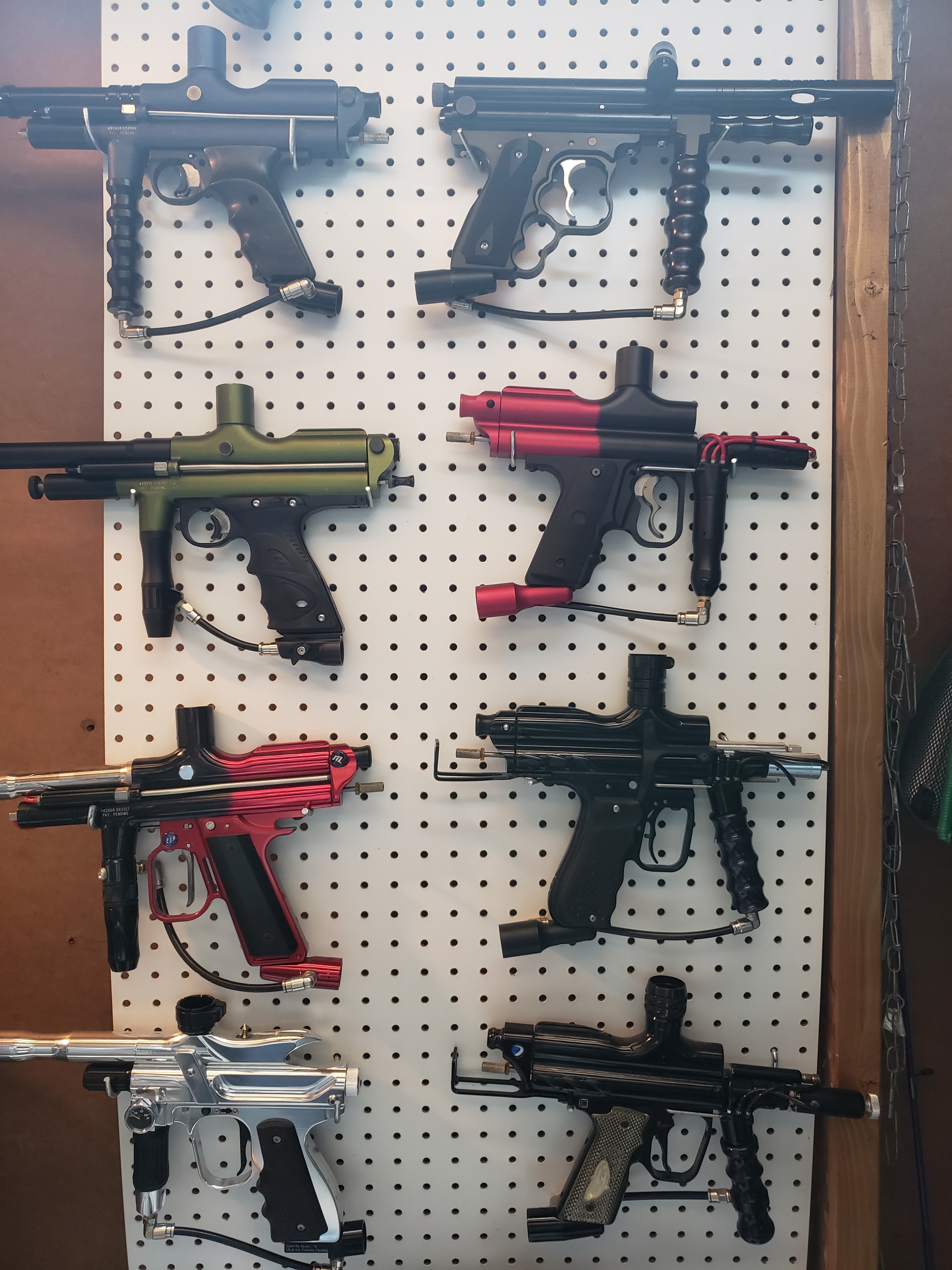

              There are other solutions that can be done also. Like having the front of it minied and using a mini frontblock. It will be capable of using standard timing rods, 3ways, lprs and rams. Here is one i did with a custom front block to leave the ram mount. I am working on being able to remove the ram mount on the bodies also to use a standard mini FB altogether and clean it up some.

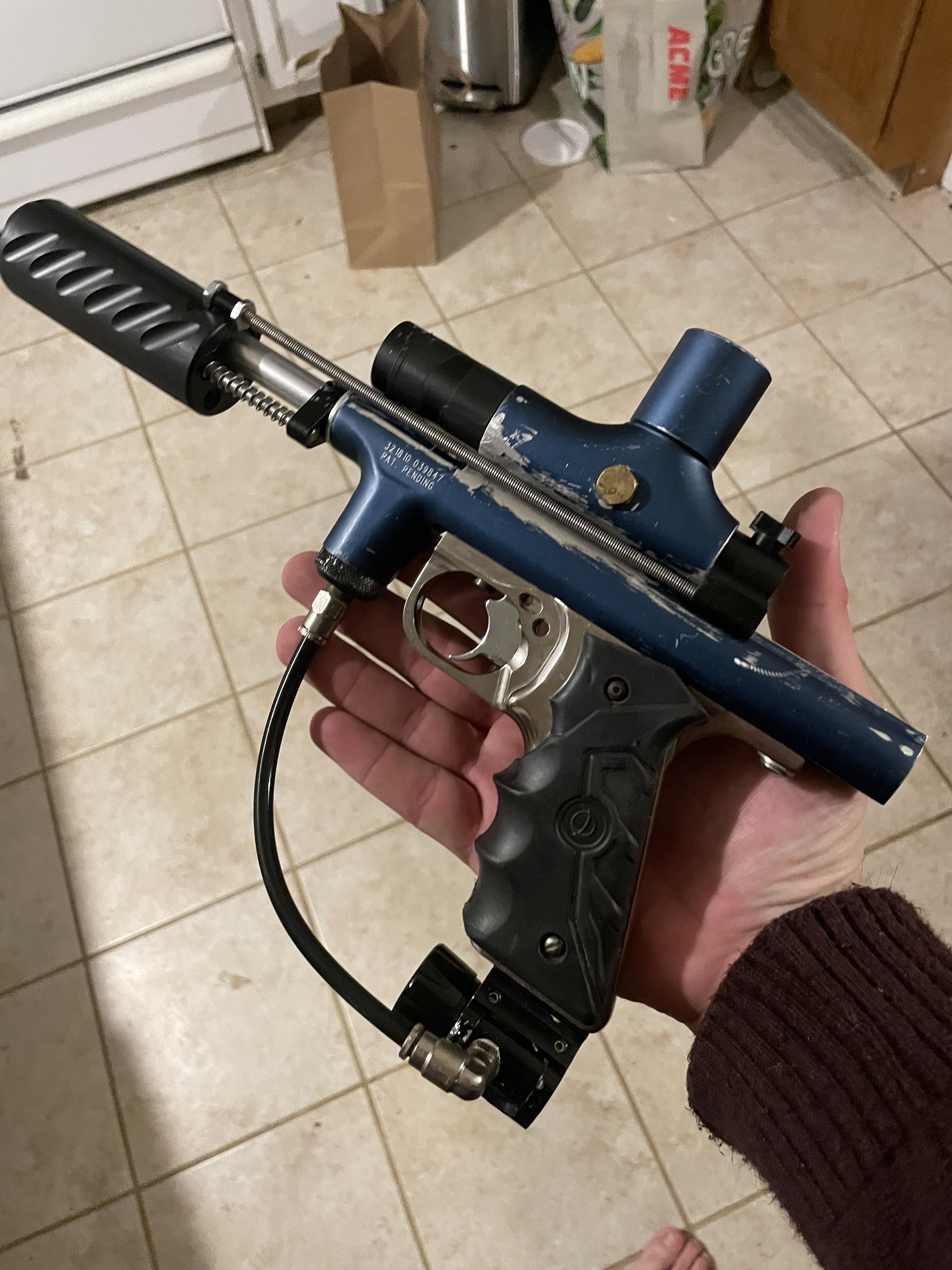

                Ive yet to encounter a frame that's NOT a bolt on replacement. No need for adjustable timing rod. Just adjust the sear lug, swap hoses, and you're done.
