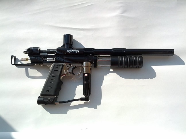

      Thanks, looking for pictures I only found this.
      im thinking about length wise opening, straight shot on each side ...

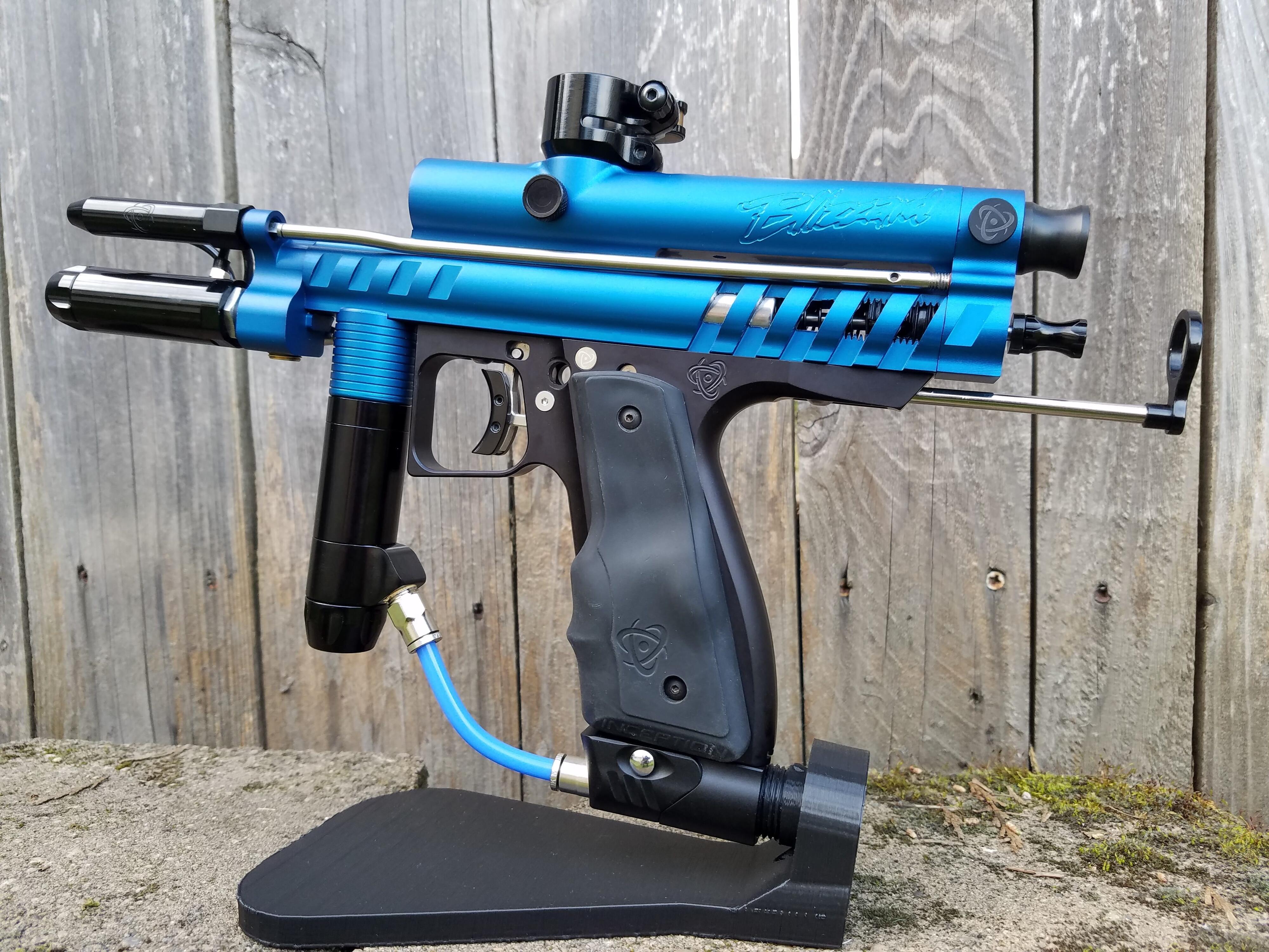

Name:
ID:	38704 Work without problem.
          Frenchy is here!
          • 3062
          • Nor Cal
          Thanks, exactly what I was looking for 😁

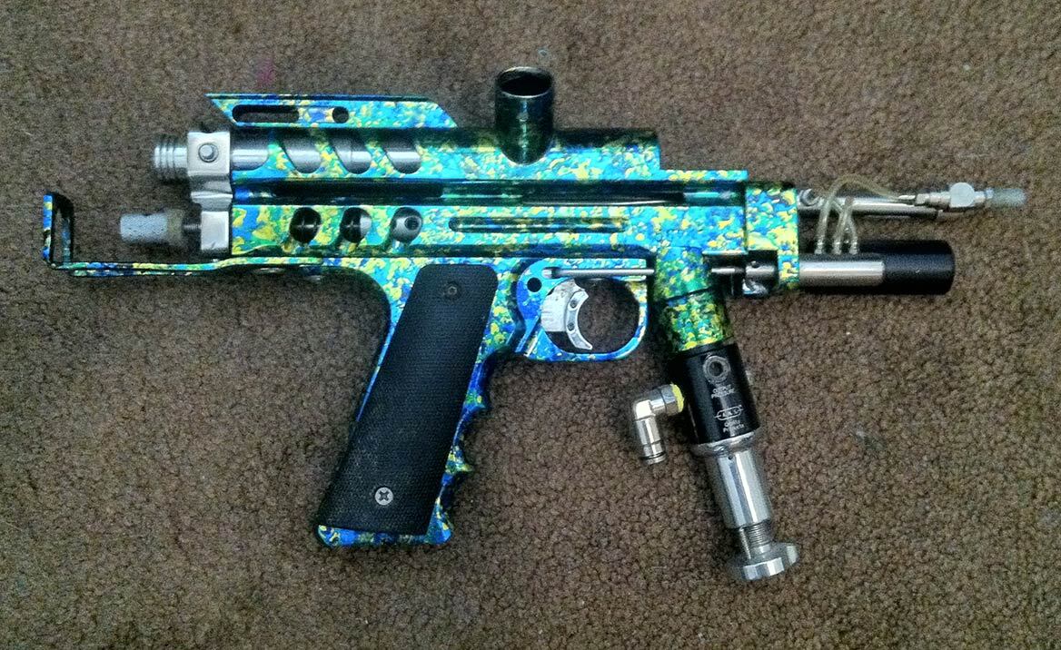

            also check out the kapp razorbacks, they had lower tube milling
              Frenchy is here!
              • 3062
              • Nor Cal
              Thanks, I didn't knew that one ...
              they really did cool stuff:
              Click image for larger version  Name:	tims-razorback-confetti-02.jpg Views:	0 Size:	216.6 KB ID:	38791

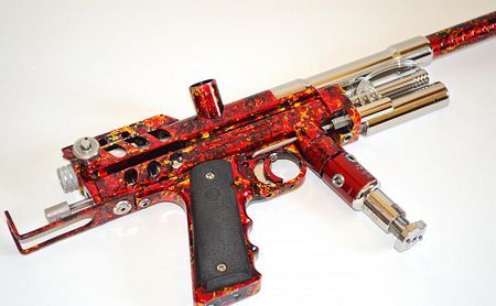

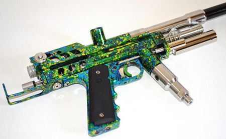

                  some more KAPP goodness from imon1maybe6 Collection Past & Present
Name:	ConfettiRazorback-2_zps3ef40d7f.jpg?width=450&height=278&fit=bounds&crop=fill.jpg
