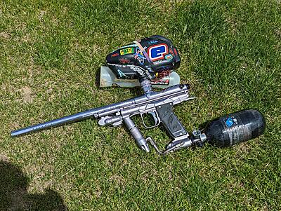

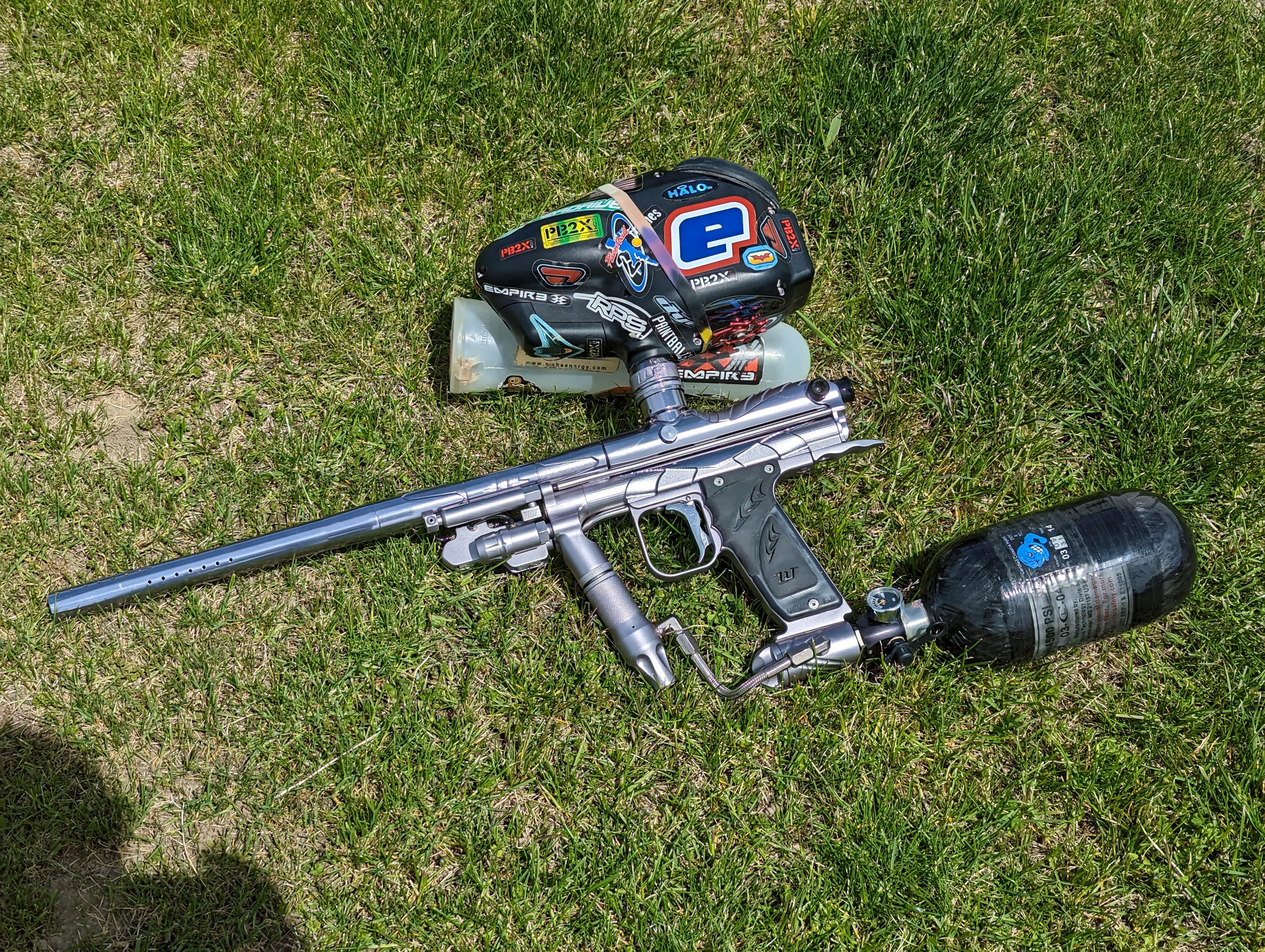

    Originally posted by Schroeder
    . I'm not sure why all the old threads don't talk more about the horrible efficiency at SON=4ms and why the PBX instructions tell users to raise their HPR to max venting pressure and then back off only slightly.
    That advise is pretty dumb as you will no longer have any velocity control. In my experience you do need to run them pretty close to venting pressure but that small area is your velocity control
    Also, got a photo of what you are running this on?
      See karni porn below. Lol. I said I was going to leave it all stock but I don't think I'm going to be able to resist the urge to throw a different feedneck on it. I've always hated the stock karni neck. I want a freeflow pump arm with wrench flats, a better LPR in the AKA SCM III, a better reg in an AKA sidewinder or 2 liter (open to suggestions here), and I already have a delrin wave trigger. The stock trigger with a more narrow bottom is also something I've always hated on the stock karnivor. A nexus/besales/inception/empire ram with eclipse QEVs is on the list. I want a hybrid iron cross or naughty dogs eye cover, but they're super rare it seems. CCM macro fittings will be coming too. If and when this happens I'm paying the money to have the parts anno'ed to match. It's not going to be one of those cheapo hillbilly jobs where the stock color scheme is molested.

        #18
        Ok, I just wanted to make sure you were not trying to run like a mini front end. I came across a cocker with mq2 that would only shoot 260 because of that
