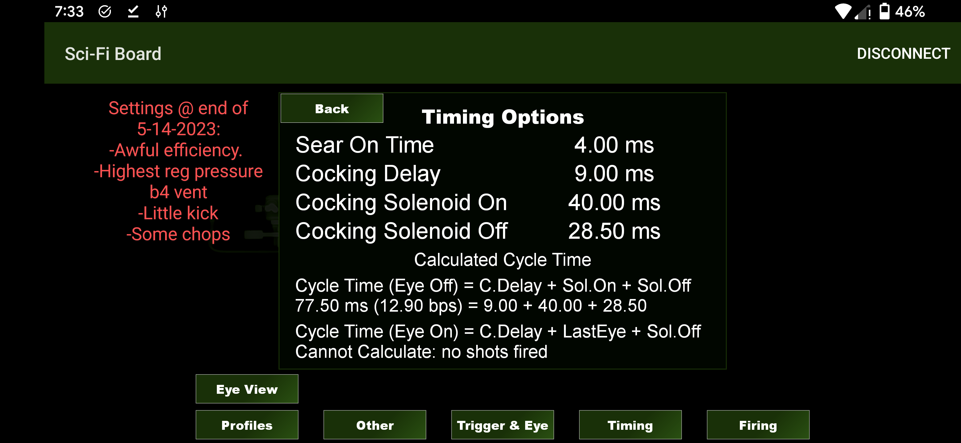

    See attached pics of the settings I ended with. This is all on a karnivor with the stock STO ram with TRVs, tickler LPR, and karnivor HPR. The HPR is turned up all the way (turning set screw out) until vent and then maybe ¼ turn back in to drop the vent and be reliable. I don't have a chrono but velocity looks good and there is no drop-off at ramp. My peak ROF doesn't seem to be that great. Maybe 12-13 BPS with the halo V35 on setting 4 of 6. Do I just need to crank my lpr up a little and induce some kick for higher ROF?
    The mq2 doesn't have the white spacer. I had the solenoid out of its housing to resolder the wires because I received it basically snipped off. I re-wrapped the coil in electrical taped and stuffed it back into the noid casing. I super glued the bottom shut.
    Everything seems to work except it's HORRIBLY, HORRIBLY inefficient. I'm getting 400-700 shots off a 4000psi fill on a 68/4500 tank. I don't know what to address. These are my only ideas:

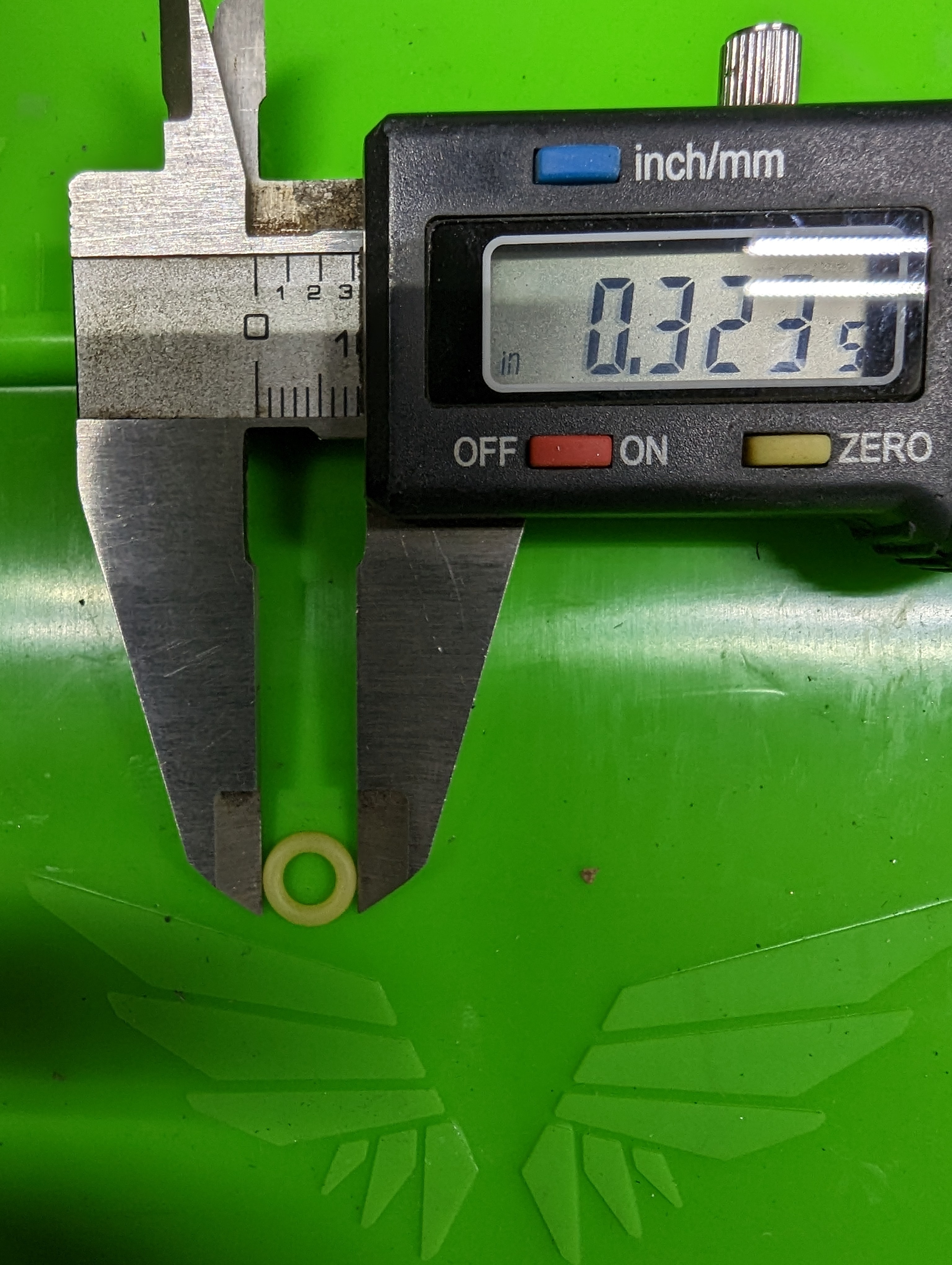

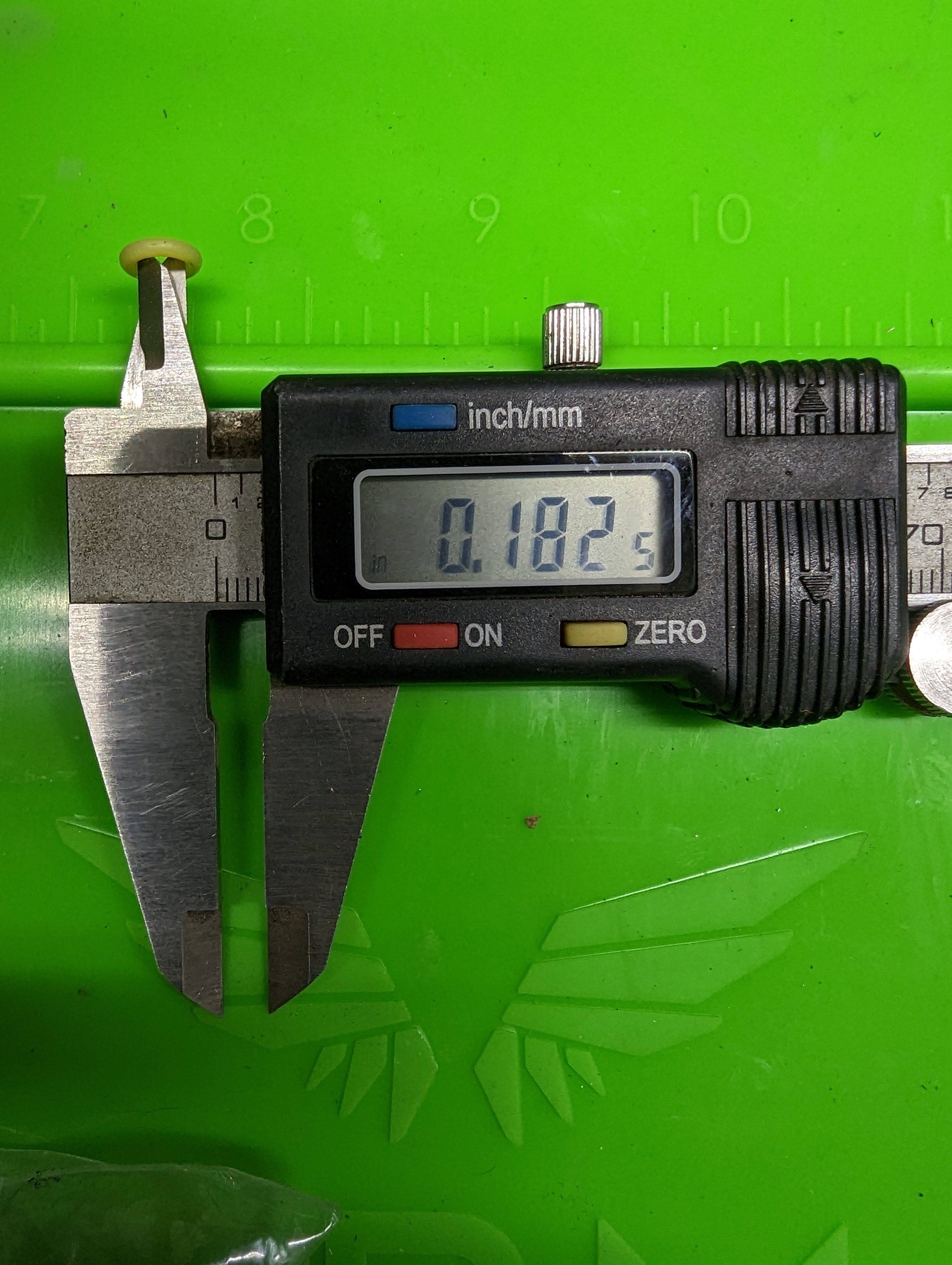

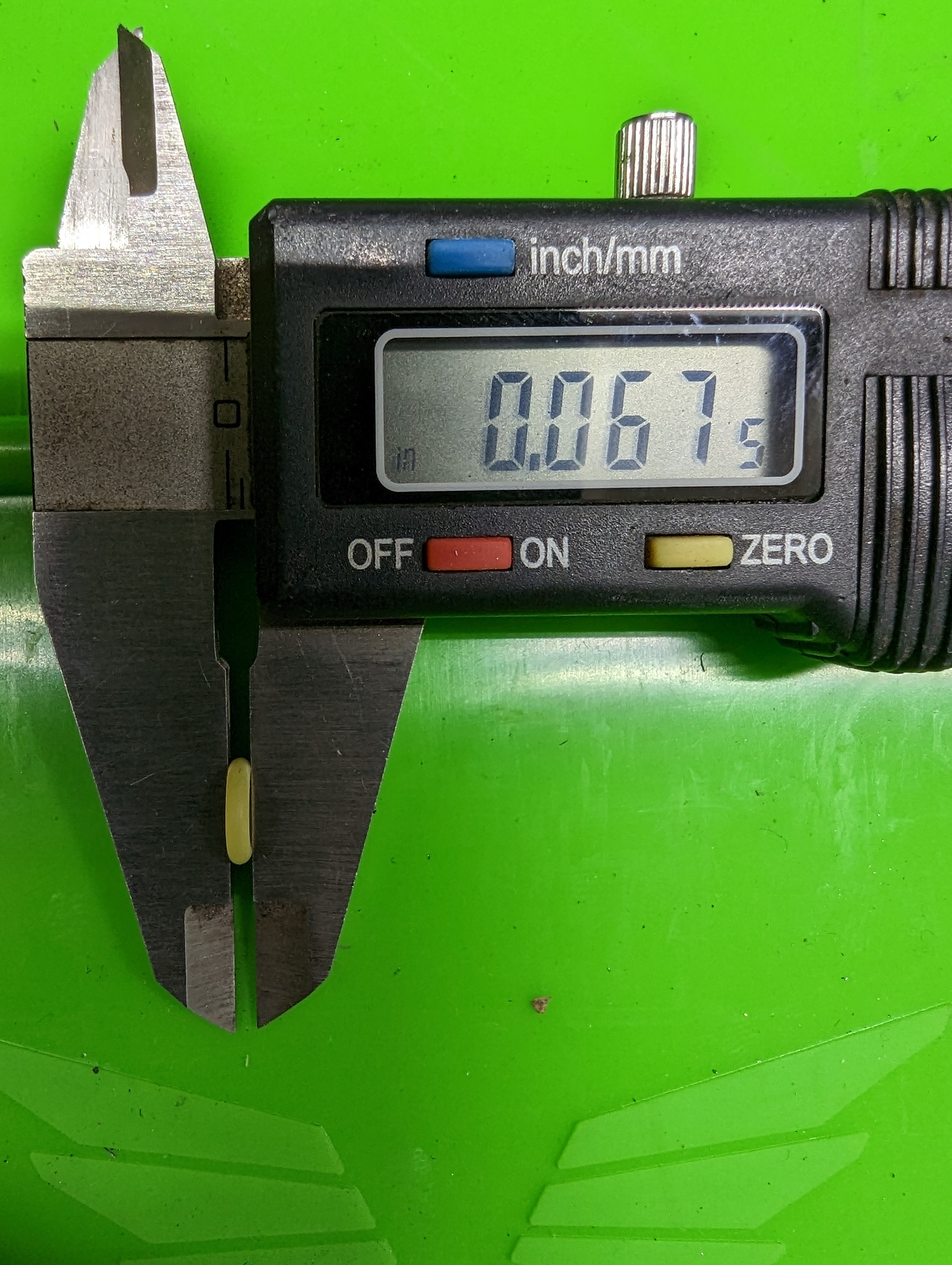

    1.) I don't hear a leak from the grip frame, but I'm wondering if I need to replace the urethane black dot on the face of the solenoid plunger from when I had the assembly apart for the repair.
    2.) Could the solenoid plunger spring be weak? If so, where can I get a new one? Custom cockers listed this as a century spring part, but the link is 404 now:
    https://www.mwcomponents.com/locatio...ferrer=century
    It seems the original provider has been absorbed. I thought about calling and asking if they had the spring number for the magnetic sensor systems solenoid part number or asking magnetic sensor systems of they'd sell me just the solenoid plunger spring.
    3.) Could I need a new poppet spring? That was listed on custom cockers as McMaster Carr. Part# 9435K74.
    4.) I only added new valve body springs. I didn't chang the poppet seal or it's o-eings because they looked good. I did lube them up nice with dow 33. The static seals on the OD of the valve body and between the valve and solenoid housing were covered in dow 55.

    With your current cycle time of 77.50 ms, you can’t get above 12.90 bps. 1,000 ms / 77.50 ms = 12.9 bps.
    If you’re trying to fire faster you can reduce the cocking solenoid off time. Any reduction in total cycle time will increase cycles per second.
      Doesn't that formula only apply when the eyes are off? Hat about the inefficiency aspect of the gun? What are the remedies? Do I need the white spacer? I found this in the bag of parts. It's the only thing sized this way. It's an p-eing o-ring of some kind. Is this the white spacer?

        Yeah when the eyes are installed the cocking timings are overridden. Interesting to see that they aren't at the default values here. If your HPR is cranked like Jason Stathem and you're tuning the valve from that point your efficiency is gonna be shit. The spacer won't affect performance and efficiency so no need to worry about that. I would set set the HPR lower and sweetspot it with the board values.

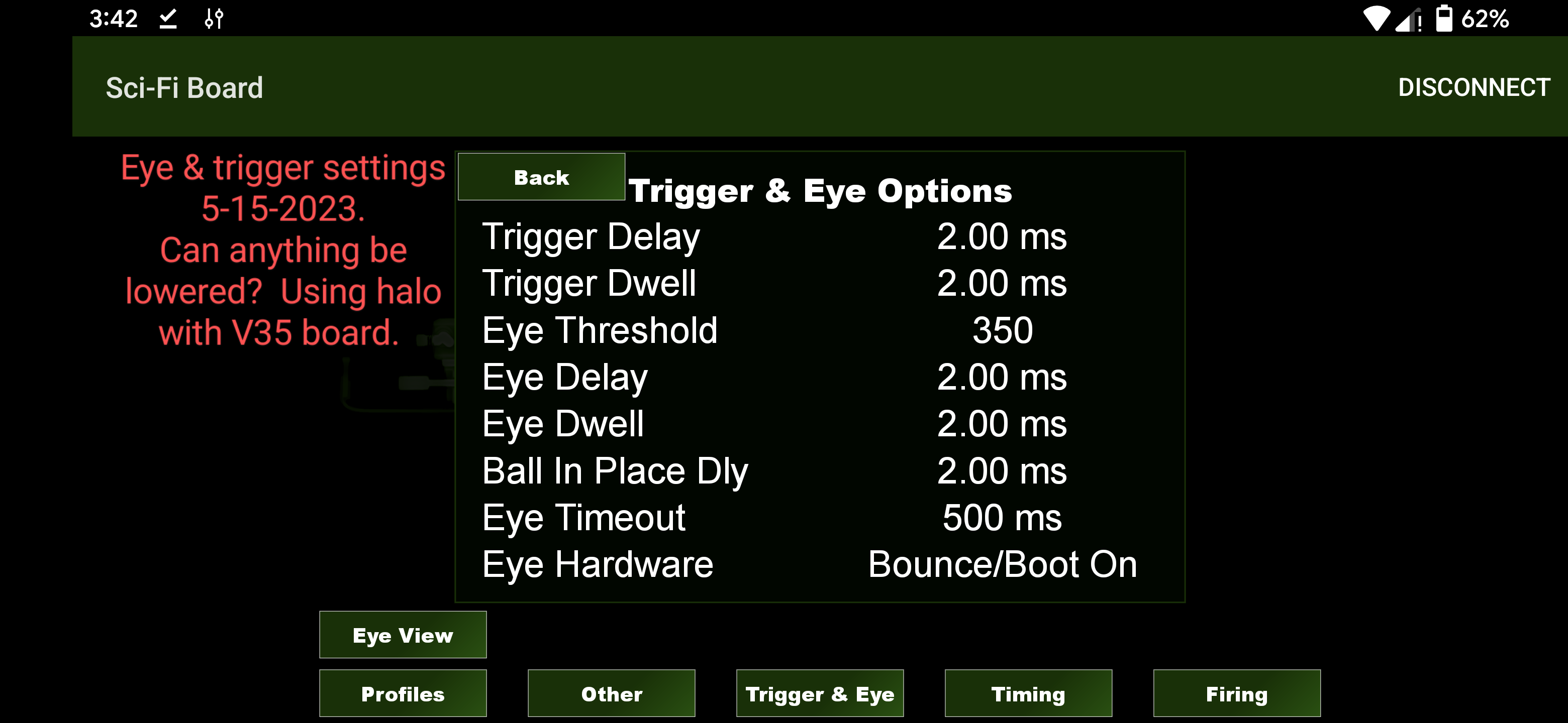

          What timing parameters should I expect to change in this scenario? Will SON have to increase to 5-6ms? Is it worth getting one of those CP reg gauge adapters ( https://www.ebay.com/itm/32281643534...mis&media=COPY ) for an HPR so I know right what my HPR is set at? Right now I'm just following the MQ instructions- crank it up to the venting point and back off until it stops leaking.

            According to the sci-fi manual the only timing that is overridden when eyes are enabled is the “Cocking Solenoid On Time”. So my recommendation of reducing the Off Time still applies.

              Right. What does that mean max ROF is then? is it calculated by 1000/(COFF+CDEL)? Are any of the eye delays in the formula? I'll have to look in the sci-fi manual I guess. Since my ROF seems to be pretty close to the formula ROF= (1000/(CDEL+CON+COFF)) I wondered if any of the eye parameters like the Eye Hardware = Bounce/Boot are making the CON value come in to the equation.
              Regardless of the ROF issues, how do I address the inefficiency? Roger7pball , I think you're suggesting to lower the HPR and then mess with the timing to get velocity where it needs to be. Won't decreasing HPR pressure and increasing dwell make my efficiency even worse? Post #17 in this thread from custom cockers references the PBX guys stating that efficiency increases with higher input pressure and lower dwell. That's why I started getting focused on the spacer.
