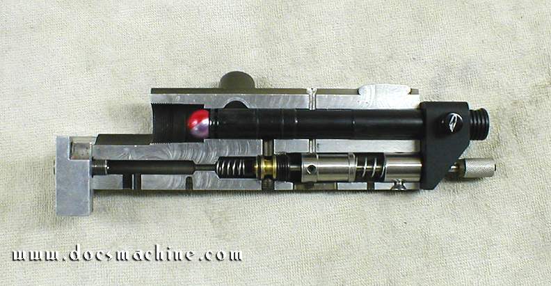

  • latches109
    Always Sciencing
    • 2113
    Brokeass_baller I think you mean larger.. the normal spring perch is not there, so we use a long spring with the LPR back as the perch.
    Click image for larger version  Name:	cutaway1.jpg Views:	0 Size:	53.2 KB ID:	409422
    photo credit DocsMachine

    • Magmoormaster
      Only here for the zipline
      • 1305
      • Glendale, AZ
      Yeah when I said “longer” I meant the spring, not the body. I see the confusion though. My comment is a bit incongruent.
      • Brokeass_baller
        Pick it up!
        • 1129
        • Ohio
        latches109 yeah, I guess that is what I meant. With the spring landing inside there, it's easy to forget there's extra volume on the other side of it.
