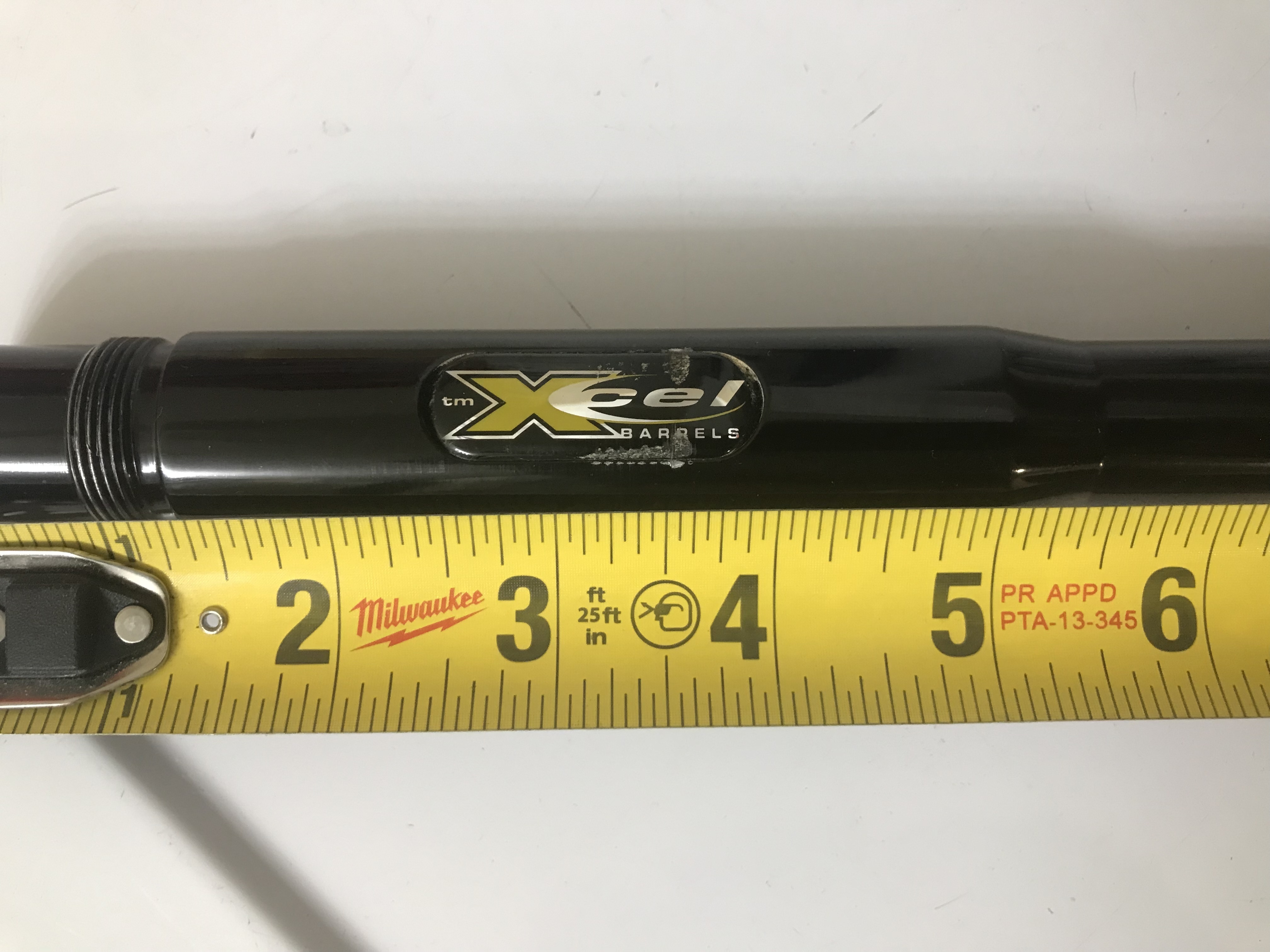

          I did a little digging and it looks like a Dye Xcel barrel would fit perfectly. Can anyone confirm the rear section has a 1" diameter?
          On the same note I was looking at putting a gauge in the port on the bottom of the front block. Would this interfere with the shroud?
            scottieb commented
            I have an auto cocker threaded Excel barrel at home. I'll try to check it out when I'm home from work today.
          • 4331
          It does have a 1 inch back with a jewel that sticks out a little bit more so there might be interference.
          you would need to cut back the neoprene some to fit

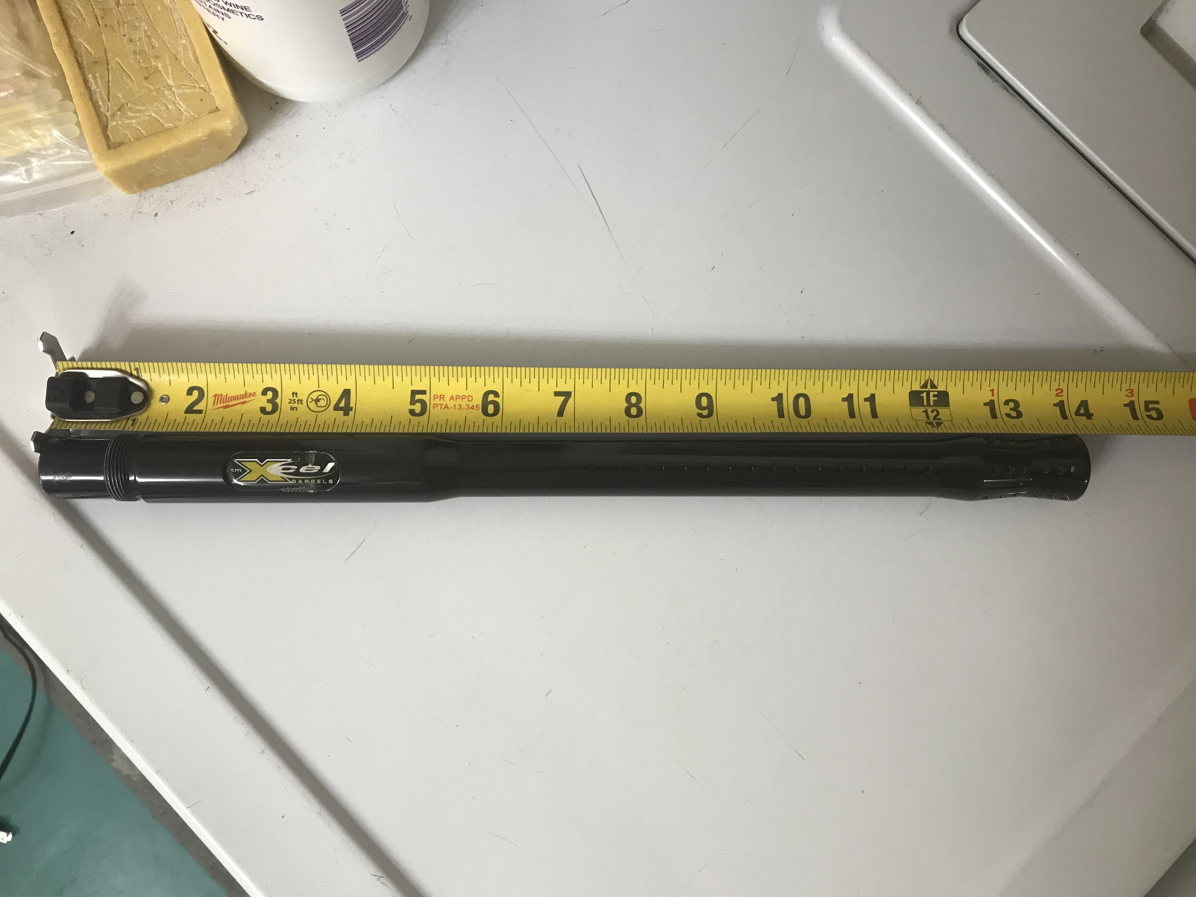

            • 4191
            Dye Excel cocker threaded barrel:
ID:	469359 Click image for larger version
            • Toestr
              Toestr commented
              Thank you for this. Would anyone happen to know how long a shroud is?
