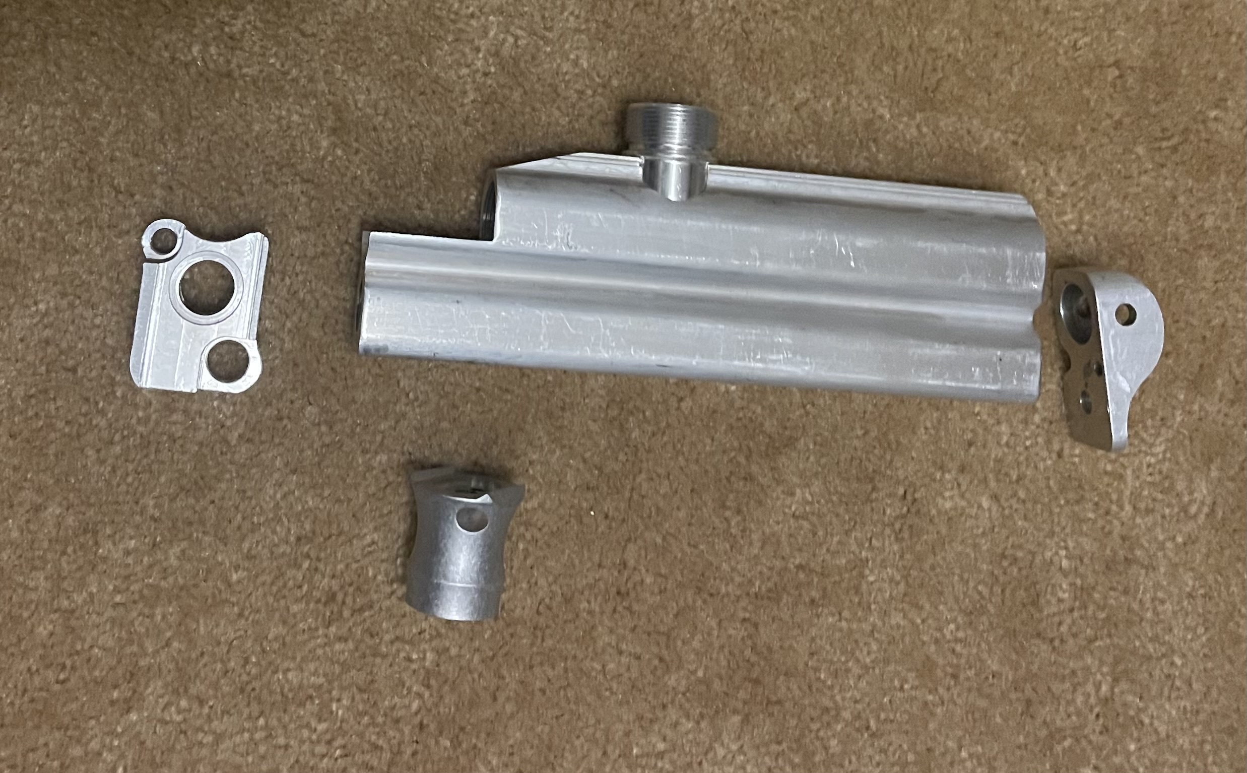

    Autococker build
    Hey everybody. Getting back into paintball after a long hiatus and am building an autococker. Figured I’d post it here as some semi-irregular news and entertainment, but also for input.
    I do need parts and have been talking to a few forum members on lower tube and pneumatics. Looking at a palmers LT lower valve and belsales pneumatics.
    Thinking about some machining, most importantly a ball detent. I’m leaning towards a wire detent.
    Leaning towards a J4 PAT barrel system.
    Lastly looking at caustic for anodizing.
    I desperately need a grip frame. I’m currently split between a “period correct” benchmark, a meteor frame, and an inception 86 frame a guy has listed, but am open to suggestions.
    comment away!

          If you are going for a slider, the guts mean more then the frame itself. There are a lot of AC frames out there that were built, the latest AC craze has driven the prices up on some to unrealistic costs. Look at some of the other after market frames. I personally am a fan of the ANS Quickfire frames with their guts. Usually those can be found at more reasonable prices. I actually bought one a few months ago for modification to work with an old school Sterling I have (work not started yet )

            If you can find a ccm low rise STO neck that would go great on that body. Otherwise get an inception of geo feedneck and get neck modded for a fit.

                  The trigger frame is the most important part of the gun. As others have mentioned, the internals are make or break, though it’s not hard to get the right stuff. A good chrome plate and a roller sear will get there. The frame itself matters a lot less, but some have nicer features.
                  I like having trigger stops, and unless you go very short I disagree that a shorter trigger results in a harder break. 3-4mm is a good sweet spot. I also like finger grooves. Kapp groovy frames are good, the new DYE Ultralite frames are cool. My personal favorite is the Niche 86* frame, but they’re quite rare. Benchmark, old DYE, ANS, shocktech, etc, will all work just fine though.
                  The inception frames are cool. Just know they have a unique trigger feel. Actually as a mag shooter you’d probably prefer it. You can get a NOS trigger plate to get a more traditional feel, but normally they just feel different.
                  Id recommend against palmers anything. They’re not well built and performance is subpar. Stock WGP internals will do just as well, if not better. Actually the best performance I’ve ever used was eclipse. Same with belsales, they’re stupid expensive now.
                  Id suggest prioritizing the frame, then internals, then pneumatics. Pneumatics don’t matter much at all. Honestly you’re not likely to outshoot the stock brass pneumatics from a 2k WGP. Just get a quality set and call it a day.
