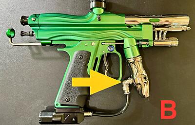

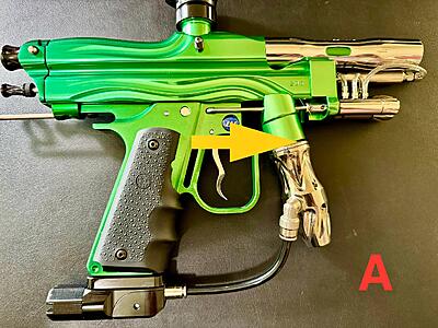

    Looking for advice - don’t like how the air fitting feels on my orracle. Would like to seat it like in picture B. Thought maybe an oring or rubber washer (suggested by r/autocockers101) would help keep it in place (above reg in pic A) Anyone have any luck with something like this?
    also - any links to 45° fittings? I know docfire had some on his site but it’s down for Supergame. He also did an awesome job tuning up this marker; highly recommend. Thanks all!

    fit a 112 oring on the top of the reg

      Yes, 45 Slip Fit Pneumatic air fittings exist which would improve your bend and how it enters the fitting. You could also by some Aluminum or Stainless hardline and custom fit a hardline (which is what I would do).
      As latches109 said an o-ring works or a rubber washer as you have already been told. I have a bunch of nylon washer/spacers that I have for other things that I just find the right thickness to get it almost to where I want then have to "force" the final little bit so it does not move.

        An oring at the top of the reg should give you a little wiggle room, you can also place it inside the VASA as well

          As Psycho91 mentioned, you could possibly place a 014 or 015 oring on top of your regulator that prevent it from screwing all the way in. If you want more elegant solution, I imagine Ninja Paintball's adjustment clips might wok on your reg They're meant t obe be used on tank regulators but I dont't see why they wouldn't also work on your inline regulator.

            You can always leave it a bit loose - as long as the top oring is against the sealing surface you'll be ok, air pressure will "lock" it in place when aired up.
