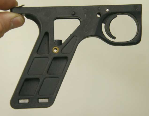

            If you want single hole Composite frames you can not beat AGD (Automag Frames) they will work with traditional Snipers without modification (same bolt pattern between AGD and WGP) and only need a slotted hole for the 3-way if using with an Autococker. The cheap single whole frames that came from WGP were non-reinforced nylon IIRC and break super easy.

            I just tried to find an AGD CF frame but can not locate one to be sure. In the past I have used an AGD CF frame on Snipers but I was using them in conjunction with the swing trigger out of an earlier pot metal frame used on early snipers or repurposing old Sheridan marker triggers. I had teammates that liked the old swing triggers, as a reason why. Though I seem to remember playing with sliders also with these frames but can not remember if we had to deepen the area for the trigger plate but the Sear Spring perch is stock in the frame. You will have to drill the sear pivot hole but you should be able to use your existing frame for a template.
            So yes you can use them others have done it but it may take a little modifying to get it to accept the slider guts but they bolt right up to a Autococker.
            Image from Bacci's site.
