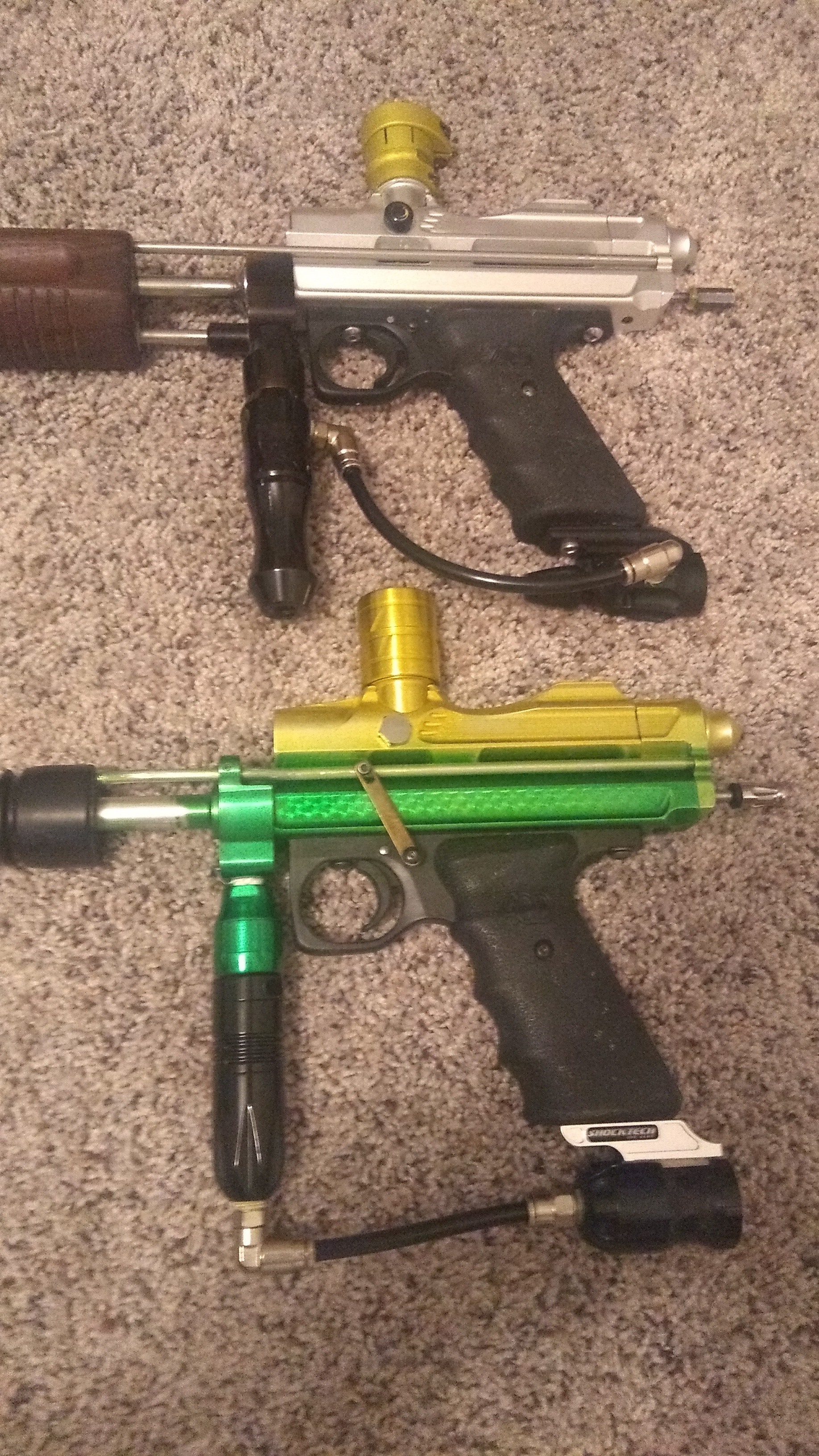

      Here's a 45 frame. Since it is on a pistol, the only thing I have to watch for is to not tighten the frame screws too much. I have played several long days with this pistol. Since this build is light it only has to stand up to pumping, which is light, being a regulated setup. It is a slider.
      This is a WGP composite slider. It seems tough enough. I have played a 45/45 on it a few times, but have a 13ci for it now. Again, light duty.

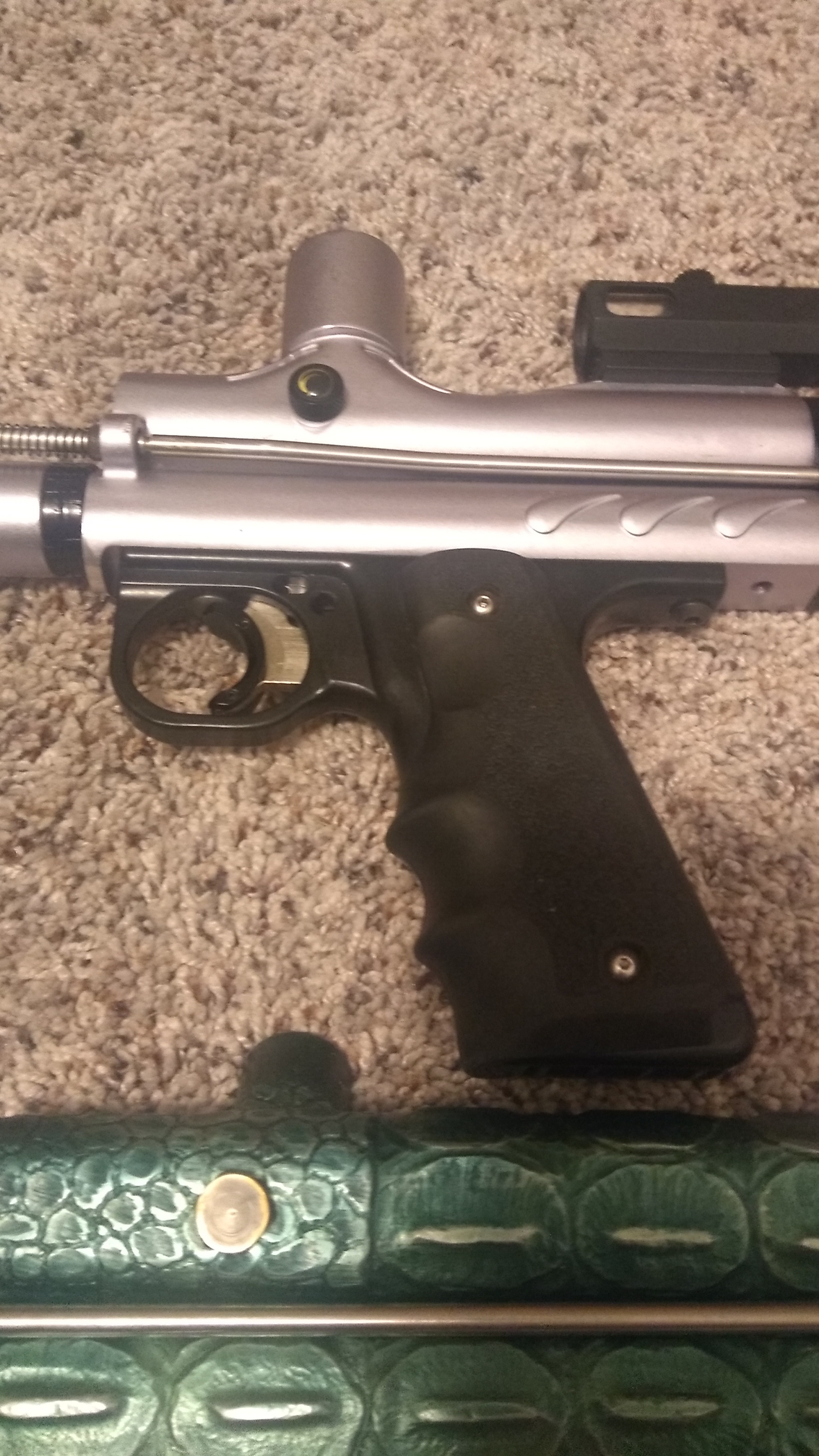

      These two superbolts are my workhorses. They are stock AGD frames with the superbolt sear and a #4 screw that sticks out of the AGD trigger to hit the sear. The threads are ground off were the screw meets the sear. The trigger bottoms out before the sear mechanism hits anything, so there's not a big load on the screw that is in the trigger. I haven't tried other sears or a slider plate in an AGD frame.

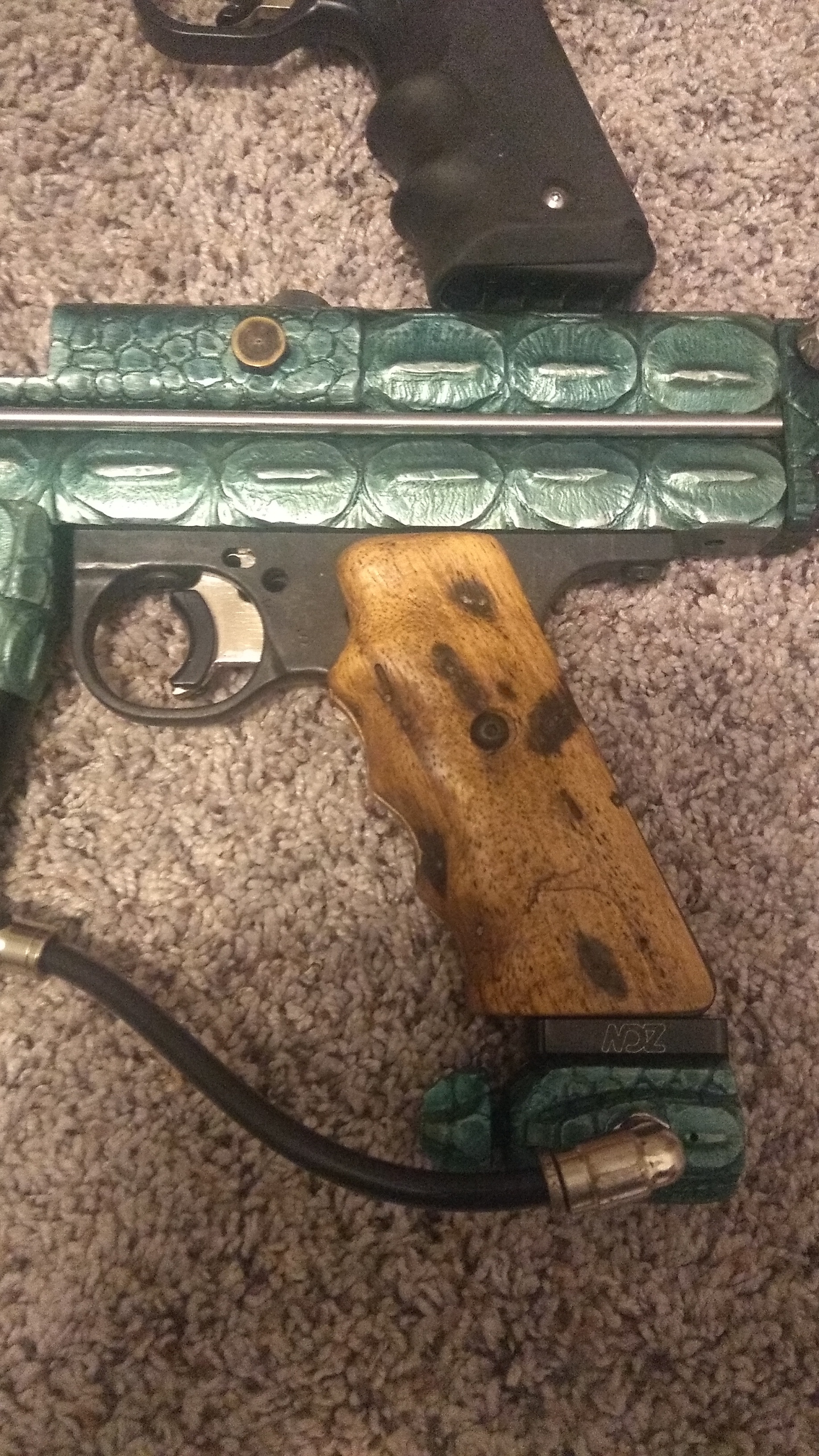

      All of these builds are very light bodies with the light frames, so I don't mind being a little more careful with the WGP frames. I've had two of the bad frames that look exactly like the one on the gator marker. I couldn't find a mold mark worth of difference. Those two broke as soon as I tightened the rear frame screw. Even though these two have survived and seem better, I don't leave them in the sun or use solvents on them. I can say the gator frame is slightly gray and has a dull sound to it, where the bad frames were shiny black and sounded brittle in the first place.

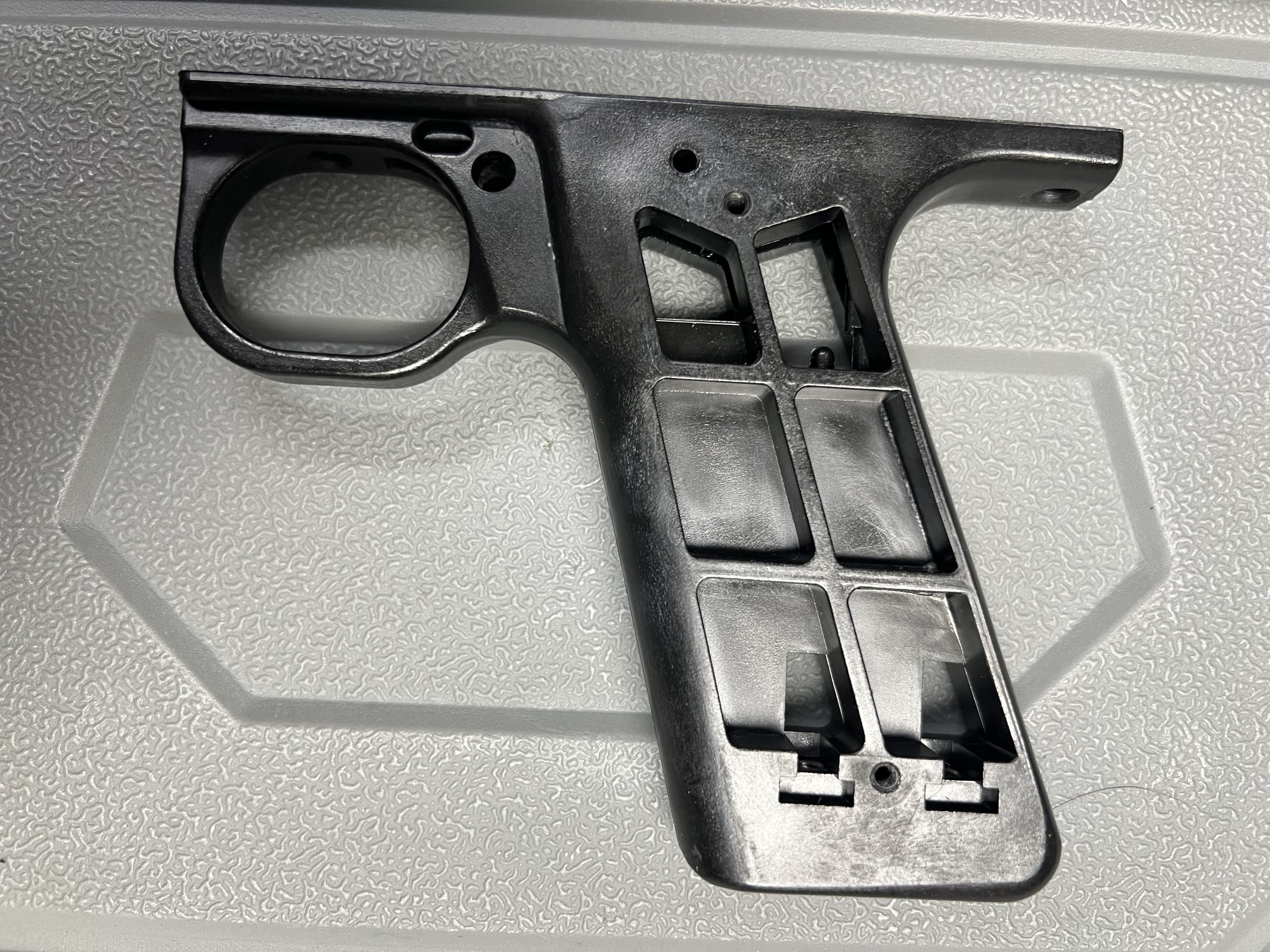

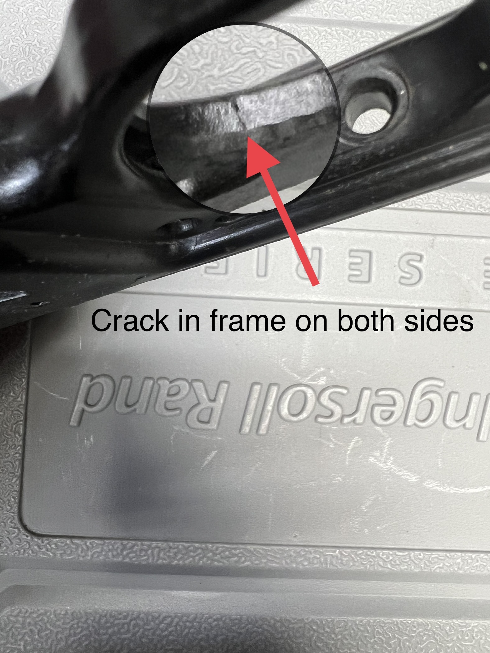

              I just ended up with a plastic two hole 45 grip frame. In all honestly it feels pretty nice. BUT upon closer inspection I noticed cracks along the top of the frame above the trigger frame. I’ll get some pictures.

                AGD helped WGP with the single-hole composite frames. These composite .45 frames came later, and were much more fragile than the older ones AGD helped with.
