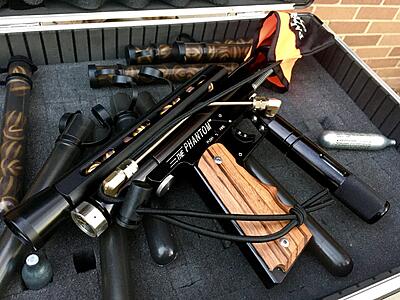

        Eventually we all learn that “1911” isn’t really a spec. Usually you can count on the screw spacing being correct but grips vary, actual 1911s vary, and paintball guns vary a LOT because many were only designed to work with wraparound rubber stuff from Houge or Dye which are very forgiving.
        This took a lot of sanding and such. Hogue hardwood wraparound grips are absolutely not a drop in for for a Phantom.
