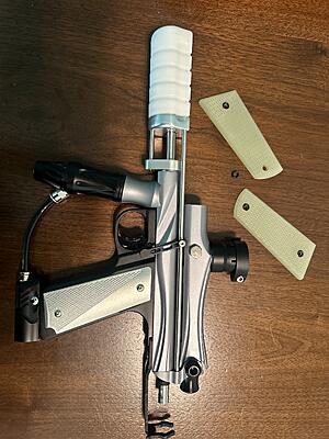

    Hi MCB Braintrust,
    I've got a 2K5 Prostock I'm in the middle of converting to pump. I am trying to smooth out the pump stroke.
    I've got a ACP Slice Kit and Shocktech lower tube kit installed. I'm getting a lot of drag on the stock bolt due to the large o-rings. Big difference in pump stroke with bolt installed vs. removed.
    Wondering if you guys could provide recommendation on a better bolt for pump. Seems a bit tricky to source since it is "EVO" length.
    This bolt from ACP is readily available, but it also has 2 o-rings so not obvious if it will be any better. Although the o-rings do look skinnier.
    https://autocockerparts.com/karni-ev...in-spine-bolt/
    Thanks!
