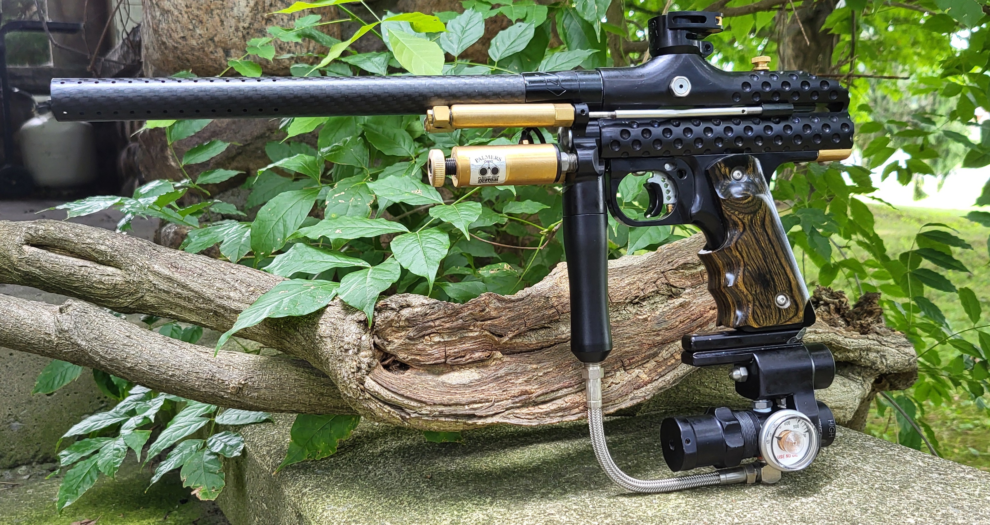

        • 3510
        I'm a fan of midblocking as well. Halfblock dimensions look strange (unless it's a PTP Micrococker).
        Angry Antle did the Trilly body on mine.
