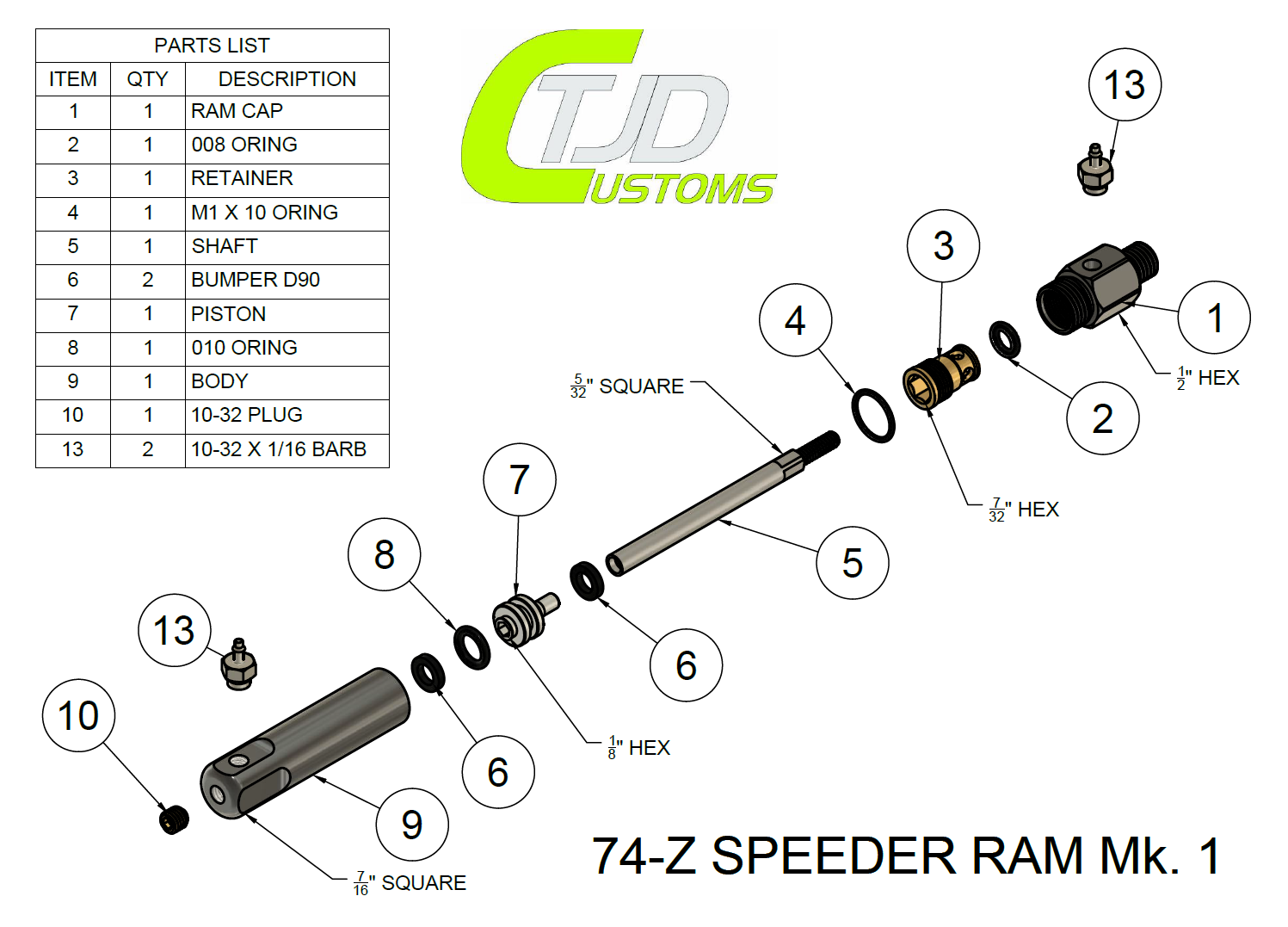

    So I made a new ram for autocockers. Actually I just got around to making a design I started thinking about maybe 5 years ago. If anyone was around that long ago you may remember I sold a few rams back then as well but they were much more traditional in design. Anyhow the Issue I had when selling them was installing the oring for the nose of the ram. You know the little tiny one that needs a super long pick and only maybe comes out without too much damage. I would love to show you some pictures but I'm having a hard time getting the new site to accept them so if you would like to see some pics of the internals and such below is a link to a review of from a beta tester about the unit I sent him for review.

    Biased on his and others remarks I did end up changing things such as the barb. The new barbs are the same front and back and are all now Nickle plated brass rather than just raw brass. I also slightly changed the brass insert the review units had a 6mm internal hex the production version has 7/32 so you only need one set of allen keys for the whole thing. I also ended up slightly changing the piston to get a better seal on the piston oring. And lastly I changed the bore of the body to have a burnished finish rather than reamed and honed finish.

            Honestly I'm surprised that it has not been done already. It seams like even the people who put the rams together would be looking for an easier way to assemble standard rams and this seamed like a pretty obvious evolution. I guess it just needed someone lazy enough to do the work.

                They look shorter than an STO ram, right? Somewhere in the range of an Empire ram?
                • tjd10684
                  tjd10684 commented
                  Its just under 2.5" from the back of the ram to the end of the hex on the nose.

                Nice design. Has a lot of the improvements that I've long desired a RAM to have to make working with them easier.
