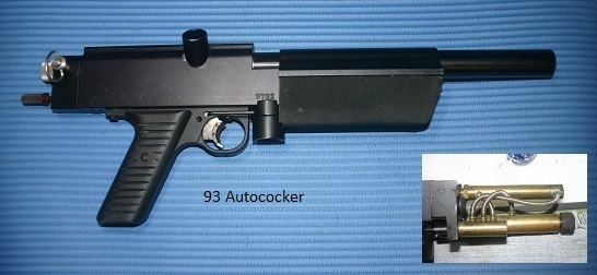

My 1993 autococker is driving me nuts.
  • Walker
    • 1624
    • WA State
    This is how your old Cocker would have looked originally:
    Mine is s# 9782.....

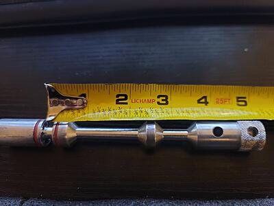

        Originally posted by Walker
        When you gas it up, if the following happens, your hoses are correct:
        1. Ram sucks the back block forward, trigger not pressed.
        2. Press trigger and ram pushes block to the rear and cocks the hammer.
        If you are not getting any air down the barrel when you fire the gun, one (or more) of three things are probably wrong.
        1. The valve is not aligned correctly and no (or limited) gas is getting to the bolt. If the valve has two ports, one should point directly upwards, and the other should be under the retaining set screw on the bottom of the body. Pull the set screw (not gassed up) and look and see if the bottom port in the valve is visible. You should be able to look in and see the valve pin.
        2. The bolt is in wrong, however this shouldn't be the issue as with that type of bolt it shouldn't matter.
        3. You are using the wrong length bolt. I.E. - A 2k bolt in a pre-2k setup, or a pre-2k bolt in a 2k setup. The back block shown in the 1st post needs a pre2k bolt.
        The top bolt is a pre-2k ANS, the bottom is a 2k Shocktech:
        My bolt it like the one on top.
        I think there's something going on with this valve.
        I can't find the bolt length next to a ruler online but mine is 6 3/8

          It's not the length of the bolt, but the distance between the pin hole and the air passage. If it is too long, or too short, it doesn't align with the airport from the valve to the upper tube. The distance between the pin hole at the back, and the front of the bolt can also play into a properly shooting gun, but has no effect on the air passageway.

        My hoses are right. And I got 9874.
        I think you're right on the bolt tho. I remember having a 2k and turning the bolt upside down made the gun cycle the way it is.
        I'll just buy one of each stock pre2k and 2k bolt to test

          I think my bolt is correct. The measurement lines up with yours
          I'm starting to hate this gun 😆

            my main advice is still new lower internals, i think you have the right bolt
