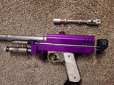

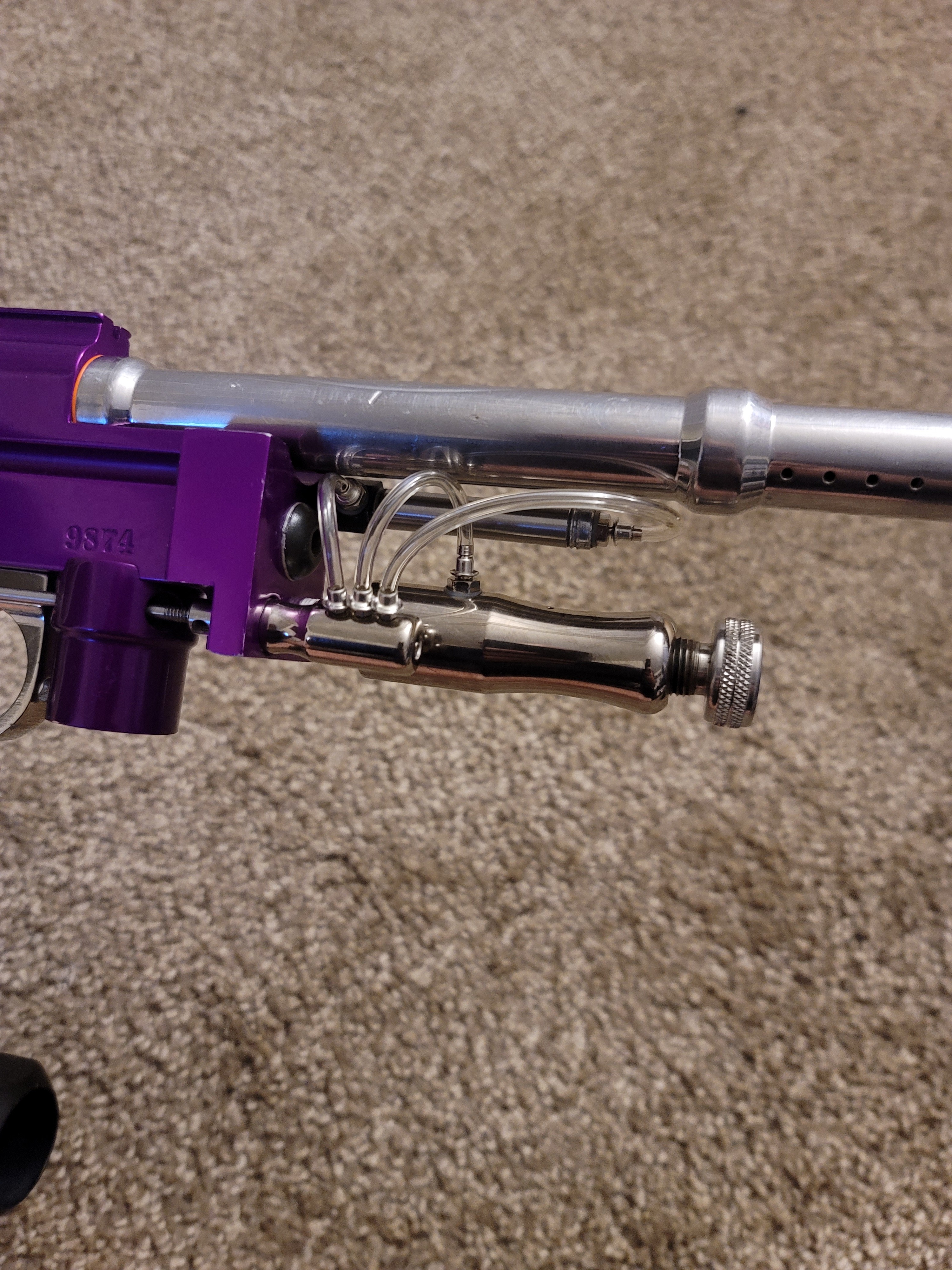

    My 1993 autococker is driving me nuts.
    I have this 1993 cocker with an ANS front end and old Sheridan internals. No timing hole and the lug has a set screw inside of that pin.
    I finally got it to not leak. but now it cycles like the bolt is upside down on a 2k cocker.
    The valve has holes on each side and the bolt is just a valley
    I'm stumped. Can I put in more modern pre2k internals or am I just overlooking something simple?
    Thansk

    How much pressure you putting in?
    Those internals are made for use with co2.
    old PBN feedback

      I was playing with all types and nothing was doing the trick.

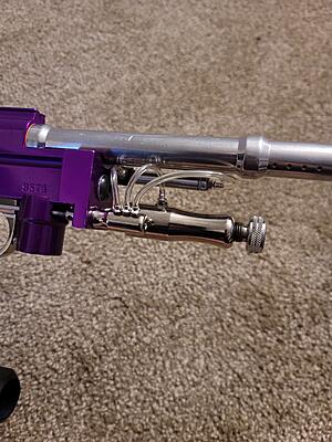

              i think your 3 way hoses are reversed.

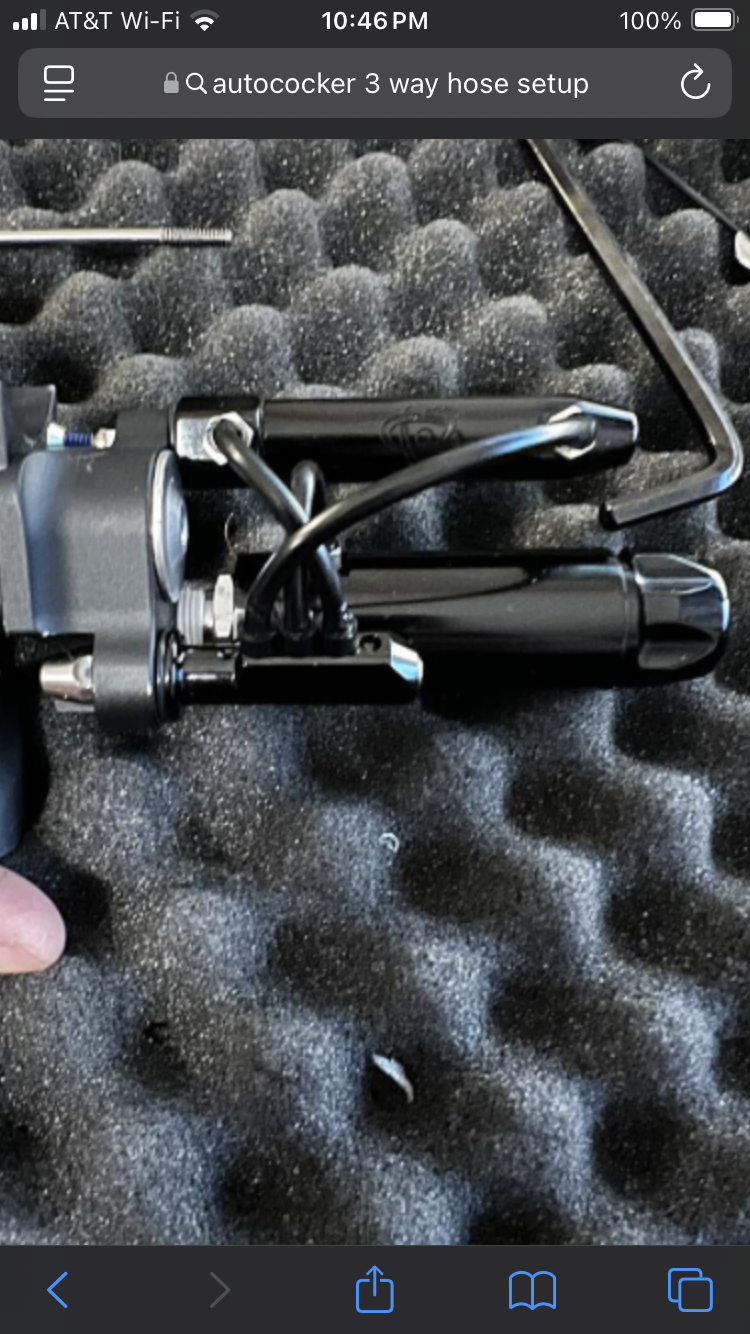

                Every picture on Google shows them correct.

                  not sure what you searched.
                  for slider frames (what you have) they should be like this
                  WELTHOUSE x Timberghosts

                    lol was i right?
                      lol was i right?
                      Well you might be right. I searched for ANS front ends and see different set ups.
                      tomorrow ill toy around with that. I thought I had it right
                      • $L!mBo
                        $L!mBo commented
                        the way you have them in your
                        pic is for hinge frames

                        Hoses... Of course. Hinge frame pushes the 3-way and the slider pulls the 3-way so your hoses do need to change depending on which frame. Once your hoses are good, follow the steps I posted and you'll be rocking that thing on the field.

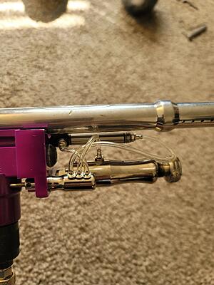

                          Even with the hoses like this ( like every other slider frame I saw on Google images) and playing with the velocity screw it still sounds like it's starving for air or like the bolt is upside down on a 2k

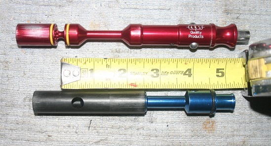

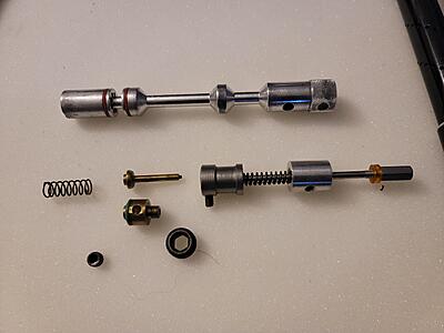

                            When you gas it up, if the following happens, your hoses are correct:
                            1. Ram sucks the back block forward, trigger not pressed.
                            2. Press trigger and ram pushes block to the rear and cocks the hammer.
                            If you are not getting any air down the barrel when you fire the gun, one (or more) of three things are probably wrong.
                            1. The valve is not aligned correctly and no (or limited) gas is getting to the bolt. If the valve has two ports, one should point directly upwards, and the other should be under the retaining set screw on the bottom of the body. Pull the set screw (not gassed up) and look and see if the bottom port in the valve is visible. You should be able to look in and see the valve pin.
                            2. The bolt is in wrong, however this shouldn't be the issue as with that type of bolt it shouldn't matter.
                            3. You are using the wrong length bolt. I.E. - A 2k bolt in a pre-2k setup, or a pre-2k bolt in a 2k setup. The back block shown in the 1st post needs a pre2k bolt.
                            The top bolt is a pre-2k ANS, the bottom is a 2k Shocktech:
