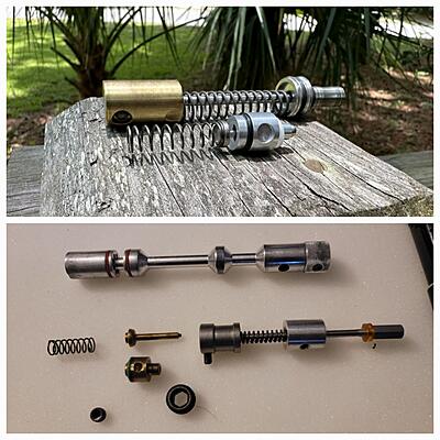

    Alright I want to drill the top of the body to adjust the hammer better. And fresh internals are only 100 bucks.
    The problem is i have the old school IVG and all these kits have the screw in type IVG. And the hammers look different too.
    can I use my old IVG with these newer pre2k kits? And will the new hammer work with my old IVG?
    Top pick is the pre2k shocktech internals. Bottom is my old Sheridan junk.
    Thanks

    1. Can I use my old IVG with these newer pre2k kits?
    - Answer: No, the spring diameters are different
    2. Will the new hammer work with my old IVG?
    - Answer: No, same reason as above
    Solution: Get a newer lower kit with a non-threaded IVG, or have the body threaded for a new IVG.
    AKA has a non-threaded pre2k hammer/IVG kit: https://akapaintball.com/index.php?p...cts/hammer-kit

      You need a pre2k nonthreaded Nelson IVG. The Nelson ivg is wide enough for the bigger Nelson springs OD. Also it has a plunger inside that fits the ID of the spring.
      The Sheridan ivg (probably just a cap with different mounting holes to adjust depth) wont be wide enough to fit the springs.

      Also, newer hammer lungs are wider than old ones, so on my Pre-2K conversion I could not use a newer hammer as the slot on the body was too small for the hammer lug.

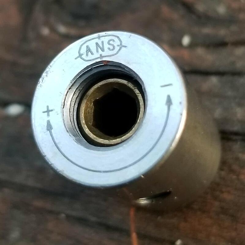

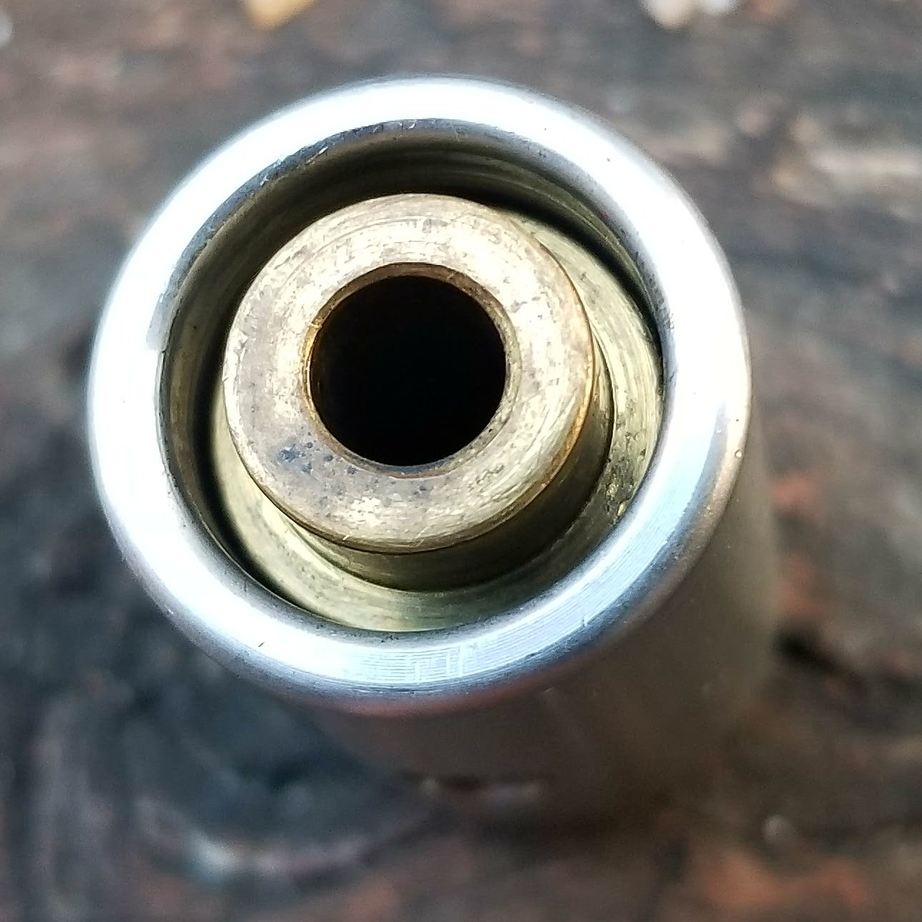

        Can I adjust the ANS one from the top of the body? I can't find another view of it online.
          These are adjusted from the rear by removing the cocking rod just like threaded ivgs.
              I ment the hammer.
              The picture I posted wasnt a hammer it is a Nelson spring colpatible non-threaded IVG.
              The ANS kit Walker posted ( https://ansgear.com/ans-autococker-n...ded-hammer-kit) includes the IVG and a hammer which has a top hole adjustable lug.
