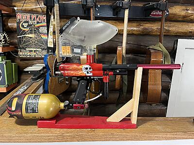

    Trillys are fun, and are great shooters, I had a POS trilly sport body someone had made a couple cuts to the feedneck on, so I had a Friend Airbrush the body, and I put wayy to much money into a $40 gun, but I love it haha...
    WGP double frame, Tech T adjustable 3 way rod, Palmers Trilogy Micro Rock LPR, Dye Lazarus Valve, Lightest hammers spring from inceptions designs, Shocktech Superfly Bolt, Inceptions V2 HPR. run either a Freak OG kit or Dye UL barrels on it. Fun markers.
    I also have a totally stock Trilly sport, that shoots great and is reliable AF too, best upgrade is a properly bore sized barrel.

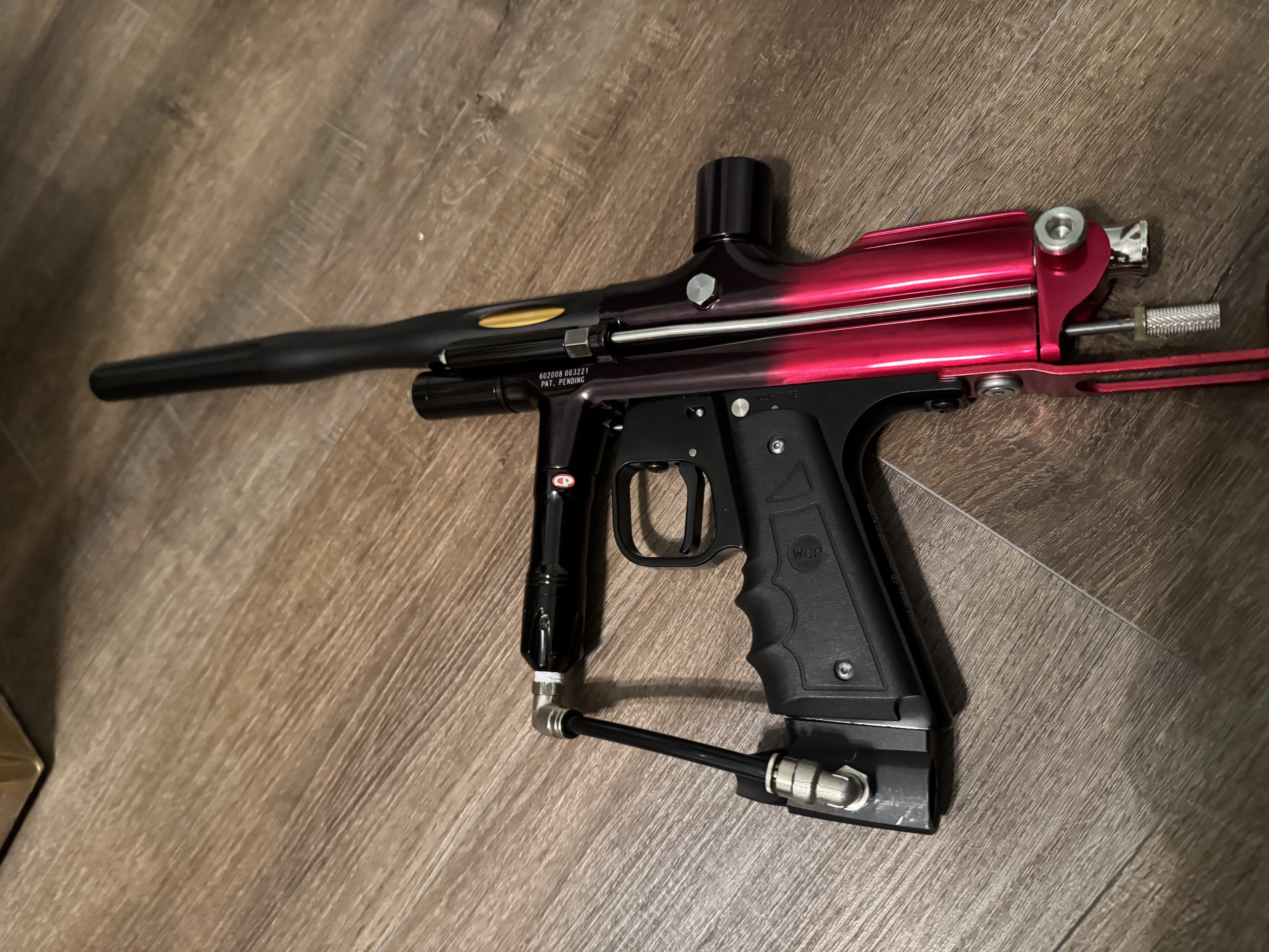

        Here's mine:
        I generally agree with the consensus. I've upgraded just about everything on my trilogy, and for the most part it isn't worth it. Most of the stock components will work just fine, and you'll see little to no meaningful improvement if you do upgrade.You're on the right track; a freak or similar barrel you can underbore, an on/off ASA are a great start. I'd look at at doing some sort of clamping feedneck mod as well.
        From there, a lot of people (myself included) prefer slider frames instead of the stock hinge. I actually really like the stock hinge, and slider frames are more complicated to set up (what internals to use, getting the proper glide screws, etc), so don't feel like you need to swap that out. But it is a reasonable thing to do.
        A lot of people recommend externally adjustable regs... I have them on mine, and it is convenient. But you're looking at around $100 for something you'll rarely mess with. The stock regs perform very well; they're consistent and reliable. This would be one of my last upgrades.
        Bolts are another one I'd pass on. You'll probably get a tiny increase of efficiency with an AKA Lightning bolt, and they're lighter so theoretically you can lower LPR pressure and get less kick. But eh. I'd do this before regs, but it's a veeery low priority.
        Valves are a tough one. I swear up and down that the morph valve (and likely the laz valve, similar product) is the best upgrade you can make to a trilogy, but they are not easy to set up. They require a high-level ability to tune. Once they work, they're uuuuh-mazing. But it's a lot of work to get there. Being new to cockers, I'd avoid it. Regarding other valves, be it CCM, AKA, PPS, ID, or Shocktech, I'd say nah. The stock valve does very well when tuned properly. And stock, they're basically there. Just be aware that the stock springs degrade pretty quickly. Your velocity will slowly go down beyond the point of being playable. So you'll need to replace them eventually. I did the morph valve when I hit that point.
        So yeah; ASA, barrel, feedneck. Play with it, adn decide from there if you want a different trigger. From there, I'd leave it alone and just play with it.
        Two small tips; #1 the back block is set too close to the body from the factory. I broke a bolt pin because of this. Take the bolt out, take the cocking rock out, and turn the back block out one full turn. You'll be good to go there. #2 the LPR is also set very high from the factory, making it a bit rougher on paint and a bit kickier than they need to be. I used to remember the number of turns it took to sweetspot it, but alas, no longer. But yeah, sweetspot the LPR and it'll shoot a bit better.
        My trilogy is my all-time favorite gun, even compared to $2000+ custom cockers. Part of that is nostalgia/sentimentality, as it was the first gun I bought myself. But they're also just better guns tbh.

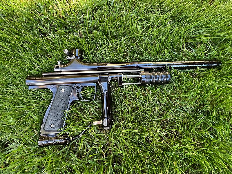

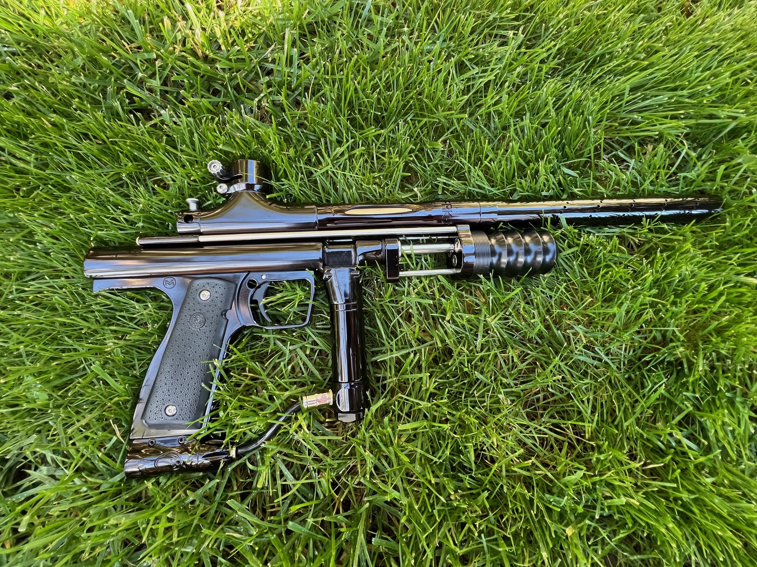

        trilogies are fun to build. Here is my last one. halfbocked with a well modified laz valve, inception hammer. This operates at staggering 135psi @ 290FPS. *I can not reproduce that low pressure on any other marker.
        Last edited by latches109; 12-12-2024, 12:53 PM. Reason: Derek Zoolander's Center For Kids Who Can't Read Good
        • latches109
          latches109 commented
          Super light 2” spring, IVG flush. I have taken the exact lower tube and put it in 3 other markers all 170psi and up. It goes in this one and like magic is back at 135. I don’t know why yet,

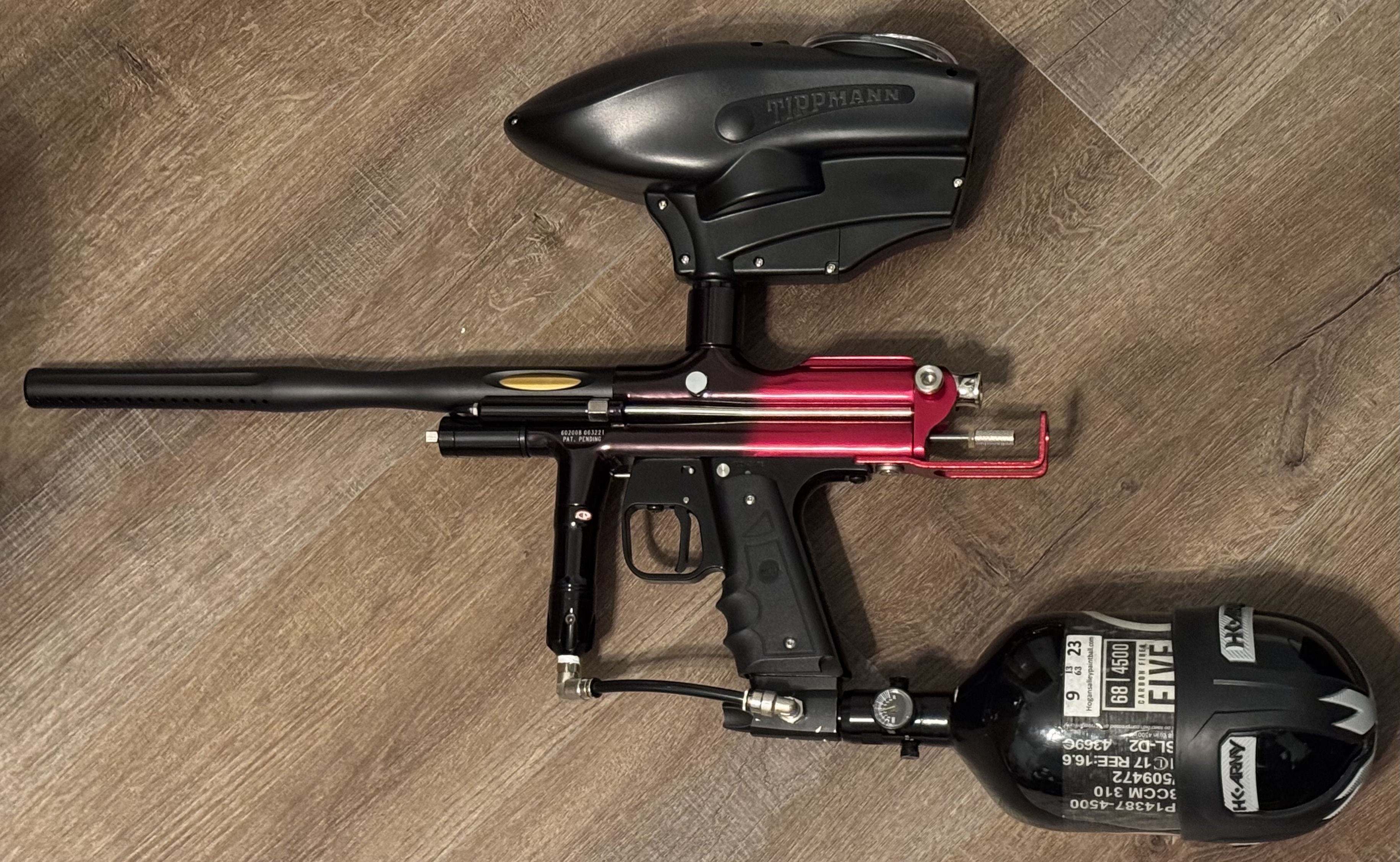

          Been enjoying my new to me WGP Trilogy Comp! I’ve put about half a case through it so far! Other than a CP reg, macro line, and a Gog Extcy on/off Asa I had laying around, it’s fully stock. I intend on getting that new CP regulator sweet spotted and potentially doing some upgrades in the future.
