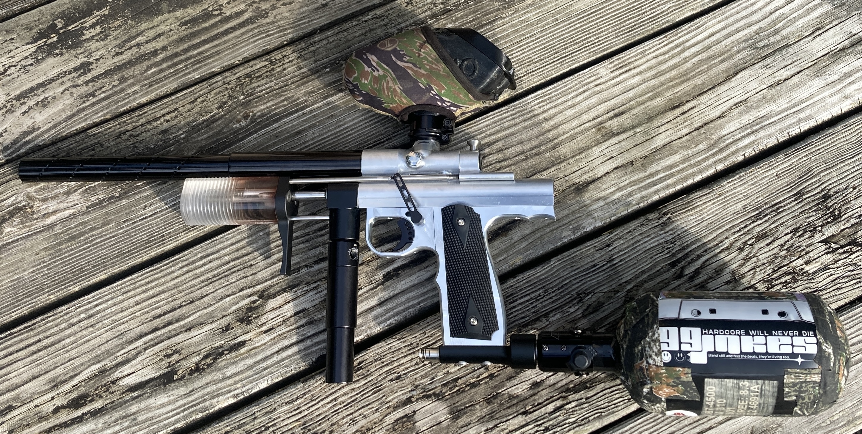

                      maybe not helpful but,
                      i stole the single groove idea for this thin 86, which i like more than the FF
                      WELTHOUSE x Timberghosts
                      my feedback
