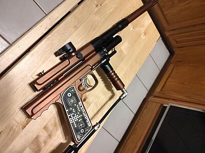

      I'm surprised so few people have mentioned the Resurrection. Other than its lack of an sight rail, and the need for Simon's hammer fix, I thought that one was really well refined.
      That's a good point. Out of the box they are pretty good.
      Originally posted by Frmrspec
      minimag03 this one?​
