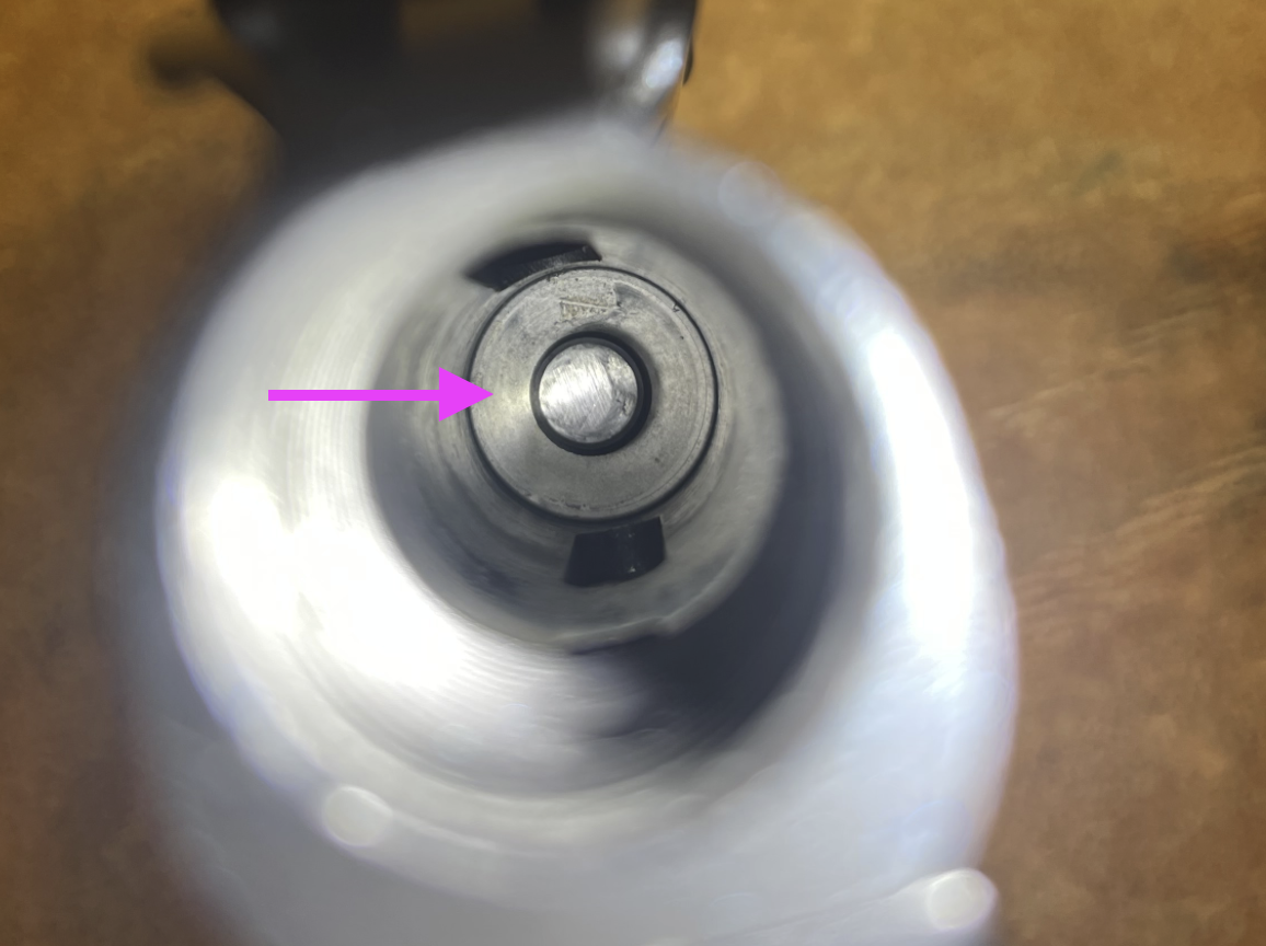

    Ahh sounds like he is just smacking the spring perch and not the face of the valve
    Try to get something though the hole on the front a see if the valve moves then

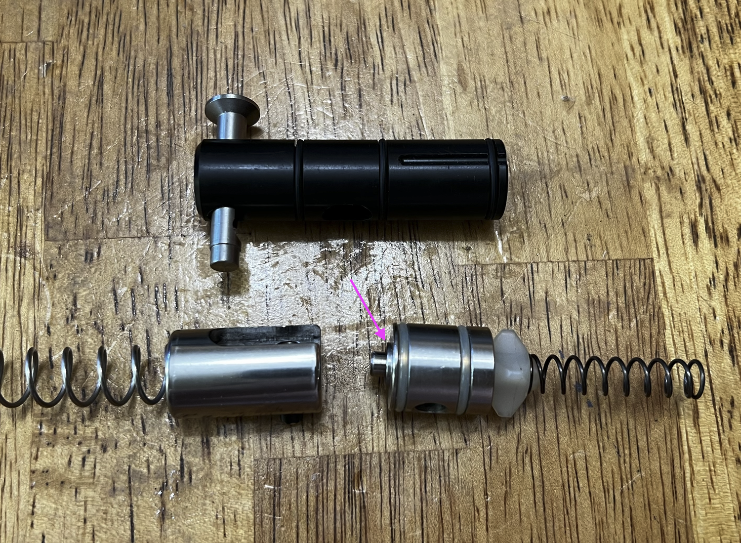

      looking at the photos posted with more light.
      stock resurrection valves have a lip. Older inception valves do not. your picture shows no lip. The cup seal seems to glow like a semi clear cup seal like inception as well. Also, in the background of your image I see a blurry inception bolt and hammer. Resurrections had terrible tolerances, a stuck valve does not surprise me.

        #20
        Thank you Latches yes the hammer and bolt are inception. Looking in through the front I can see a spring and a whitish plasticky piece inside the valve which I’m assuming is some kind of seal. I just don’t have the more traditional cup seal and valve spring in front of the valve like in your picture.
            I don;t see any scratch marks going in, so it's probably just gunked up urethane orings. two options, make an air gun, plug and pressurize the cup seal side, OR thread a chopstick down there and whack it out.
