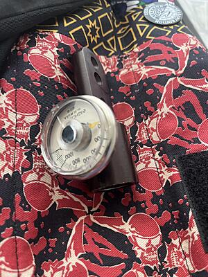

      I put an old huge 1000 psi reg gauge on an old duck bill ASA that was heavy and I would never use. I never thought to do this until recently and it helps allot to “zero” my regs out at 350 psi after a rebuild to know where I’m starting from.

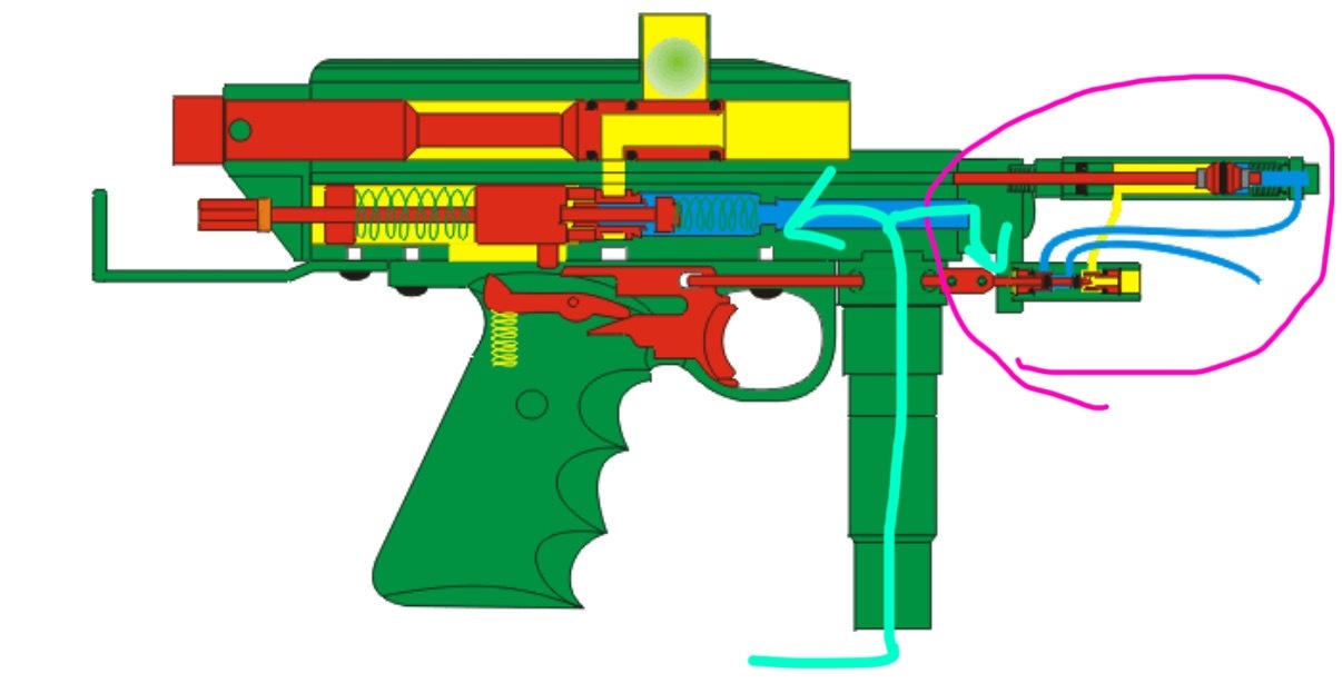

        the LPR (circled in pink) sets the pressure for the ram = cycle speed
        the blue green arrow is the HPR and sets the pressure for firing the ball.

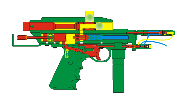

        Here is a cutaway of the autococker.

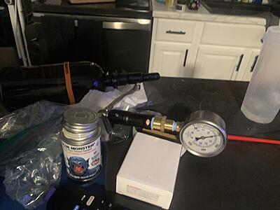

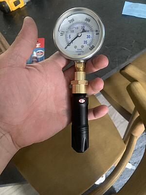

            Sorry, life shit has really hit the fan on my end. Thank you guys for the insite here. I have a reg tester I made for testing the regs on my tanks. I'm waiting on other parts to arrive in the mail. In the meantime, I can pull the CP reg off this gun and test it.

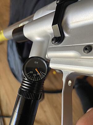

                  I’m a fan of the CP gauge adapter. It’s just a $20 piece to add any 1/8” npt gauge or transducer between the HPR and marker.
                  Used it for a lot of regulator recharge testing and checking operating pressures while setting up markers.
