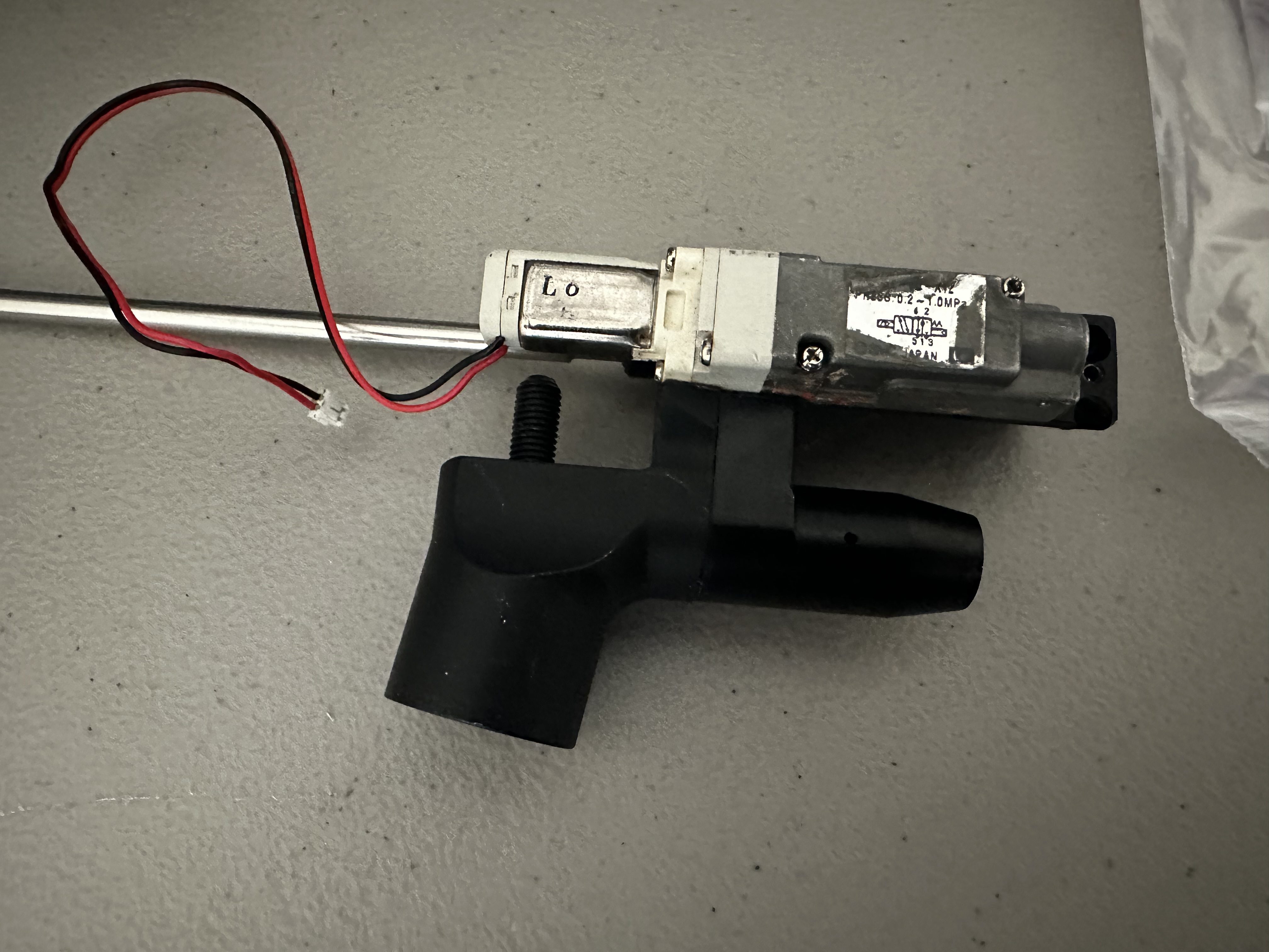

ID:	727689 .....I think i have a whole front block i could sell if your interested. yes for a sr cocker.

      Thanks Jake, that’s probably overkill for me since I have a complete front block other than the solenoid, but what are you asking for that?
