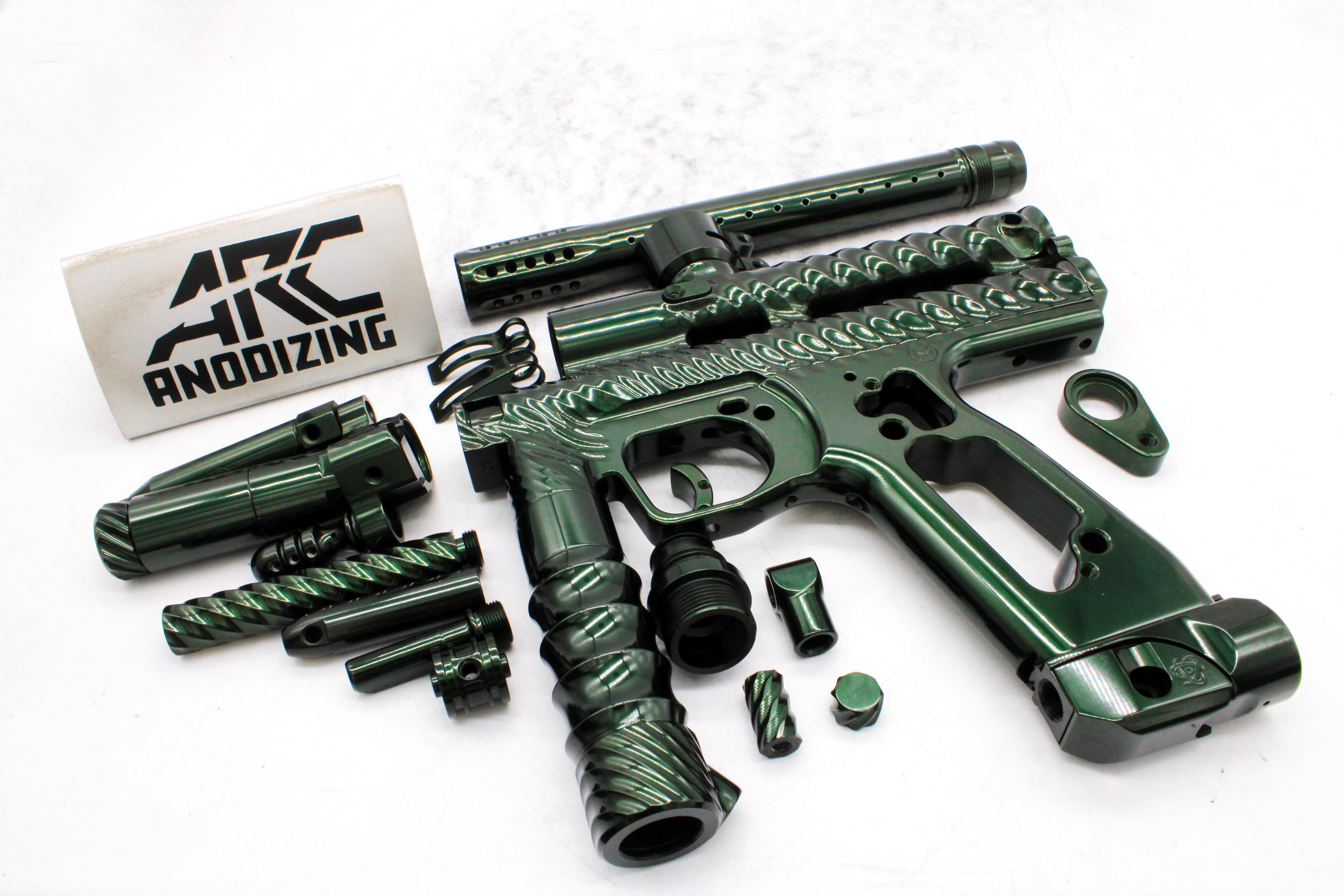

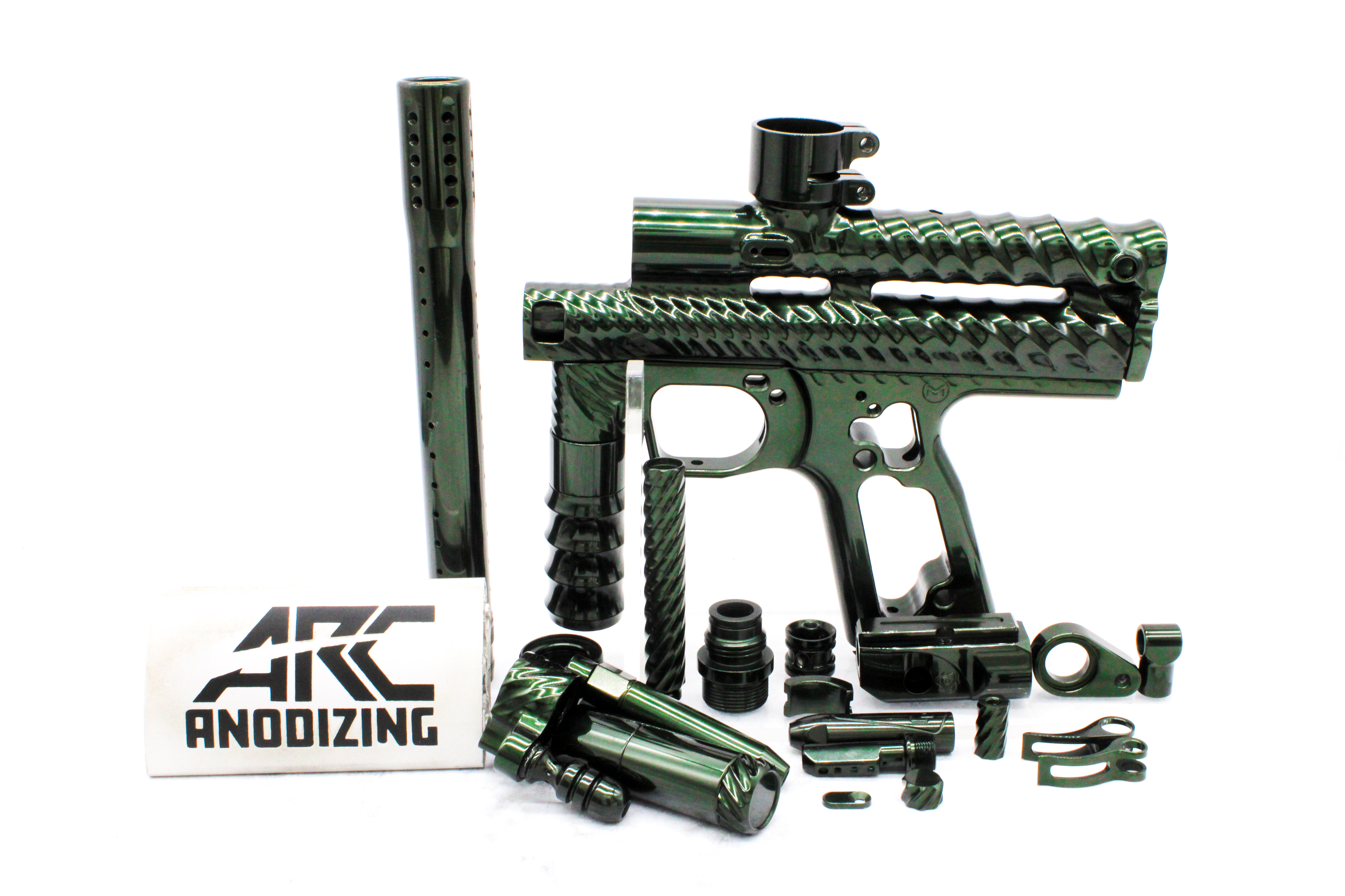

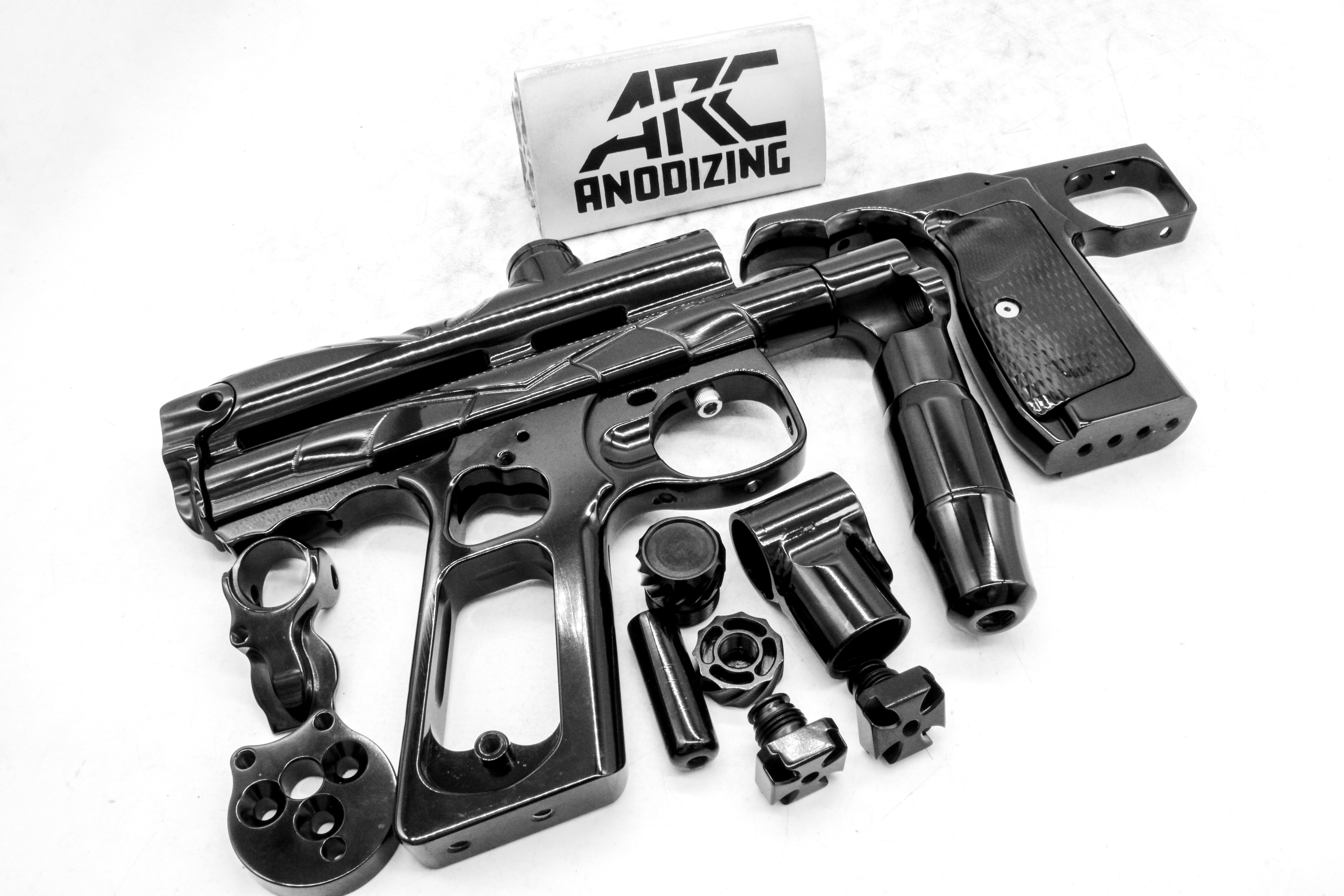

    Hot off the press….. (Shout out to ARC). I had enough parts done to give me a few options, will update the thread with more pics/feedback as I start the build

    hopefully you checked the frontblock threads before ano but it looks great… i’m a huge sucker for anything green

      Should have gotten the attktx twister pnumatics. I love a good dark green
        • 6380

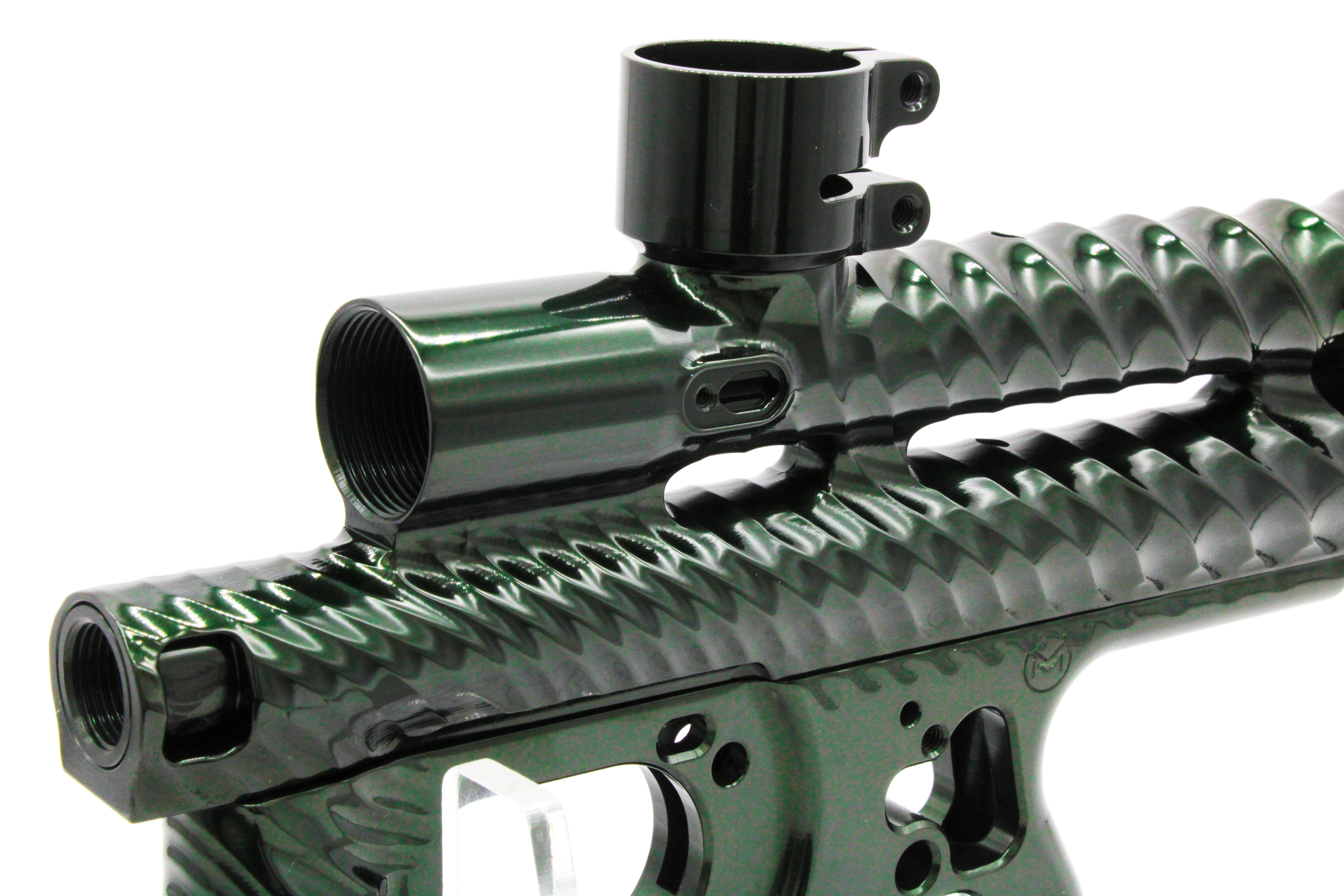

        Dam that is Nice! Wow I can’t wait to see it together that Green is really clean looking. That gloss finish is really well done.

          Turned out great!
            is that an issue that people are having? I did some mock ups and didn’t notice any issues.

              im pretty sure there was an issue with pneumatics threading into the front blocks. I know people were mentioning Shocktech pneumatics in particular. but it was only the first batch of bodies sent to customers
            I did order them, but found out it’s going to be a few months before they even start shipping and I didn’t want to hold the whole project up - ill likely send them to get color matched once they get delivered. I’m with you on dark green, I’m always surprised how few of us are out there!
            thank you sir! I wasn’t super impressed with the quality of the raw finish quality; I’m glad ARC was able to clean it!
              A lot of raw kits come like that. Looks like they did a great job cleaning it up. I love how deep green the Ano looks. It’s nice and dark with the high gloss it looks really nice!
            Yeah, the first 125 body kits released came with varying issues with the front blocks most specifically the 3 way threads being incomplete or missing completely

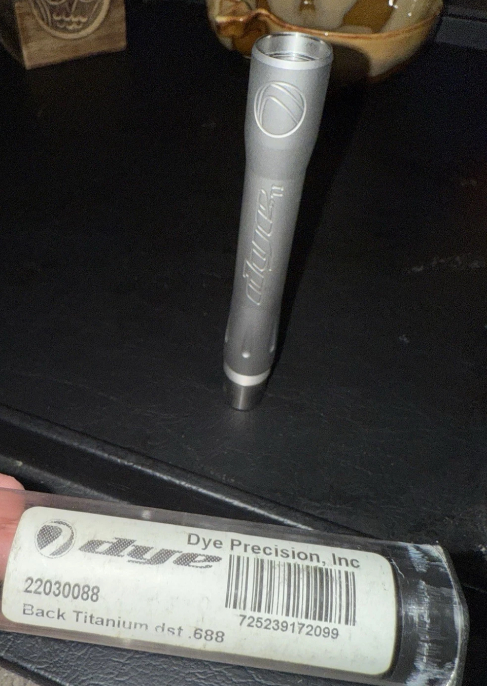

              what barrel are you running? I have a f 6 ready to build and didnt get in on the uli twister back

              I’ve been saving this bad boy for the build, curious to see how it looks when it’s all put together. Otherwise it’ll be CF UL or ULI.

                i don't think the UL-I is compatible with your matched tip. Only standard UL, Proto, and UL-S baccks will work (UL-S makes the barrel 15" in length.
                Master Sconi also offers the Oil Can Freak back that uses Dye tips if you want to use an insert system with it. It's actually my fav Freak back because it takes advantage of Dye's self-aligning design.

                Great choice ano. A lot of people go off the deep end when anodizing super high end cockers. It often obscures the milling. but the lines on yours is perfectly visible.

                  Thank you - I am not really a fan of super flashy, I wanted to keep it simple, like you said, let the milling be the star of the show.

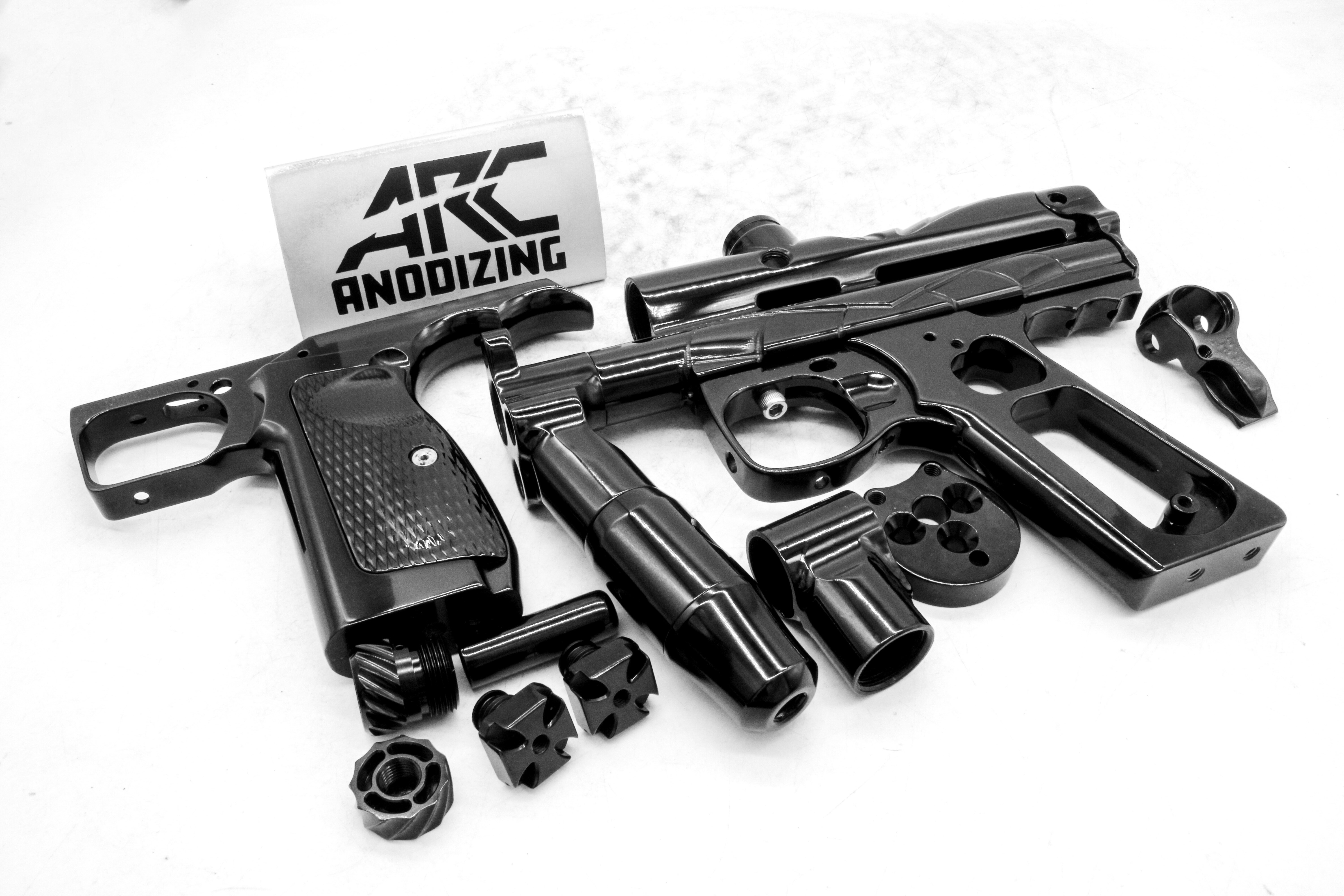

                Here’s the other project ARC did for me along with the F6

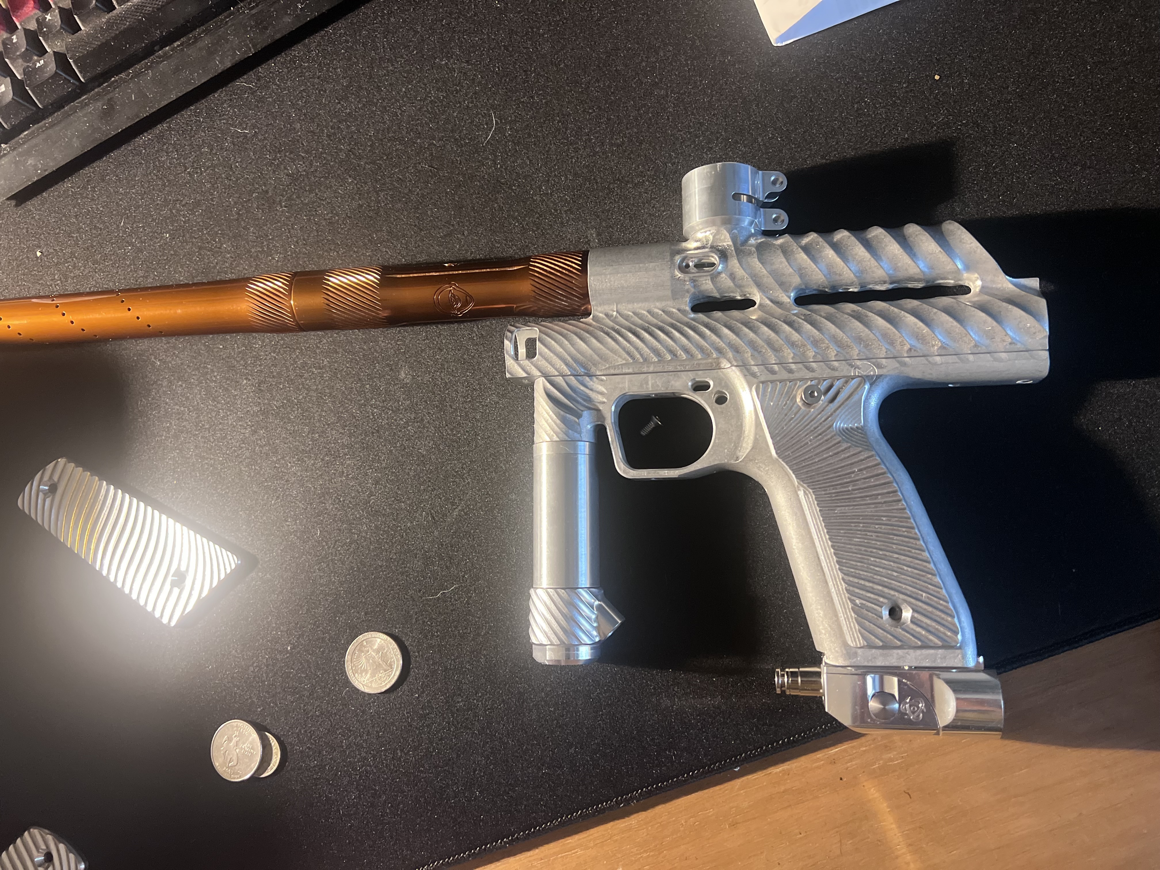

                  i just snagged this freak barrel for mine that kinda works with this body for those who don’t want the crazy milled ones
