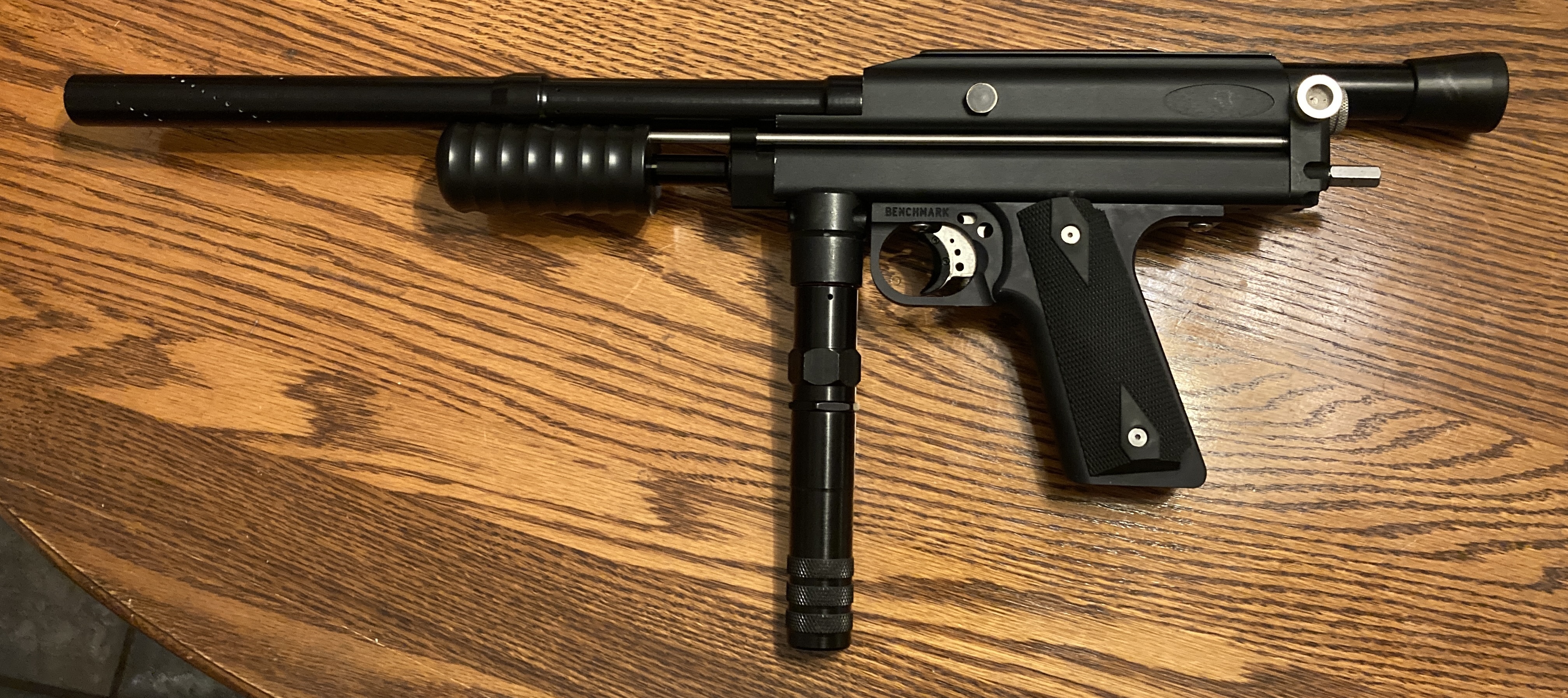

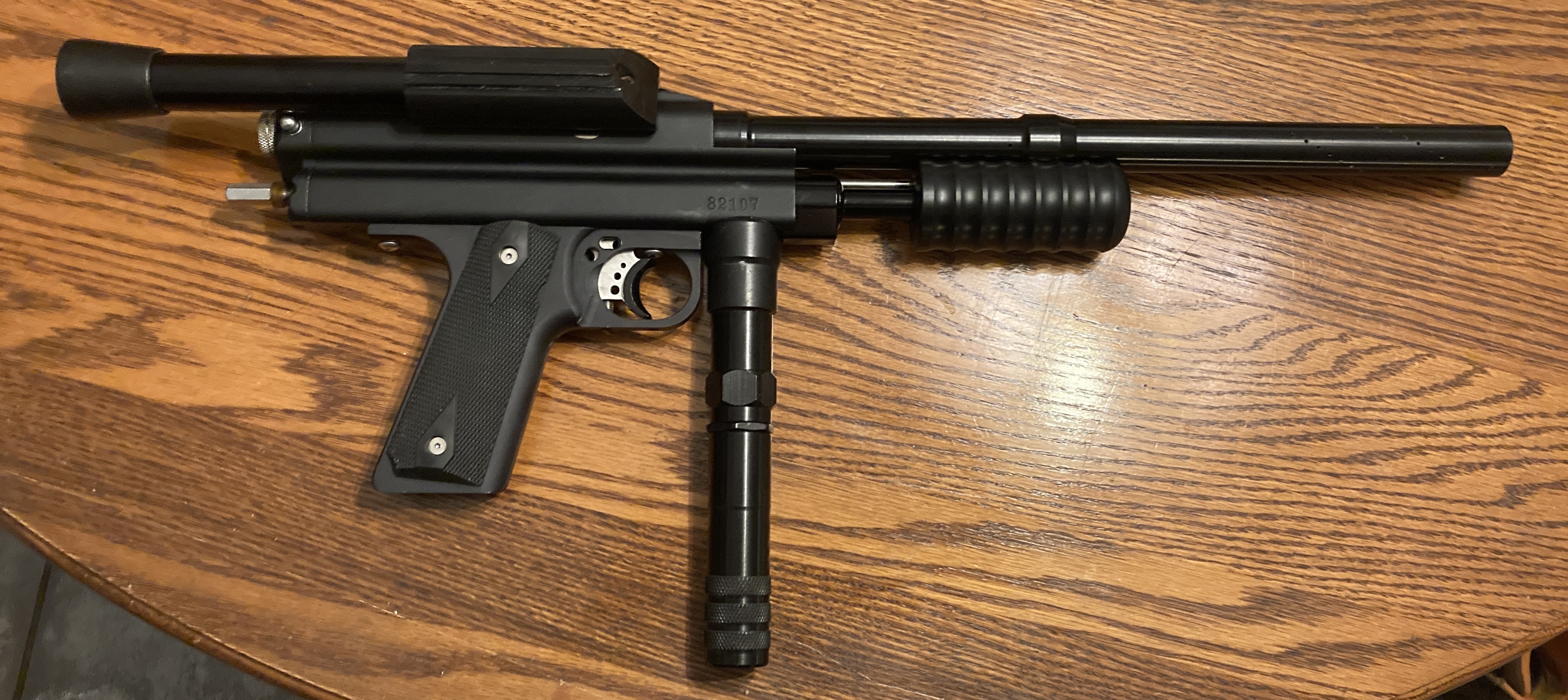

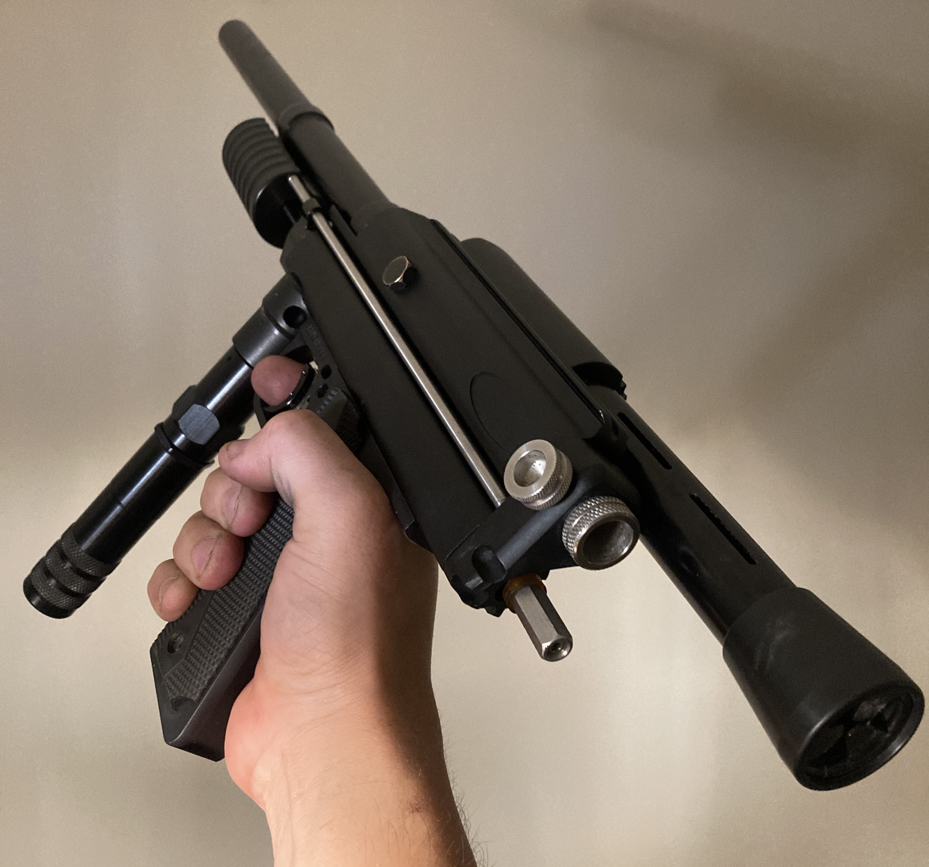

    heres some pics of my sc modded rf with the cci/ev 2 piece phantom feed.
    another point id mention is:
    if youre running a bottomline setup, find some stainless braided line and swap your asa for a duckbill/screw in without on/off style. its a good thing that stainless braided line and the screw in, simple asa s are super cheap, usually "throw away" parts
    some folks have no issues but with my testing, i got more shots per 12gram just changing those 2 things

      I kind of want to build another sc cocker with a CCI feed after seeing yours. I have all the parts so maybe it will be a winter project.
    • $L!mBo
      $L!mBo commented
      BLachance75 ive done 6 of them at this point, its super easy.
      i like to crank the neck out with pipe wrench, tape the phantom feedgate on, lined up where you want it, 1/4 punch thru the mounting hole and then drill the pilot hole with it all still attached to keep the correct angle.
      then i take the tape off to drill to size, tap, and clean up the burr inside the top tube.
      10min tops using a cordless drill and hand tools
