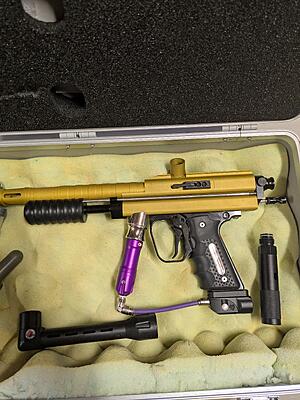

            I totally forgot I had an image of the marker in question.
            It's got a CP regulator, which operates at too low a pressure correct? I feel like I should switch that.
            9/16 rat valve
            Inception trident bolt
            Original springs lolo, so I guess I need some stronger springs?
            I'm also going to get a different trigger and frame when I can

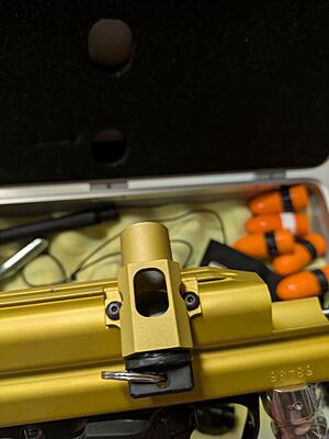

              Dose that feed neck mount with two screws? You might be able to bolt a phantom feed directly to it just by unbolting the feed neck. Got a picture of the other side.?
              Dude you should consider selling that frame, those are worth $$$ and snipers are best with a single trigger anywho

              Ooooooooo boys, she's got two nuts
                • 6380
                Yup pull those off bolt on a Phantom Feed directly and you have a great body to build a right feed Stock Class body already.
                I would get a tight bore barrel that one is likely large bore. Look for something in the .681 range. I like one piece J4 has singles one piece ones for $35 they are awesome!

                You could likely sell that frame for a good amount and pick whatever design you want unless you prefer that style. I like a good single trigger on a pump myself. If I had a choice I would do one of these with there new Roller sear and trigger setup. Maybe do a dust black on the dust gold theme to avoid having to Ano anything.

                See how the stock internals perform before you go changing them. You might get away with just a spring kit and some tuning. Give it a good cleaning and lightly oil it. See ware it’s at.

                  Are the screw holes in the same locations and do they tend to be same thread?
                    Same location not 100% sure on the thread. It will mount with a single screw just like a Phantom.
                    You may need to adjust the screw length I can’t remember but you probably have one of the easiest body’s to convert to stick fed.
