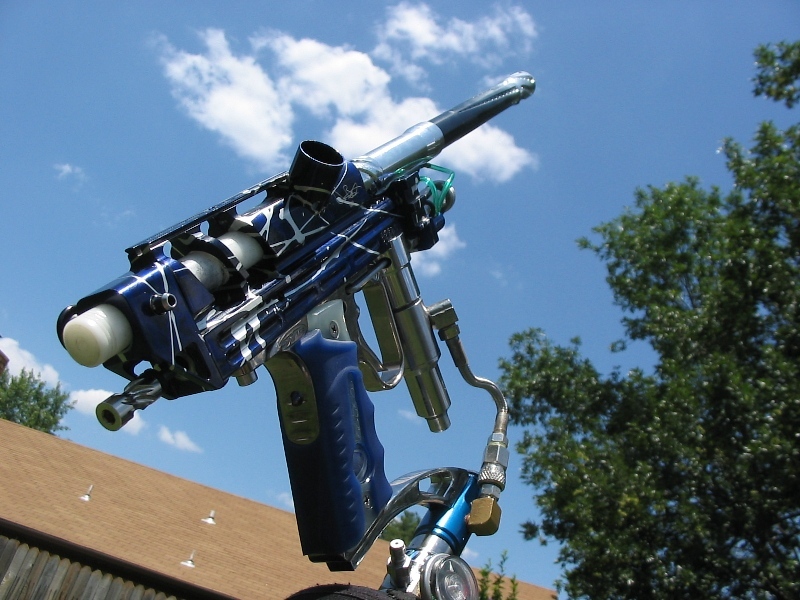

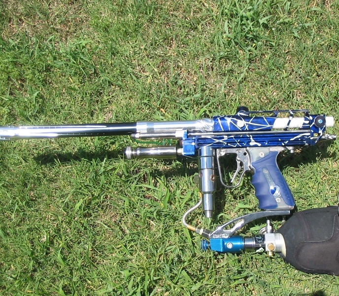

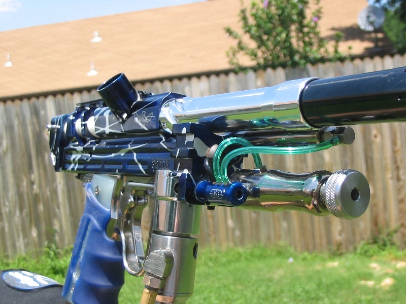

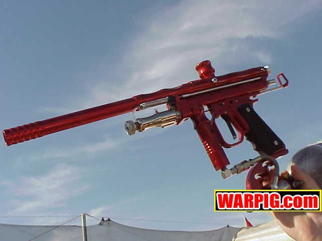

              Sound like the red one is a first gen, should and a rather low sitting feed neck that press fit.
              No picture but before the Signature Series there were modified wgp gun and "Bonebrake" milled though the top tube
              -Gen 1 Signature Series 2001
              Left side Bonebrake in oval
              Low siting press fit feed neck
              Ans pnues and early macdev HPR
              Metal Bonebrake bolt
              Maybe ans internals also
              Modified benchmark slider maybe option of wgp hinge, 25 or less with the slide frames
              Option of full cp barrel kit
              -Gen 2 Signature Series 2002
              Bonebrake milled on to the right side, like the one in the picture above
              Feed neck changed since gen1 neck were pulling out when people stuffed halo hopper in them. press fit with thread top but its special Bonebrake thread and they never made a camping neck... Has a B milled into the neck and much taller
              Ans pnues and early macdev HPR and LPR
              Bonebrake internals
              Wgp hinge w/ Bonebrake sear moved away from the slider triggers
              Cp barrel kit option
              -Gen 3 Signature Series
              Feed neck changed again to standard cocker thread and came with ccm necks
              ans ram(?) macdev LPR and CP HPR
              Bonebrake internals
              E1 or maybe Wgp hinge w/ Bonebrake sear
              Cp barrel kit option maybe?
              -Misc Info
              ~160 or less guns, 2 have been half by rlong of turtle innovation
              Body milling is basically the same, except for the Bonebrake name
              CP did the milling and ano
              Local machine shop in Salem Or drilled for the eyes if they were factory
              Couple of gen2 guns running around with ans race frame those were team guns for a team in Oregon, supposedly the eyes are not drill to good.
              Last 6 sold were the acid washed w/ e1's
              Most the gen 2 and 3 are single color, the gen 1 I have seen are fades
