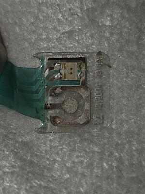

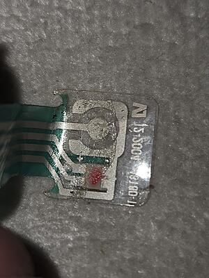

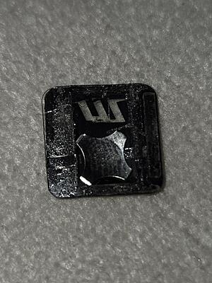

            Ok, I relented and pulled the membrane off. I don't see anything suspicious but I could be wrong.
            The logo looks like a stylized VJ I think. The numbers 12-2004 48180-1.
            Edit: the connector on the other end says HX-543
            This gallery has 3 photos.
              Try cleaning off the back of the button, and its corresponding contact points on the ribbon. Use isopropyl alcohol. 91% should be good enough. Hopefully all the discoloration is just gunk or residue, and not burnt traces. Looks like the 4 points of the button contact that U- or C-shaped part, and pressing the button completes the circuit with the dot in the center. You could test it by just jumping the C-shape with the center dot using a wire.

                I was able to put a volt meter to it this afternoon and there's no continuity between the switch contact and the connector. Jumping the C and the dot does nothing. I was able to get it to turn on by jumping the pins on the board and noticed yellow led lights up but the red doesn't. The ribbon is definitely bad. I guess I gotta get familiar with membrane switch manufacturers now.
