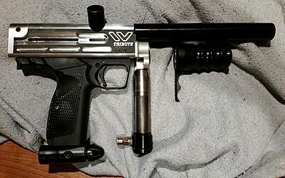

    Seriously, I can't be the only person to think of such a thing. People have done so many crazy configurations with Autocockers, it has to have been done at least once.
    Found it. Here is the one and apparently only:

    That gun hasn't been midget'd. A midget body would have the body trimmed down to the rear frame screw like this
    They're not very popular because it removes a lot of your ability to tune the gun due to the shortened length your hammer travels.

      You are right, the one in my picture just has an elongated frame... like a built-in snatch grip/beavertail.
