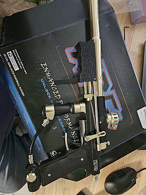

          • Sasquatchia
            • Apr 2024
            • 7
            Found a kpc+ 3d printed pump handle and had it printed in petg, feels so much better and lighter than stock handle, also snich in a lazurus valve
