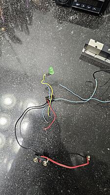

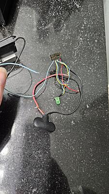

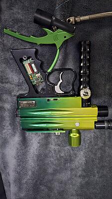

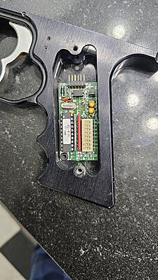

    Hello! This is my first post on this site because I am finally trying to get back into the sport. I played back in the 90's and 2000's but my Defiant(1st gen bushmaster) needed some repairs and then the whole scene fell apart in my area after the guy who was connected with the league in my area got arrested for some shady stuff. Kinda killed the whole vibe for me and I stopped playing between needing to do a repair and knowing i would have to drive 2hrs+ to stay on a tournament team. My on/off switch broke and then one day when i was taking the switch out to replace it, the solenoid slipped and yanked the rest of the harness on the floor. I already replaced the switch once, so it has a blob of solder(i was very young so I know it looks like trash LOL) on the power wire and then the solenoid had one wire come out of the harness. I was hoping someone could help me out and make sure I wire everything back up correctly and test to make sure everything is still running good. Here are some photos of the wire loom, the "lower" where the chip is stored with photos of the chip so you can see there is no damage to it, and a photo of the gun with the parts I have left but I kept all the original stuff and sold my aftermarket barrels and tanks when I stopped playing. If anyone wouldn't mind confirming/helping me make sure I rewire the original ICD rev 1.01 board with all original parts. The caps are still good and the board has 0 rust or damage to it. Only thing im scared of is maybe it got shorted when the switch was messing up and it could have damaged the board but i think it was more of the fact that the solenoid had a wire coming out that I didn't notice at the time. Was very young and didn't know near as much about electronics and tinkering as I do today so I would have probably fried it before I even got close to fixing it back when I was 15-18 and playing matches with that gun all the time. I'm not even 100% sure the LED is working or not right now so I am going to have to use my voltmeter to check when i plug everything up to make sure it's still good. I don't want to run a hot to a bad terminal and fry my board so please let me know how to approach this and fix it. I have tons of breadboards/wires/pins/etc I use for IoT/electronic tinkering so I probably have everything except the actual power switch on hand right now. The wires broke off of the trigger switch so I need to make sure I have those wired correctly and not backwards as well. Here are the photos and I hope I can get some help and thanks to anyone who lends a hand!

    This might help a little bit:
    https://www.mcarterbrown.com/forum/p...rebuild-thread
    Myrkul is a wizard for this markers. Post 27 of that thread his provides a wiring diagram.

      Hey man, there's a cool wiring diagram towards the bottom of page 2: Bob Long’s Defiant Rebuild Thread - mcarterbrown.com - Best Paintball Forum on the Internet​
      From what I can see, it looks like you need to connect the blue solenoid wire into terminal 1 and wire from terminal 7 to the solenoid. The positive wire to the battery harness (terminal 6) needs some fixing up as well. You could redo the connections and heatshrink or just buy a replacement for a few bucks.
      Your trigger switch connections (3 and 9) can be tested by probing the center terminal of the microswitch while in continuity mode. The other goes to one of the outer terminals. If it beeps normally and stops beeping when you press the switch it is the wrong terminal. If it does not beep until you press the switch, then you found the right one. I'm pretty sure the voltage is so low you won't short anything if you get it wrong.​

        You can follow the diagram Cdn_Cuda a linked, OR you can just order a new one from goldie.
        https://www.vaporworks.net/?product=...wiring-harness
        I would absolutely just order a new harness in this situation....there doesn't even look like there is enough of a harness left to repair on that one.

          There is also a generic "roll your own" you can snag from DigiKey Molex 0511100850-06-A-6-Y-ND​ https://www.digikey.com/en/products/...A-6-Y/16499900

            Thanks so much Myrkul! Your breakdown is great but has me freaking out about all my other parts since I haven't taken the gun apart since probably 2007 or 2008 haha. It was running perfectly until my harness gave out and at least I already have a bunch of o-rings and springs to replace all the old ones, so hopefully it just needs a cleaning and some rings. I know that I put a few aftermarket parts on it after I purchased it but it's been so long that I have forgotten exactly what the upgrades were/companies that made them/etc. I know I changed my pressure reg's. It looks like it was a full kit that came together. It has a K in white with a black "oval" behind the K to make it show because the gauge is white with 0-1000psi and has a GIANT flathead on the faces for pressure adjustments on both regs. I know I need a new grip because mine has warped beyond use. So i'm open to buying new wiring harness and other parts but I want to try and stay as "timeframe original" with minimal mods for modern paint. It's been so long I had no idea they shrunk the size of the paint that much. I have just started working on it because I want to get back into everything and found a few fields and tourney field pretty close, even found my old jersey and playing pants and they still had the double swab quick barrel cleaner stuck in the slot on the side of the leg hahaha! Going to start walking through your rebuild Myrkul but noticed that your ICD frame has 2 spots for ball detents and I only have 1(ill probably have to swap) in my frame, did you add that(drilled into the frame to add it in) second detent? I was looking at buying an "eye/chop stopper" as people called them when we were playing but I never got around to it. All the eye's I saw back in the day only ran off the 1 ball detent and just ran wiring down into the frame to piggy-back off the board power. Also your feed neck is considerably shorter and thinner in your tutorial than what's on my marker currently. Is that an aftermarket part, or can I just chop mine down and still use it? Are the slits in the feed neck there to allow the "clamping mechanism" to lock down on the neck to hold the hopper? the metal on my feed neck seems WAY too thick compared to the one showed in your breakdown to be able to have any clamp make a difference so I don't know if I should cut it. I have no issue/problem machining my marker, I just don't want to go cutting on something that will destroy the marker/part without me understanding why im cutting it(very hands on learner so photos and actually doing it help a lot). It appears that my marker was either the first or second gen's before they worked out some of the issues because I do have a delrin bolt but it doesn't have the double detents and the overly tall feedneck. I have a big event this weekend so I won't really be able to get into the gun until next week most likely. If photos would help you identify what upgrades I have vs what is still stock on the gun, I can provide those. Opus, I was thinking of building my own harness since I assumed due to the age of the gun there wouldn't be any parts out there, especially something like the wiring harness for the stock board. I even looked at installing a rasp pi board or something like that and program it myself but I decided against it because I was trying to stay as original as possible because I could just go buy an Angel or a new marker and it would have the bluetooth and all the fancy shmancy stuff that I would install on the custom board I would install anyway. I don't want to go cutting on this frame to install and LCD screen on it or anything like that. I want to try and keep it as original/time period correct as possible. Thanks for the help so far and going to start with some of the breakdown over the next few days/weekend as I have time since this is an extremely busy weekend for me. Found my old manual and started dying laughing.. in one of the descriptions of checking for leaks it says "hear a leak down the barrel? remove all pressure from the gun and then put your ear next to the gun. still hear the sound? that's the ocean." hahaha!! Man I miss this. Can't wait to get back into it and get back to my tourney days!!
              It will definitely need all new "o" rings, there is a solid chance the cup seal is still good, and those are still available from ICD. The reg seats are going to be the big question, since those are becoming difficult to find now.
              Both the pictures you have already posted and the large flat head adjustments means this is running stock ICD regs, possibly with some internal updates/aftermarket parts in them.
              Everything looks to be stock.
              Vaporworks has Bushmaster Chaos Boards still avalible. They are affordably priced, and have all the adjustments you would ever need. Rate of fire, firing mode, dwell, etc. etc. Vaporworks started in 2001, so a chaos board would still be period correct too.

                I am partial to the Morlock boards from curt https://www.morlockboards.com/ . If you want all of the led screen, bluetooth, wifi, stuff it is a wonderful "universal" board and have put them in a few bushies.
