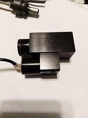

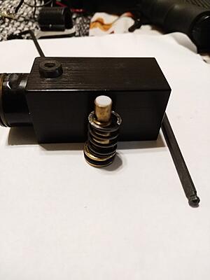

      I checked the spacing with digital calipers and here are a few pictures.
      The hammer catches when i press the 2 together with the spring.
      I've read the manual again and it said that the rm operates at 700 psi to get 300fps. Does that mean my hpr is too low of a pressure to force the valve closed and allow the carrier to catch the ram?
      This gallery has 5 photos.
        I. Am. Canadian. 🇨🇦
        • 3514
        Even Brass Eagle got some stuff wrong.
        RMs operate at around 400psi. The gun requires pressure behind the cupseal to allow for the carrier (threaded onto the ram) to latch up with the hammer, and enough LPR pressure to drive the ram.
        It's possible the LPR is having issues. If the ram sleeve isn't pressed into the front of the lower receiver all the way, you will also have issues with cocking.
        The hammer latch does look worn, from this angle.
