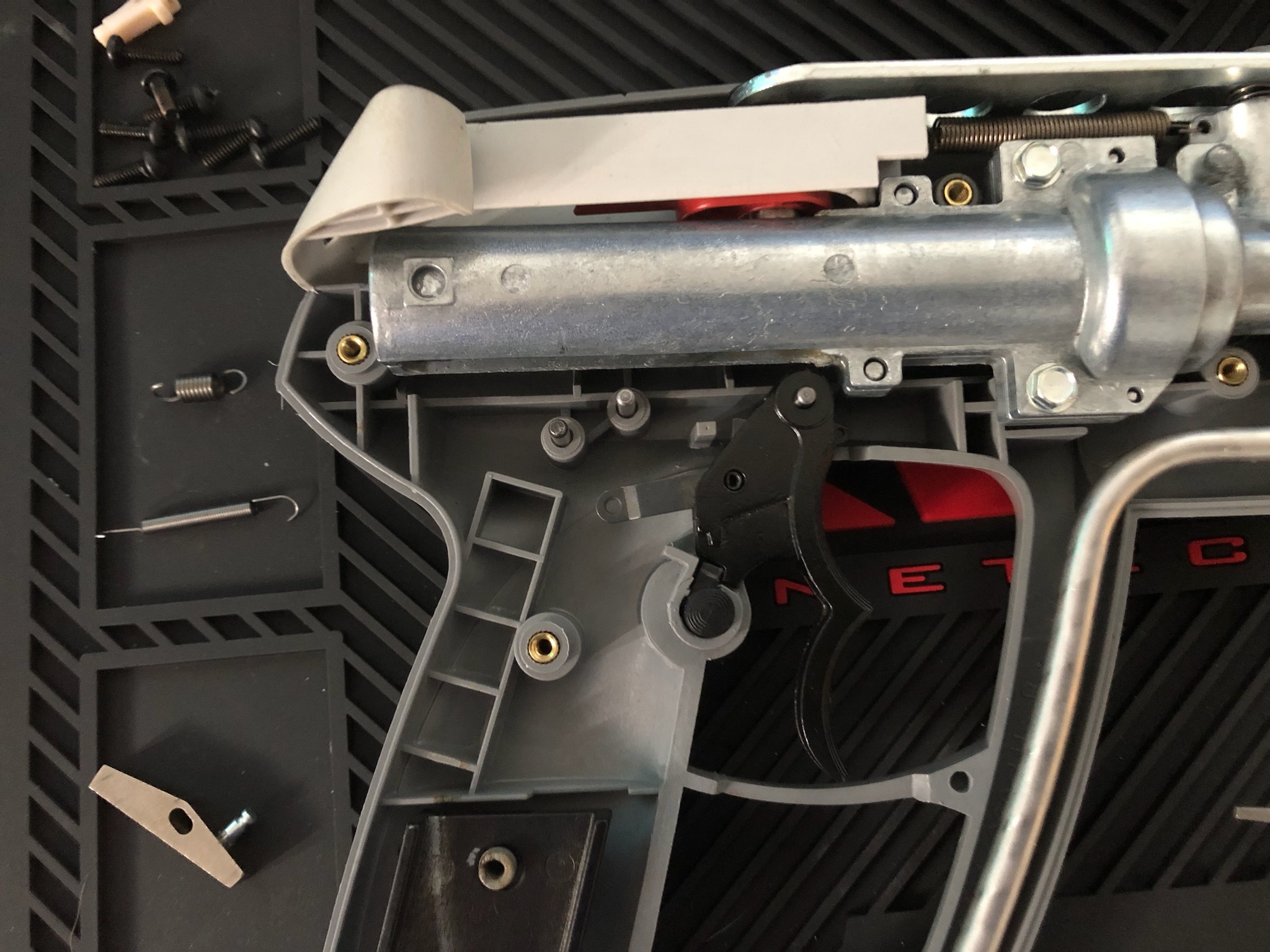

    Does anyone have a pic of the inside of a Samurai?
    I'm baffled by how the two springs and sear and trigger are orientated. It sprung apart on me when I opened it, and now I'm not sure where they go exactly.
    The online "diagrams" are useless.

    This is what i'm looking at. Not sure how to orientate that sear, nothing seems to look right or catch, or those two springs.
    It was completely seized up otherwise I'd have never cracked it open.
    "What could go wrong?"
    Click image for larger version  Name:	Samurai internal.jpg Views:	0 Size:	635.4 KB ID:	508451

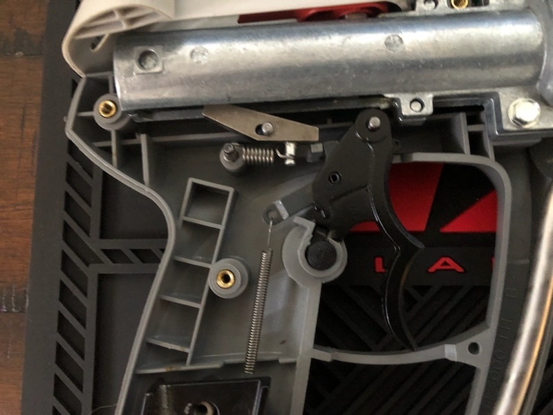

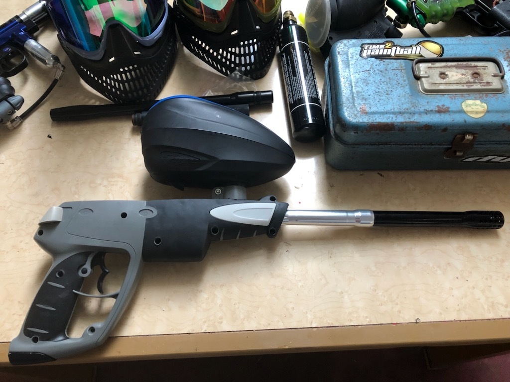

      Looks like the only reasonable way to mount them, but It would not cock, and then the charging handle decided to snap. I wanted to do something like the second pic. But at least I got a stubby Cocker barrel Click image for larger version
Name:	Samurai sear spring orientation.jpg
Name:	Samurai with long barrel.jpg

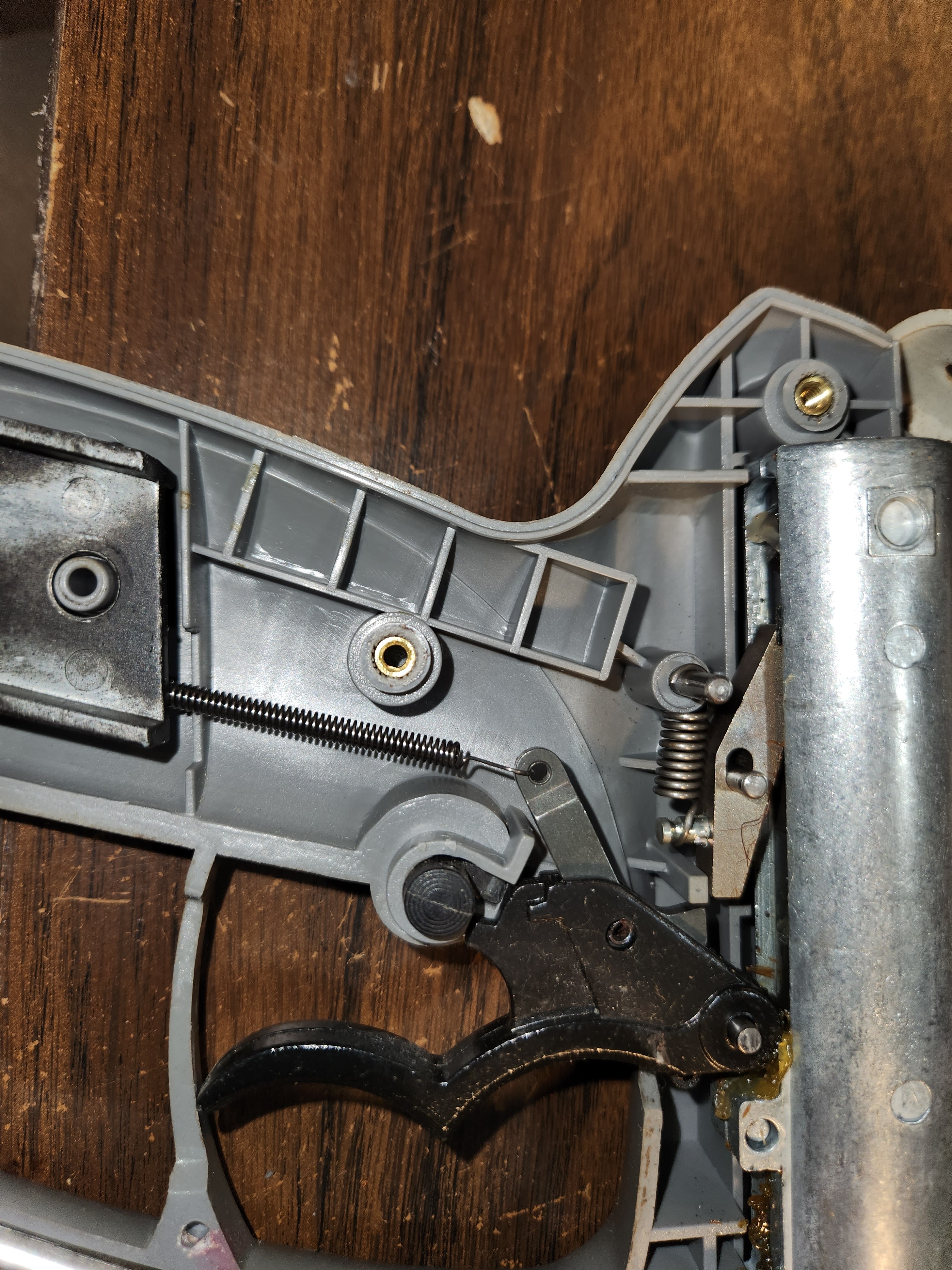

        I broke out one of my Samurai, to see if I could get you a picture. It was seized and not working. So, I rebuilt it. What a huge PIA. The engineer who designed this should be beat to death with it. It's running now, but Holey Crap what a pain to sevice.
        • Garyfu.70
          Garyfu.70 commented
          Ah, thank you. looks like I was on the right track there. Appreciate it.
          Now I wonder if the reason it wouldn't cock back fully is the charging handle was giving way and flexing.
