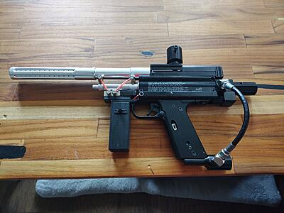

              Here's how she sits currently. The 9v compartment is temporary until I take power from the hopper. I likely won't get much more done for awhile since we're closing on a new house... But then I've got an idea for a new grip frame and HPR/LPR setup

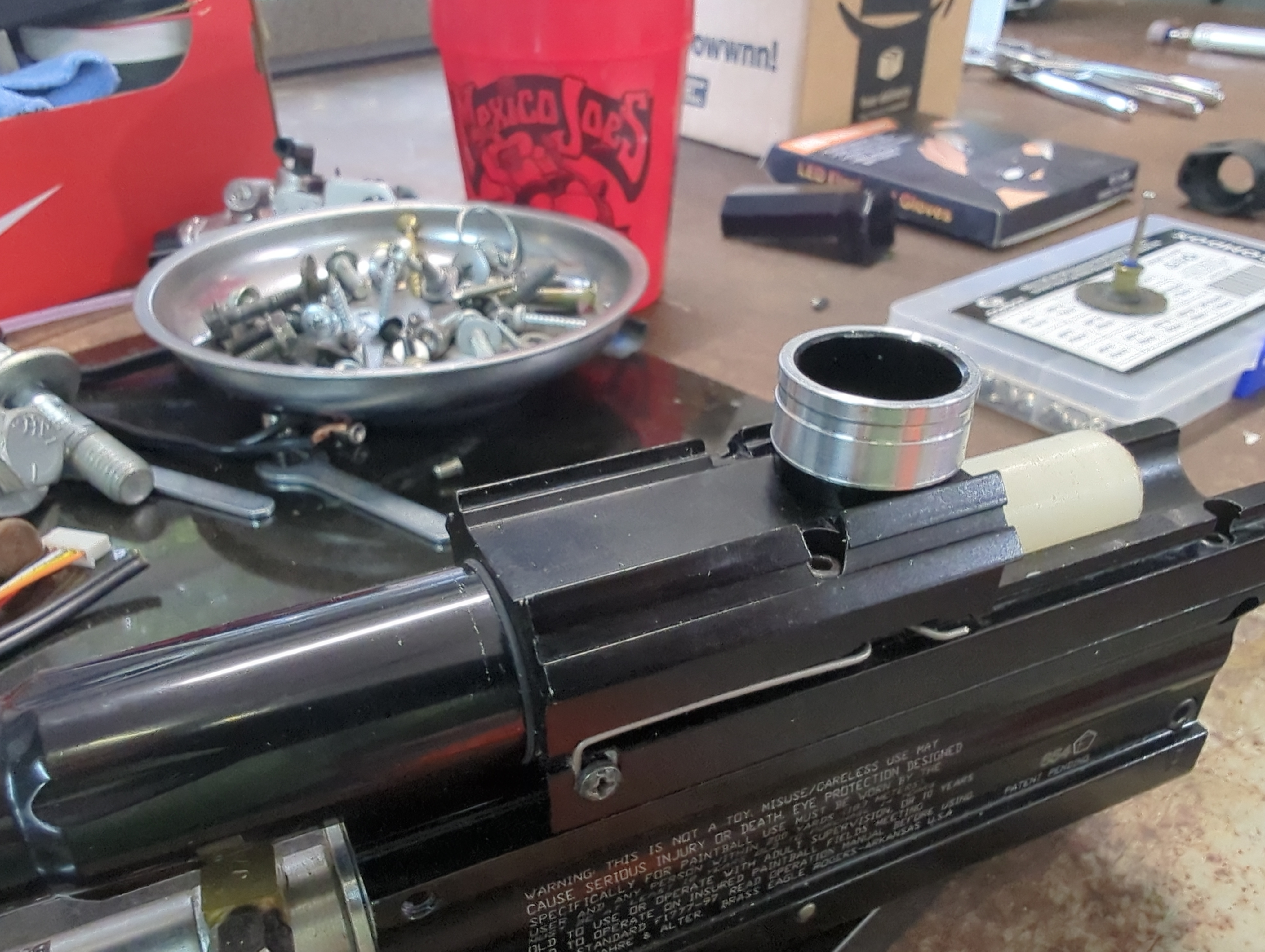

                I finally got around to putting a buck converter in the hopper, so it can provide 9v to the marker now. More importantly though, I took off the stock feedneck and machined it down for a clamp. Now I just have to put on my big boy pants and grind off those silly 3/8 dovetails!
