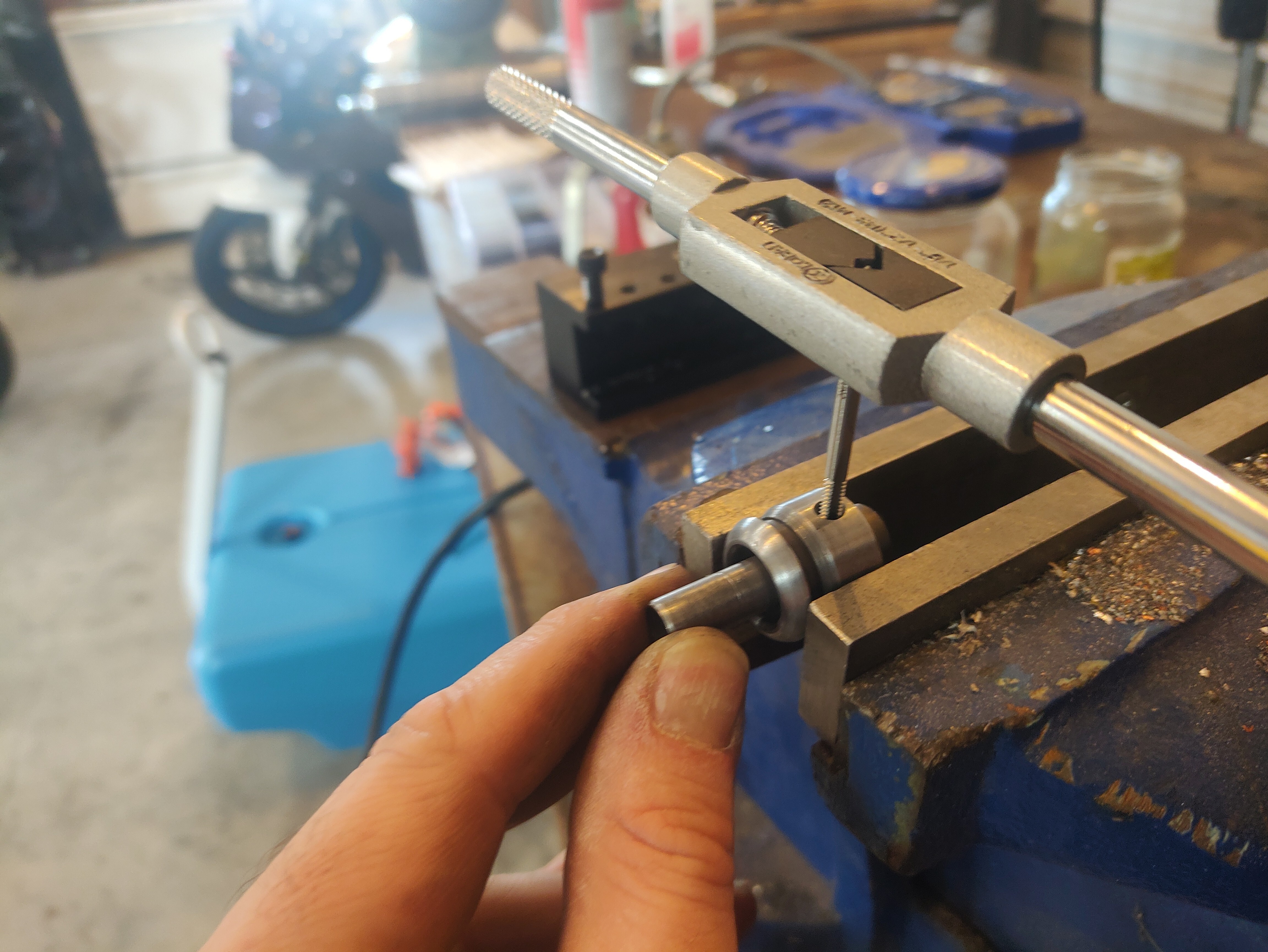

              For now, I'm CAD modeling some of the parts (3D printed bolt covers anyone?) and trying to clean up the wire "routing" while waiting for HPA, hose material, etc.
              I just pulled a nylon bolt off the printer, a little shrinkage to offset (happens to the best of us, right?)
              So of the design choices and build quality on these things is certainly "interesting". I've truly never seen a #5 fastener, #4 or #6 absolutely...
              But never a #5
                Jordan commented
                Those upper receiver bolts are something, eh?

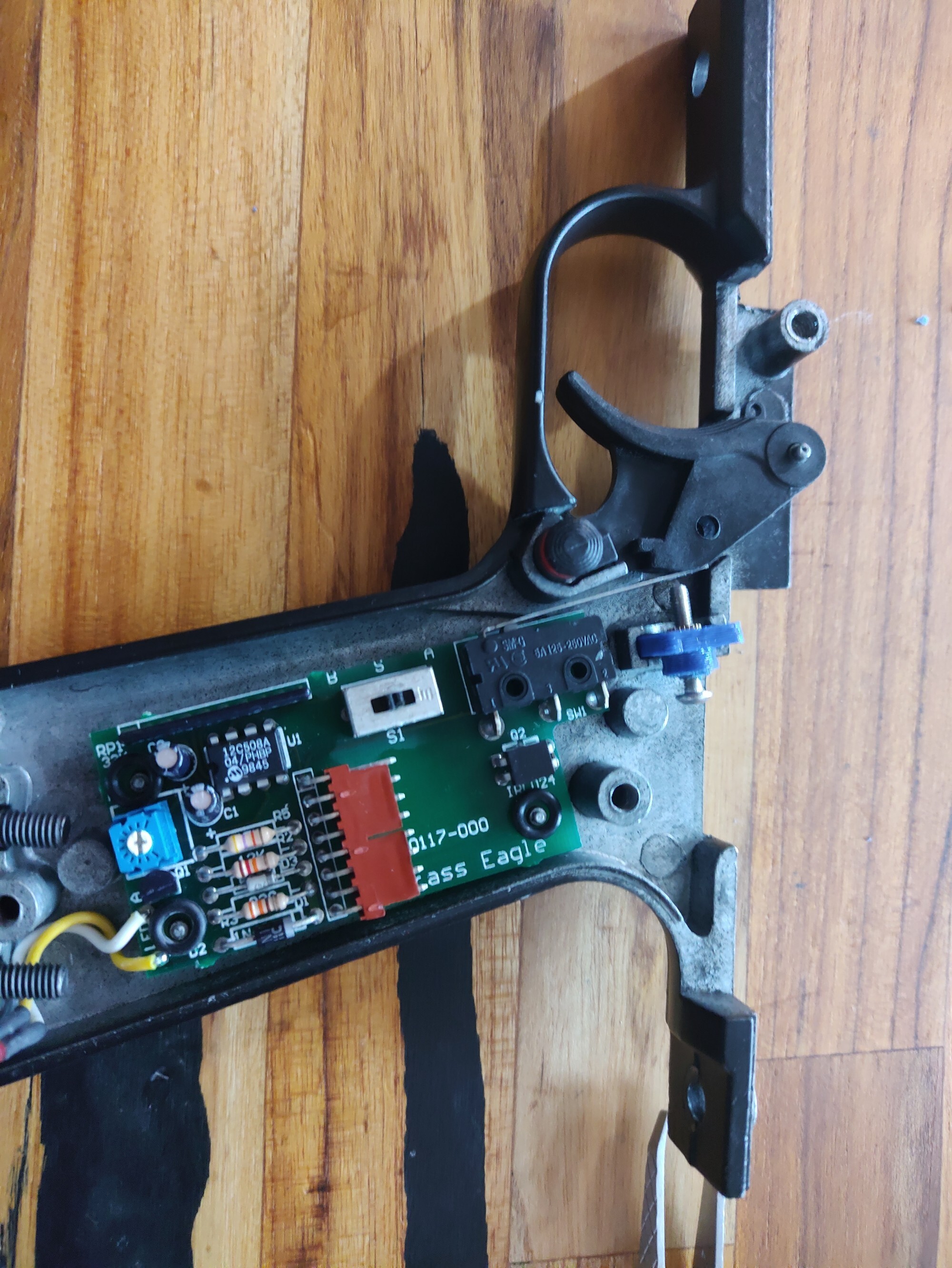

              Everything torn apart and inspected, and everything looks reasonable. But I've got a reassembly question!
              There was an extra washer not in the diagrams (large diameter) between the valve pin and spring. I assume this was to add preload to increase velocity?
              Reattaching the grip frame, there is the one screw in the back (74) and one from the LH side in the front (44)... and that's it right? I ask because (44) is too short to engage and threads and I'm assuming just had age and some preload holding it in place before.
                Jordan commented
                I'm not clear on the valvespring question, but there are only two screws holding the frame on - one 10-32 thread bolt at the back, and the front is an oddball one. IIRC it's 8-32.
                Sounds like someone was in there beforehand with some shenanigans.
            • Breakdown
              • Mar 2024
              • 37

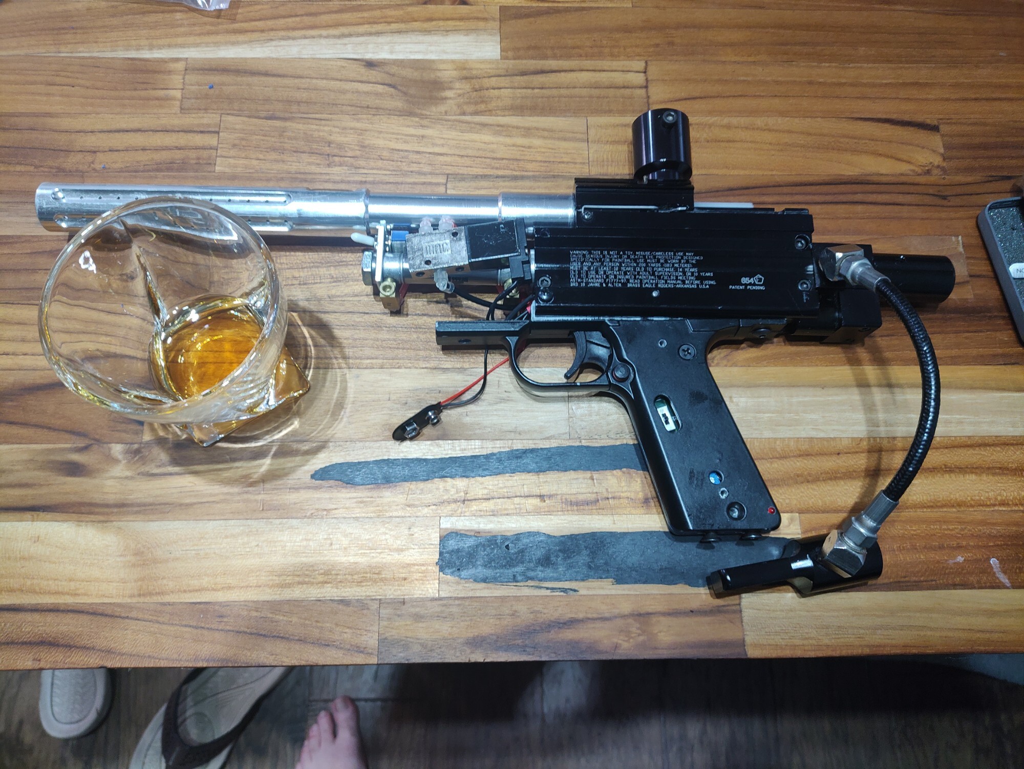

              Shenanigans or manufacturing error, there WERE no fully formed threads in the front... Since fixed! So, here's a mocked up assu ... Nylon bolt, and a trigger over travel adjustment. Leads were pulling out of the solenoid so I re-crimoed those along with a new 9V connection. I've got a solenoid mounting plan using the exhaust ports and hollowed bolts ... Time will tell!
              • Breakdown
                • Mar 2024
                • 37
                MadMart Mods are in work....

                  That circuit board is gorgeous. GORGEOUS.

                    Ok, I got the carrier and hammer mods done and I'm trying to manually cycle the ram/carrier assy to function check and am running into an issue I could use help with...
                    Out of the gun: Everything locks up great and cycles as expected.
                    In the gun, with no hammer spring: Everything locks up great and cycles as expected
                    In the gun, with hammer spring: The hammer hook won't latch onto the carrier unless I manually press the hook fwd just a hair. The ram/carrier is set at 2.23 and I've tried as long as 2.28" with no change
                    Any thoughts?
                    • TKcustoms
                      Local Azodin Guy
                      • Oct 2021
                      • 121
                      Breakdown is it air'd up when you are doing your manual check? The hammer might be depressing the valve stem.
