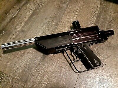

      Hello
      I was asking because I just repaired one that belongs to a kid in one of the church youth group. It was cherry. And bone stock. It just needed o rings. I had never seen one like this before. He asked me what trade for a VM would be. No idea ????

        That’s cool. There weren’t that many so to see one in near mint condition is awesome.
        If he wants to sell it, I’d buy it.

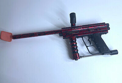

      Love that he knew it was a rare model but didn't know not to dry fire the damn thing lol
      "PLEASE DO WORK ON IT" don't worry we will XD
      <p>I know this is a rare model. I’ve seen others posted for higher. I bought this for a good price so I’d figure I’d sell it. As far as I know it works just fine. It may need some work honestly. But I pulled the hammer back & it fired. I didn’t have any CO2 hookup up. But I’d imagine it would work. *PLEASE DO WORK ON IT!!!!!* I didn’t have the time for it. Paint ball isn’t something I like to much. I sell paint balls as well. Please go through my store & find it. I’ll give you a good deal if you get it all. If you have any questions please send me a message! Thanks for looking at my listing!</p>

        Looks clean

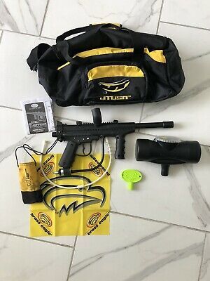

          Another one of those cool microfibers. Plus a neat yellow JT USA bag .

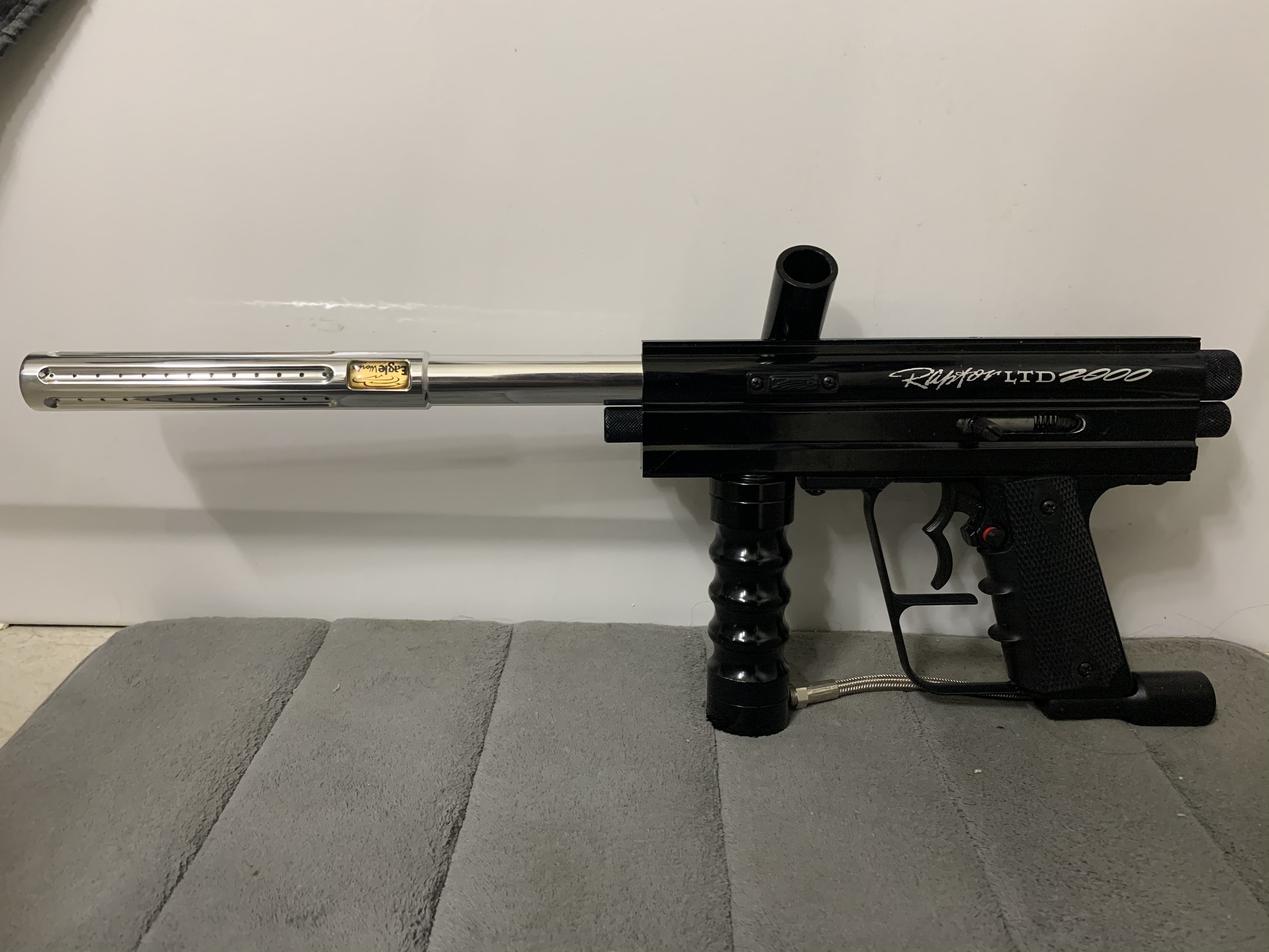

            Got the right barrel for my ltd 2000 today. Brand new
            if i wanted too. Can i just pry off and superglue the jewel back on so its not upside down?

              Yes, you can - heating up the barrel slightly may help.

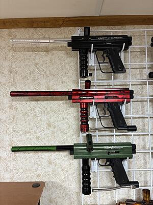

                        Resurrecting this thread because I love these crappy old guns got my favorite 3 variants on the wall

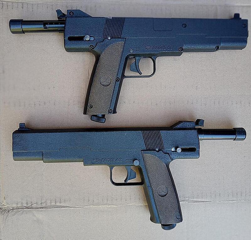

                          Used to be crappy, now just cool.
                          Matched pair of Brass Eagle “Eagle 68” pistols
                          Filled in all empty spaces inside with Epoxy Steel (lots of it), to reinforce the weak plastic bodies
                          Removed self tapping screws and used machine screws and countersunk nuts (filled in holes)
                          Sanded down body graphics (left "Eagle 68" intact)
                          Body painted light textured black
                          Painted grip panels textured tan (to look like separate wood grip panels)
                          All new o-rings, and lubed properly (Brass Eagle originally recommended transmission fluid!)
                          CO2 plug painted black
                          ~285 across the chrono
                          (Also have 12 loader tubes)​​
