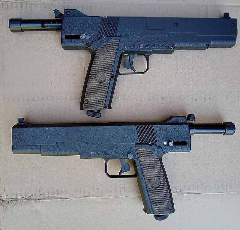

        ..somewhere in a parallel universe...
        Matched pair of Brass Eagle “Eagle 68” pistols
        Filled in all empty spaces inside with Epoxy Steel (lots of it), to reinforce the weak plastic bodies
        Removed self tapping screws and used machine screws and countersunk nuts (filled in holes)
        Sanded down body graphics (left "Eagle 68" intact)
        Body painted light textured black
        Painted grip panels textured tan (to look like separate wood grip panels)
        All new o-rings, and lubed properly (Brass Eagle originally recommended transmission fluid!)
        CO2 plug painted black
        ~285 across the chrono
        (Also have 12 loader tubes)
        Click image for larger version  Name:	eagle 68.jpg Views:	0 Size:	127.7 KB ID:	658111 ​

          Would love to get my hands on one to do the same with it....they aren't bad, just really cheaply made and can be fixed with a little work
        • Snowpuff
          Snowpuff commented
          That thing is a Beauty!

        Snowpuff....("those things"), it's a pair.

          • 4332
          Anyone have a photo of these apart?
          I have been curious about these but wondered if I could machine a new shell
          • dartamon
            • 396
            I'm thinking of casting a brass shell instead.
              I think I have some pics of when the above pair were rebuilt, on an old Hard Drive, I will look later tonght and post if I find them.
              I might even have a left half body, if I can find it...
