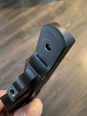

      Regarding the RTR frame, the material that gets removed is just in front of those shiny flat head screws. Not sure how many moving parts are inside.

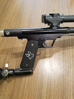

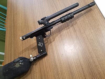

    I do agile project management, so I test in individually viable phases... this is phase 1. Hand tools only, and some careful jig building.

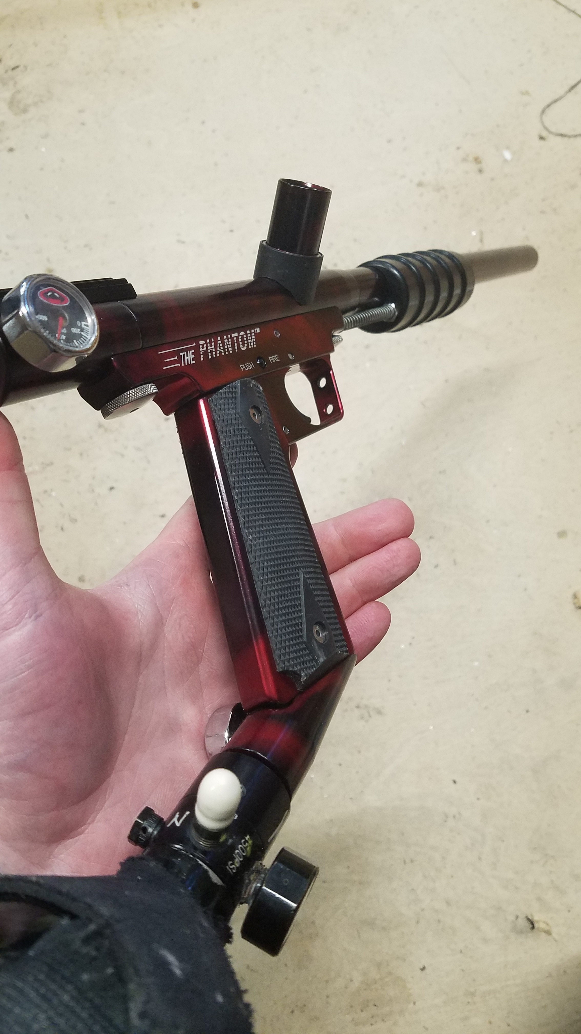

        So, as an owner for a gas th grip Phantom, hopefully I can add something to the discussion/design. I have been waiting until I had enough time to properly contribute…but if I wait until I came do a complete “mind vomit”, Nate will be on version 5 already! So I will add to this post as I add ideas, pictures, links, etc.
        Ok, so gas through grip (and gas IN grip) has been a mini obsession of mine for a couple of years.
        About six months ago I was able to buy a very well done Phantom from someone on FB. Some pictures of how he does the mod are here:
        https://1drv.ms/f/s!AiObFv7jMo4HhMU_MKoQRyY5mu6bSQ
        Mine is the gunmetal grey one.
        Anyway, this is the most common way I have seen the mod done. Fairly easy and straightforward. Nate, I think you have already past this step, but if you need any dimensions just let me know.
        Downsides to this micro line gas through design is having to remove one grip panel to access the microline fitting to release the tube to remove the valve. Seems like a small thing, but is not ideal.
        Others that have done the mod have moved the placement of the valve micro fitting rearward just a bit so the hole in the trigger frame/grip breaks through the back and exposes the fitting so a fingernail or other flat object can depress the fitting insert to release the micro tube. Here are some of the Super Stanchy SSC gas through Phantoms showing an exposed fitting:

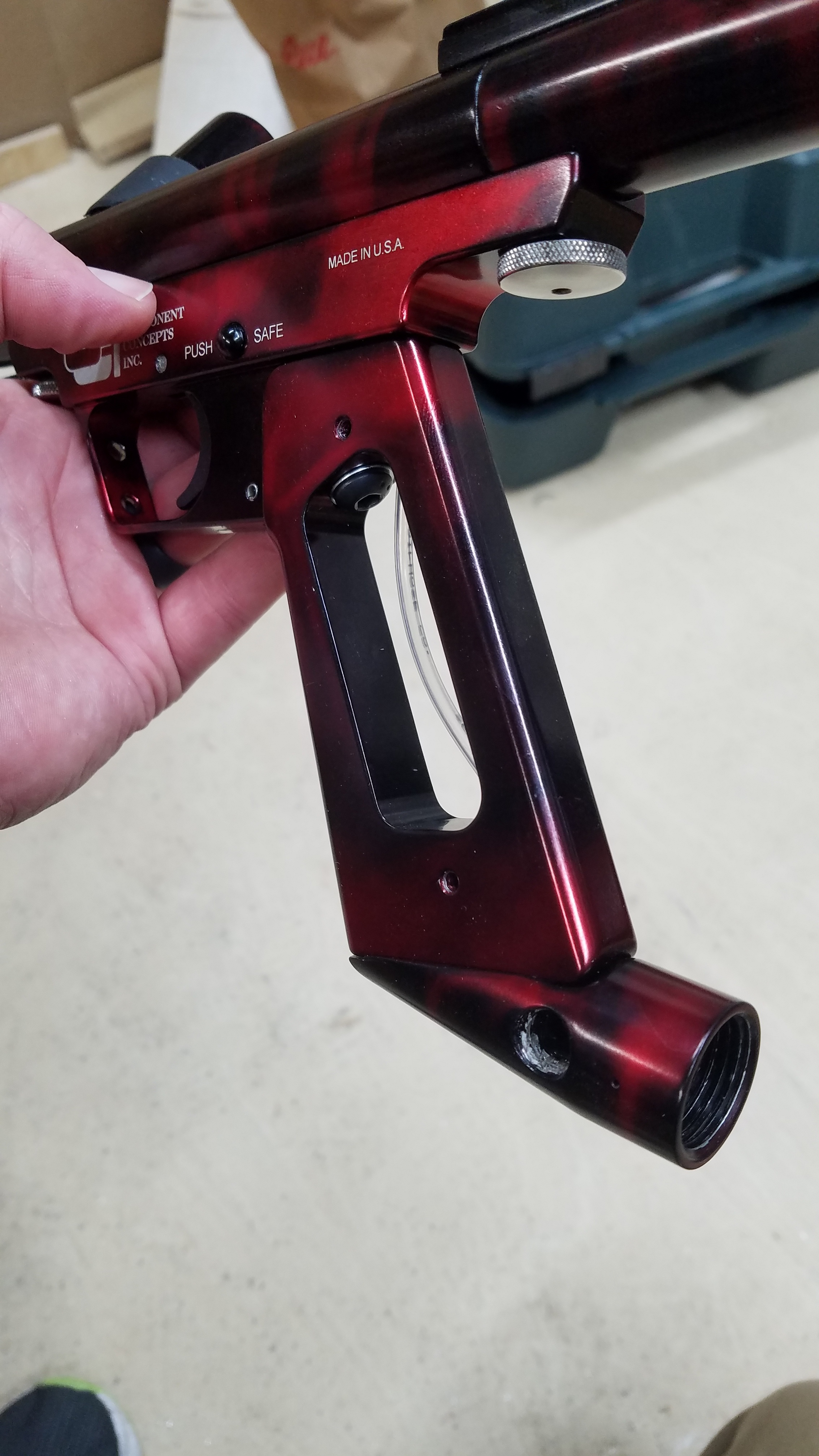

          in the meantime, enjoy some photos of Phantom (and other) in grip designs to spur some creativity. We really NEED a 12 gram in grip Phantom option!

            C E D, that would be great! I would love for someone to provide some good photos of the frame to valve air transfer for the DSP and the Retro 7 (and any other gas in/through Nelsons that are out there to see if we can consolidate the good features into a new design.
            Definitely, I got to replace my piercing pin anyway so I will snap some pictures when I pull it apart. The grip frame is a bit thicker to house the 12 g in grip I can take measurements to. DSP puts it in the back strap, Carter’s is built right into the middle of the frame. They seem to tap into the valve similar.
