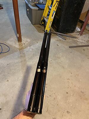

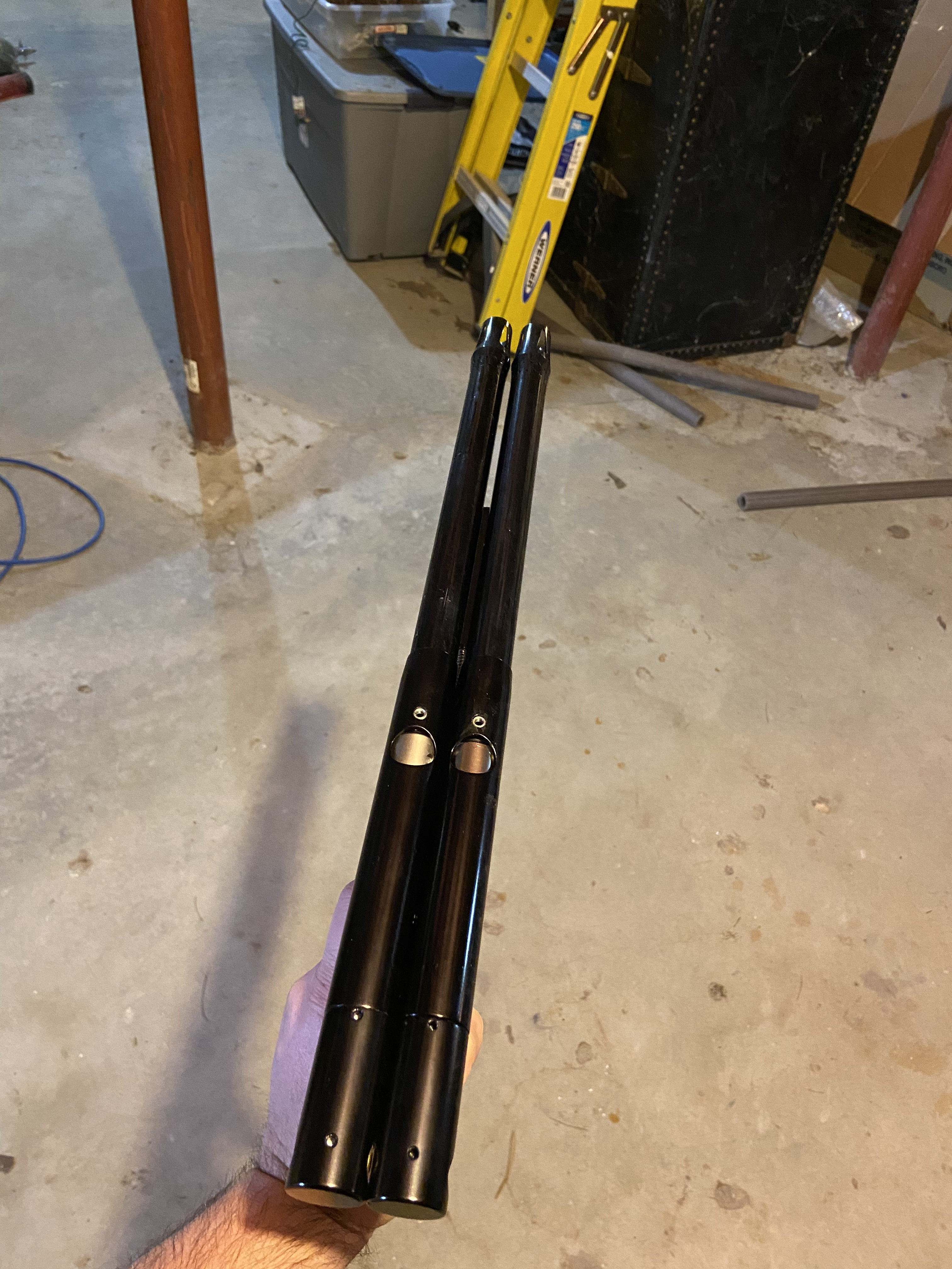

    Almost there.
    She’s getting closer…. Click image for larger version

    Great to see it coming along.
    What are you thinking for feeds?
    • A.Greenleaf
      A.Greenleaf commented
      I would like to get a quadpheed. It may take a while though.

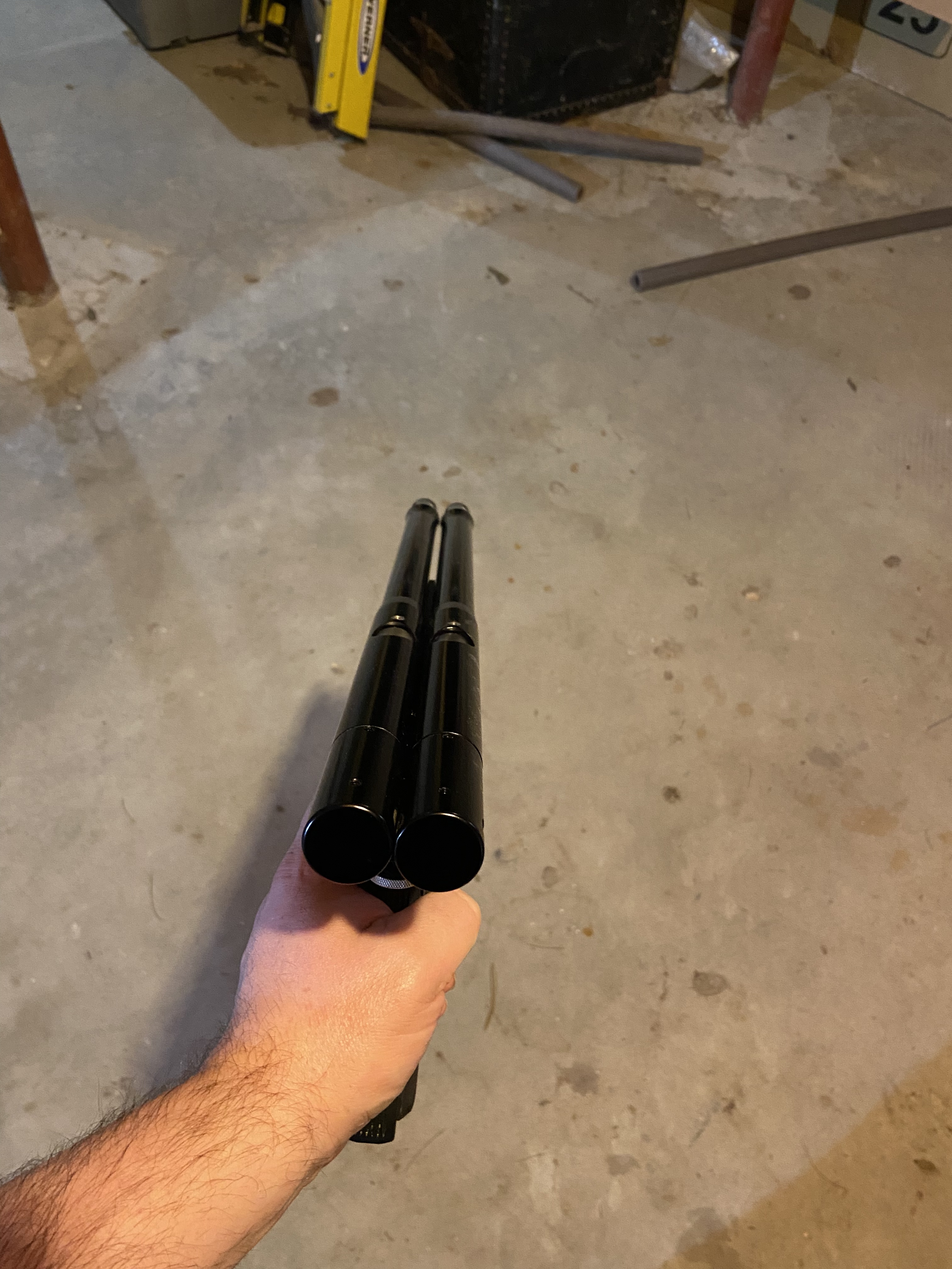

    Dual Frantoms!?
    • A.Greenleaf
      Sure is. I have a soft spot for the white wolf Frantom design.

    Looks done to me, single shot doubles for the win!

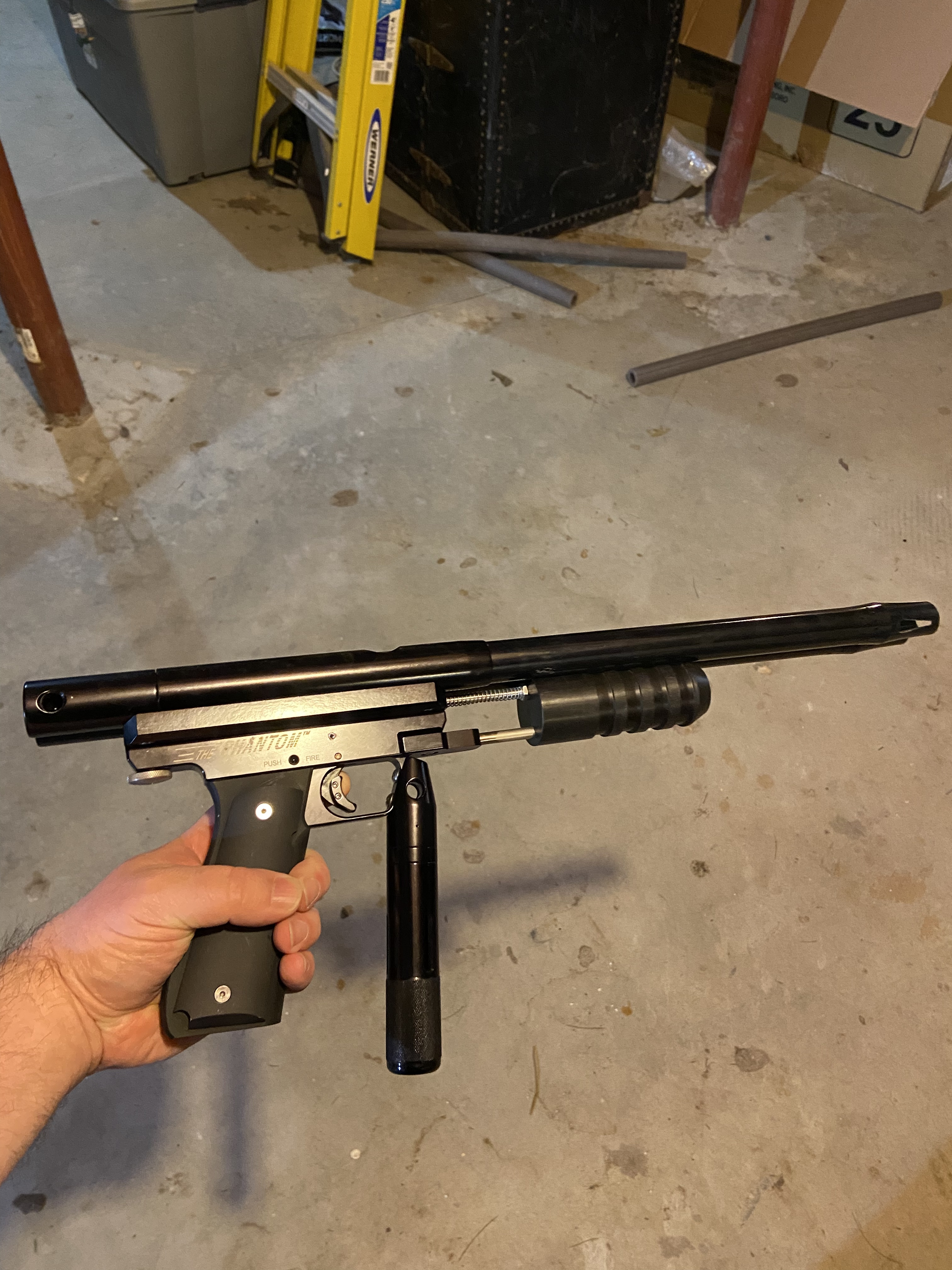

      The hardest part was getting the courage to cut up one of my phantom stockclass bodies.

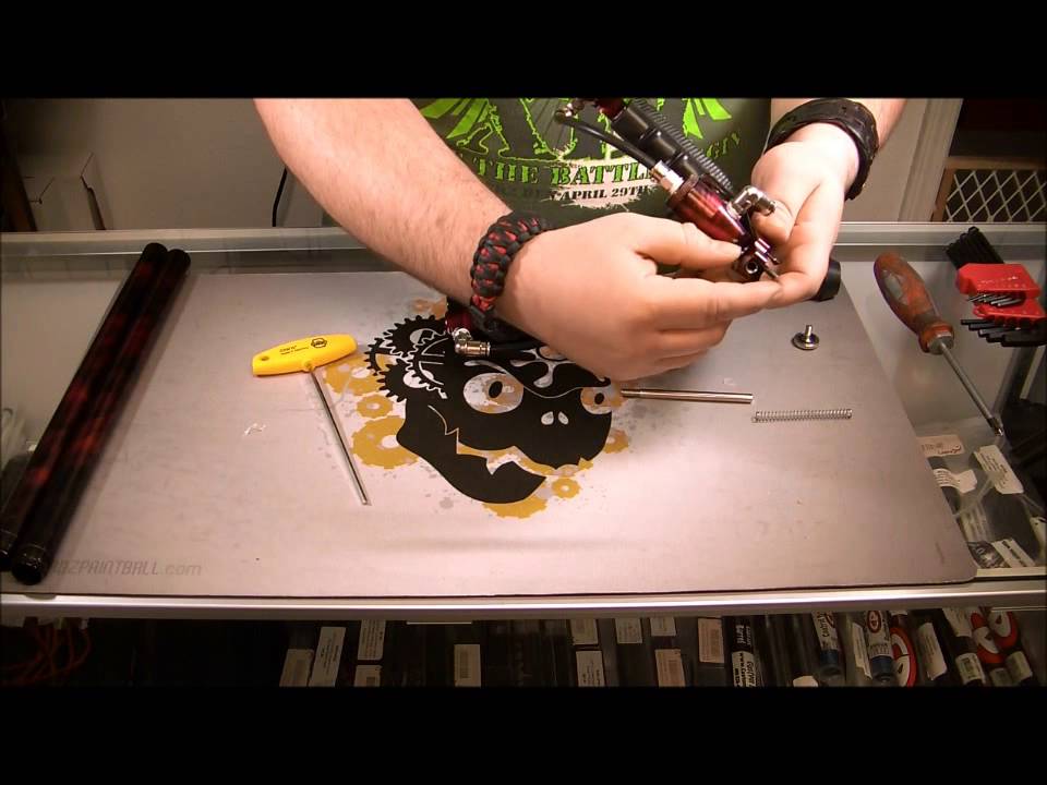

        How does one go about “dualing” a phantom? (not to be confused with dueling a phantom)
        I think I understand most of the concept, it’s the trigger, pump and the “sled” for the dual bodies that get me…..and now the “cut up one of my phantom stockclass bodies” comment.

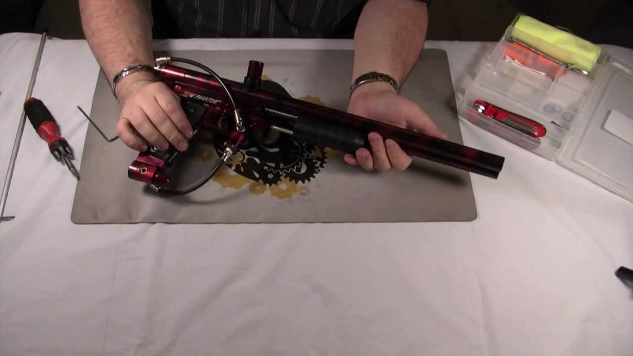

        Here are the two Videos from Gearheadz Paintball showing the "Phoenix Kit" that A.Greenleaf has.
        The "cut" that has to be made is to basically mirror the pump rod slot on the other side of the hammer sear slot. The kits included a modified body, but if you later want a different feed layout, then you have to get an additional body and mod it. Some people do it themselves, some have a machinist do it. I had Have Blue at Air Soldier Products do mine when I needed more.
        KPCS Ken also did a run of "Ditto Deuce" double barrel Phantoms that used a custom milled trigger frame and tray, and had the inside (facing) part of the bodys milled for the pump slot.
