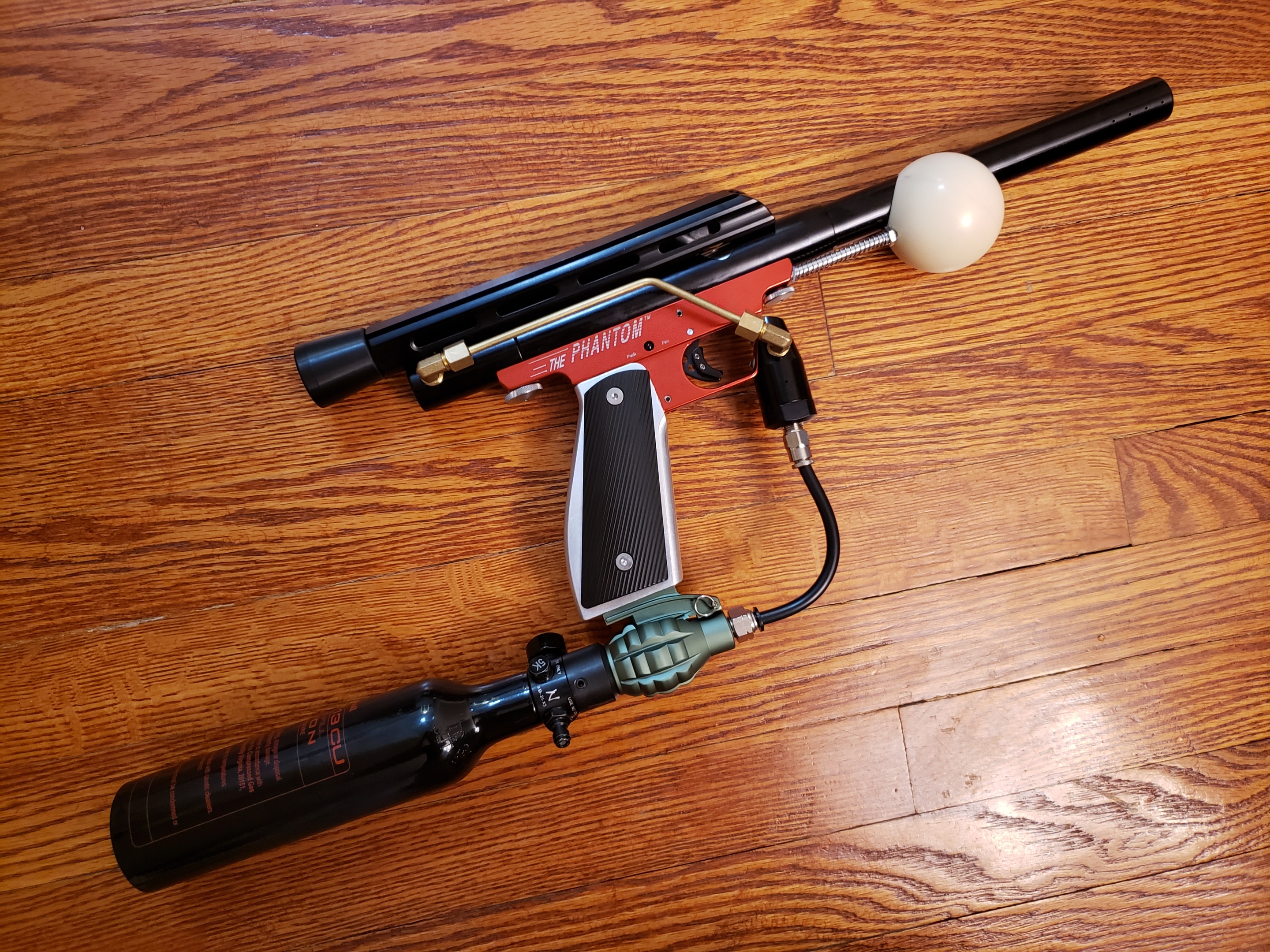

    So im just about done gathering parts and mocking up. About to tear it down to get the frame anodized and ASP detents done.
    Here's my build:
    - CCI / EV body, stock class, right offset
    - Cue ball pump
    - 8" freak bored barrel (factory bored)
    - Sergi Humpback frame w/ CCM delrin grips
    - Mongo 12-round feed
    - Rocker Paintball roller trigger
    - Redz ASA (on the fence, doesn't fit the clean lines of the rest of the build)
    - Ninja 13/3000 (will be replaced with an ICD lever-changer once back in stock)
    Debating between the cue ball and the mini clear acrylic handle I have. Both feel really good and look great in their own ways.
    First Phantom I've owned, and absolutely love working on it. Can't wait for the weather to get nicer and hit the fields.

    I would go with a different ASA. Especially if I was spending the cash to have it all anodized. I would get a stock and Bucket changer and have it all done at the same time. Even if you don’t plan on using it that way. It’s going to add a lot of value especially with a nice custom Ano job.
    Really nice build tho what Ano and pattern you thinking of going. You should do the tank to match.
    • BlindFaith429
      BlindFaith429 commented
      I have a CCI / EV bucket changer, could throw that on as well.
      Was only going to have the grip frame anodized for now, not the whole build.
      If I was going to do the whole build, it would be a toss up between a cotton candy theme, or a classic fade like the old-school ACs had (tequila sunrise for example).
      I would go gloss black on the frame then.
      Those fades were awesome. That would look great on a phantom.

    Thanks for all the comments. For now, ill be running the 13/3000 until the ICDs come back in stock. Regardless, there will be a bottom-line ASA so I can go back and forth.
    Getting use to the 10 round sticks will take some adjustment, so I'll probably just try those first lol.
    As of right now, the body is out at ASP, and the grip frame is at ARC.

    That Cue Ball looks nice on there! I don’t think I ever even mounted it on one of my Phantoms…
    Anyway, the Grenade ASA looks fine if you are going for a “Bombastic” build, but I have two ASA suggestions that I really like.
    If you are ok with no on/off, and the grip frame is tall enough for your hand that it won’t be cramped with a close set tank reg, then I highly recommend a low profile “XSV” style front outlet ASA. MasterSconi makes a nice version (and super cheap at $15). The straight back, tight setup is perfect for me on my Ditto Deuce, with its rather tall “Humpback” grip. I don’t really have to worry about any interference with my grip from the tank gauge, fill nipple, or burst disks. It would probably feel cramped with average size hands in a CCM 86 Phantom grip and FS short regulator combo though.
    https://mastersconi.com/product/prof...ll-dust-black/
    For a On/off ASA…I am a huge fan of the Bob Long Cam Drive dovetail ASA. At the tank pressures you have for a Phantom, it is MUCH easier to actuate than a PE POPs for example (and I just think it looks better).
    Here is the Sconi “XSV” ASA on my Ditto Deuce, and the Cam drive in my Phoenix.
