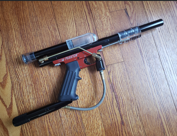

    Gas through with an M16 grip is less easy; the common solutions are to run straight down like a "thumbhole" stock, or to use a 12" hose that loops forward a long ways like you frequently see on mags.
    If you want to go gas through grip, a .45 block is the best first step, then figuring out what's important to you - field stripping typically becomes complicated but some people have handled it better than others.

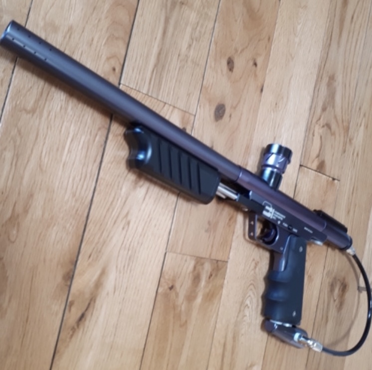

      Another option would be to get a vertical adapter setup. But instead of the bucket changer, just run the airline to the vertical adapter. That would get your airline out of the way. you don't necessarily need the VSC valve body with the hard line kit. You can use macroline, microcline or braided line and appropriate fittings to the vertical adapter from the back bottle valve you have. Its not the prettiest, but it would totally be functional and get your airline out of the way for switching hands during a game.

        Check out the Phantom Show off pages there are some good examples of what your options are. There are lots of them. Easiest would be just an ASA plug a straight fitting and a 90* with some standard line. This is best used for HPA if you plan on running 12g or Co2 I recommend using braided hose instead.
          • 6380
          You could get a VSC valve body and loop it forward directly to the ASA or use the same Asa plug and go off the Vert Asa.

            regular VSC body with a loop of stainless line is my prefered way, but straight from the back bottle down to the ASA works great too.
