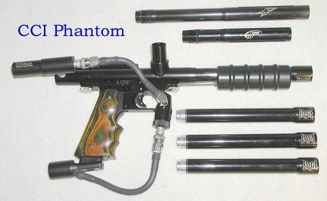

                    • Walker
                      • 1530
                      • WA State
                      If I were going to run a Stabe on a Phantom, I would run a bottomline female, or the valve body integrated...
                      Walker
                      One I owned, 16 years ago....
                      Walkers Current Feedback
                        See the side reg probably works on this with the right feed body because you already are aiming over the top with the right feed setup. So it’s not really getting in the way.

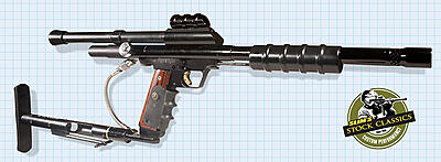

                    • Slim
                      Stock Classy
                      • 300
                      Here's a shot from about 10 years ago of one of my older Phantoms. As you can see, the PPS Phantom stab provides a nice, clean look, doesn't throw off the balance of the gun and also provides an easy view of your ballpark pressure...
                      • Cunha
                        • 2027
                        Female stab is the most out of the way by far.
