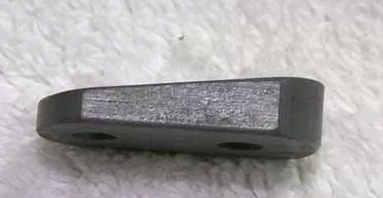

    Hi all, not new to the game, but have been out for about 8 years and wanting to get back into it, and so much has changed. I'm wanting to get rid of the angle on my 45 grip phantom so that the stock or tank is a 90 degree or as parallel with the barrel as possible, no angle. Can that be accomplished with a drop forward or do I need some sort of mounting block?

    There is a mounting block to accomplish this, basically a spacer.
    Pretty sure this can also be accomplished using the basic ASA from CCI. It has the proper angle.

    Apoc4lypse used to 3D print a nice wedge to get the stock parallel with the barrel. He's back now, but his website is no longer. He's got a new thread. Reach out to him: https://www.mcarterbrown.com/forum/p...-as-we-know-it

    FYI, this is the wedge like device that was mentioned - https://baccipaintball.com/mis680.html - This is the wedge to remove the 15 degree angle. This one looks like plastic, I used to have an aluminum one years ago (long gone).

            Looking for a wedge/block. Anyone making them these days?
